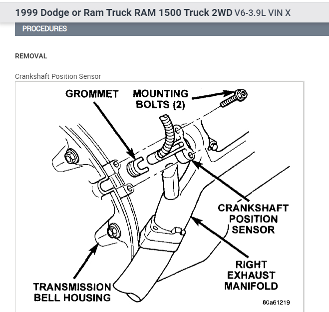

Truck will start and drive good for a while until engine is at normal temperature, but if you stop at a location and cut truck off go in and come back to truck it want catch the engine, ignition is working but keep rolling to start engine, but it usually takes an hour to two hours before engine will crank and that is the same process over and over I have been experiencing.

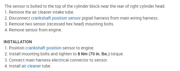

What you described sounds like a faulty crankshaft position sensor. When they start to fail, heat adversely affects them preventing the ignition spark to the plugs. Once the sensor has a chance to cool, it can work again.
Take a look through this link and let me know if you see things that mirror what you experience:
Here is what I suggest: If you feel this could be the issue, when it won't start, check to see if there is spark to the plugs.
Here is a link that explains how it's done:
https://www.2carpros.com/articles/how-to-check-for-ignition-spark
If there is no spark, suspect the crankshaft position sensor is faulty.
I attached the directions below for replacing this part.
Thursday, November 10th, 2022 AT 9:02 PM
