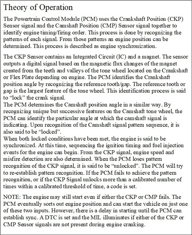

To get back to the original problem, Steve will handle this better, but I can offer a couple of observations for you to mull over. If you're seeing too much unburned fuel leaving the tailpipe, there's two causes to start with. One is too much fuel is being sprayed by the injectors. The other is it's the right amount of fuel, but it's not being ignited. The injectors are pulsed open and closed by the Engine Computer. On most engines, fuel pressure is not monitored but it is carefully controlled by a fuel pressure regulator. That makes pressure a variable that is programmed into the software, so the computer knows it. Based on all the other sensor readings, the computer calculates how many milliseconds to hold the injectors open. When closed, an injector can leak, but that will be too slowly to show up while the engine is running. When the engine is stopped, that fuel pressure should hold for days or weeks. With a very small leak from an injector, pressure will bleed off within a few minutes. Most of the time the only complaint is a long crank time because pressure has to build back up before the engine will start. With what you're describing, the better suspect would be an injector control wire shorted to ground. That would hold the injector open constantly, and that would allow way too much fuel to enter one cylinder.
We also have to look at the ignition system. Most engines use a camshaft position sensor and a crankshaft position sensor. They develop voltage pulses. The actual voltage isn't important. The computer looks at when the pulse goes up or when it goes down to know precisely when to fire an injector and a spark plug. Some engines will start and run with one failed sensor. Some will run until stopped, then they won't restart. Others, especially older engines will stall if either one sensor fails. Some of these sensors have electronics built in, so all kinds of unusual problems can occur. We even used to hear stories of a cracked magnet inside a crankshaft position sensor that caused it to develop multiple and erratic signal pulses, and that resulted in the computer firing the injectors too many times. Spark timing would be wrong too.

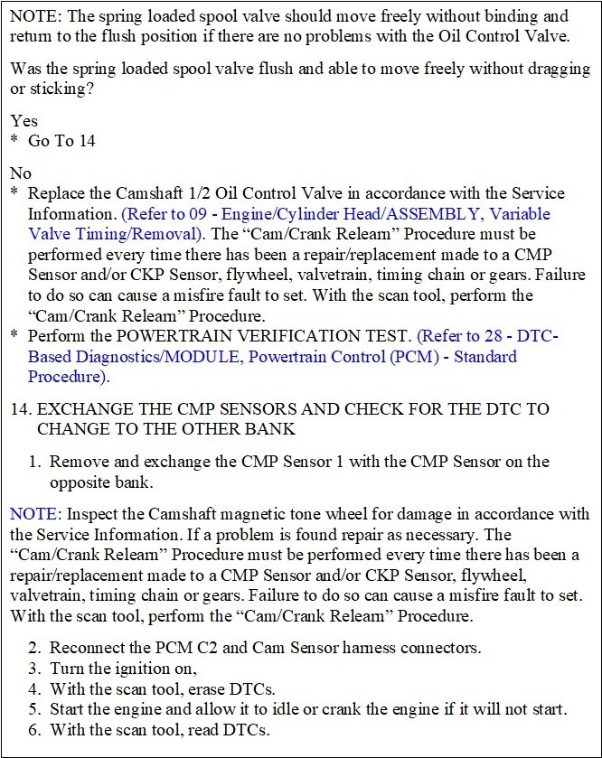

Feb 2, 2024 at 12:59 PM

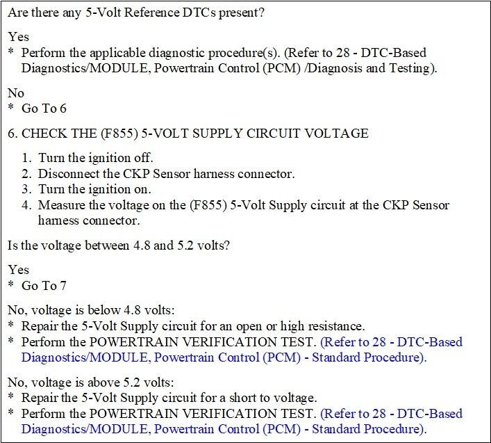

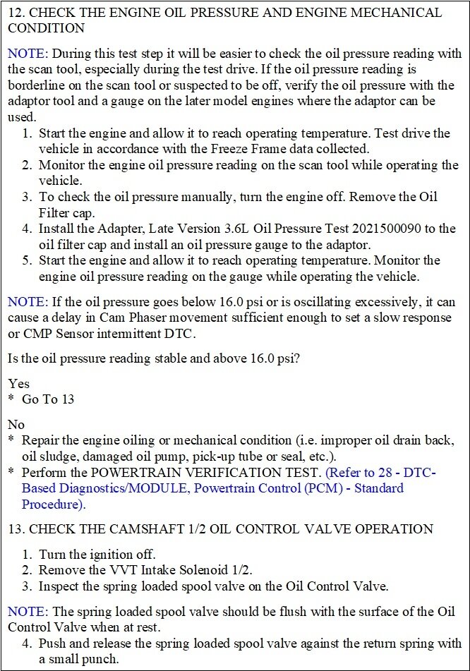

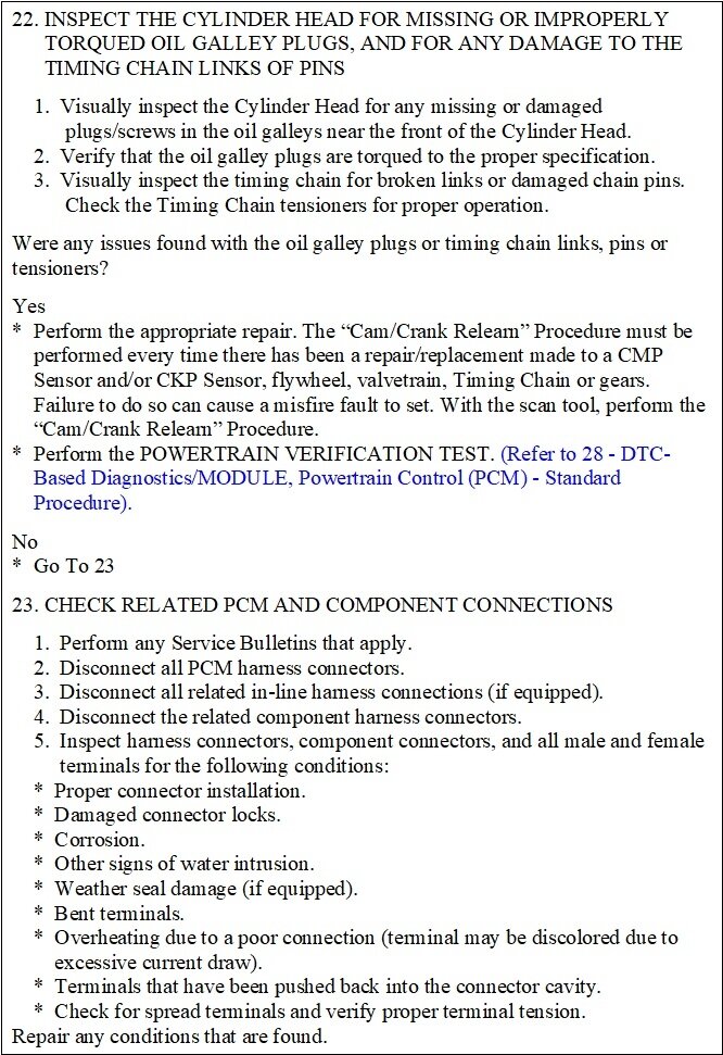

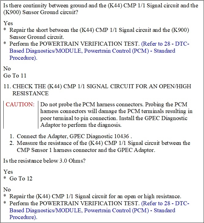

As Doc says, most of us have day jobs. Technically I'm "retired" Sold my main shop and was only doing friends and family. But as a man once said, "Just when I thought I was out, they drag me back in!" So now I'm doing diagnostic work for one dealer who owns 18 different franchises and another one who owns 6. So much for retirement...

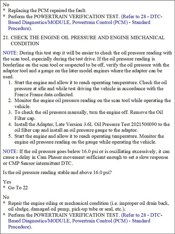

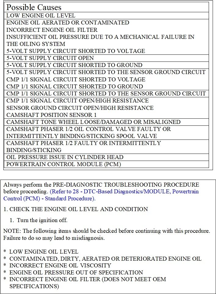

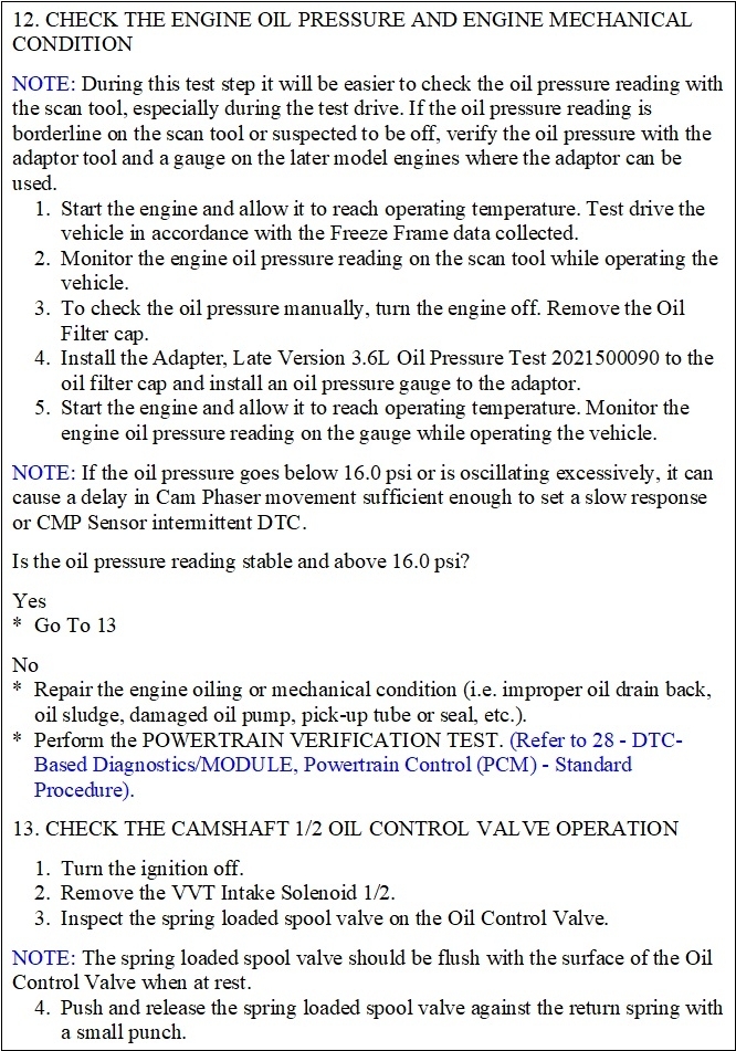

What did you fill the tank up with last? While the 3.6 is set up as a flex fuel in many applications there are some that are not. I was digging through the images from your scan tool looking for fuel trims and see if they were erased from clearing the codes and noticed the attached. If this is a flex fuel (usually has a tag on the rear gate if it is) and it's reading 0% ethanol but the PCM thinks you have an ethanol blend it will add extra fuel to compensate for the ethanol content, however if the fuel is actually non-ethanol or a 10% blend that extra fuel could be why it won't start and run. The PCM is actually flooding the cylinders. Try this quick test, hold the pedal on the floor, keep it there and try to start it, holding the pedal down fully will put it into clear flood mode. If it turns over a bit and then starts up, you have extra fuel to deal with. Then it becomes an issue of whether it is ignition timing that is off, and it just isn't firing at the correct time, or the PCM is adding extra fuel and drowning it out.
If you don't have service info both Mitchell and Alldata have DIY portals and you can get the same information on a single vehicle as the shops use. Both have sections that explain how the systems on your vehicle operate.

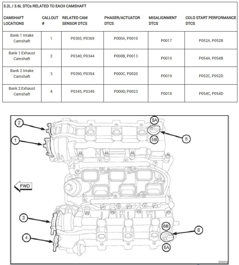

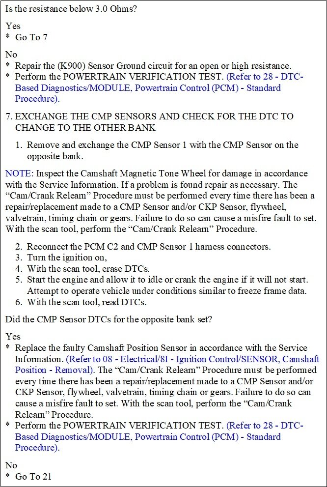

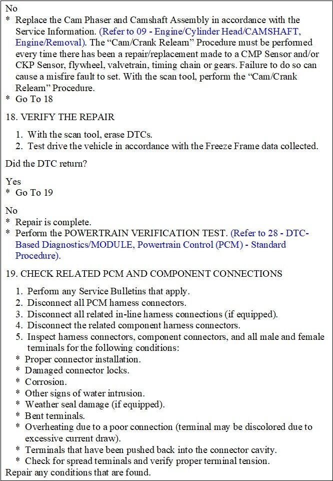

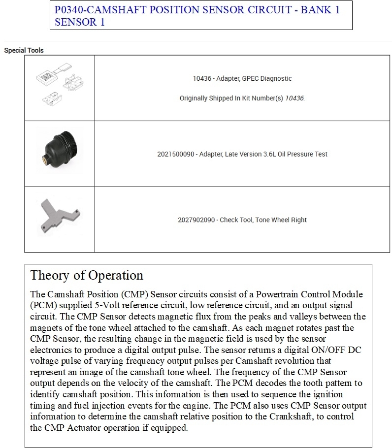

The issue here is that the cam codes and the erratic reference voltage point more to the wiring or an internal PCM issue over a real mechanical problem. The vehicle acting flooded could easily be because of a combination of timing being off from the data the cam and crank sensors are sending the PCM and the PCM adding extra fuel if it thinks you are using an ethanol blend.
Prior to these codes was it running good without an issue and then it threw the codes and doesn't run?

To answer your question Steve, "Prior to these codes was it running good without an issue and then it threw the codes and doesn't run?". It's been so long since it ran I've almost forgotten, just kidding.
No, I believe these codes were thrown once and cleared. Then it made it to my driveway, and I tried to start it and it was no longer starting. Note: It is very possible, this was the day of a snowfall here in upstate NY and my summer tires were not getting me up the hill very well. Causing me to abuse the **** (crap) out of the engine to get up the hill. Although it made it home and in my driveway I think that was the last time I drove it. The last time it ran was approximately a month ago now. Although previous to all this I did notice A small amount of unusual white smoke coming out of the exhaust, enough for me to have a little concern. Also, I did try to hold the pedal to the floor and start it. That seemed to have the best result to almost getting it to run but would quit in a couple of seconds if I held it there. It would continue trying to start if I let off and feathered the gas. But at no time did it start up and run. Also, I do not run 85% ethanol from my local gas station. But my scanner says I do... I've noticed this scanner digs very deep into a lot of areas that in question, Such as fuel injector status. I will try to learn more about this Innova 5610, I'm not thrilled with it.

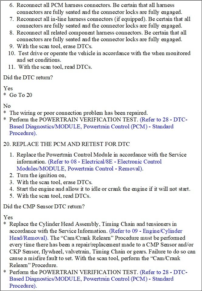

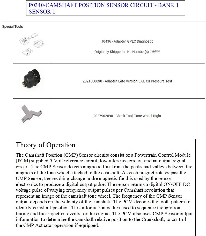

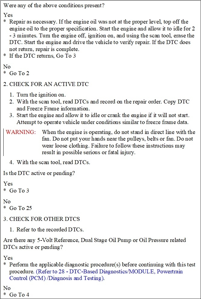

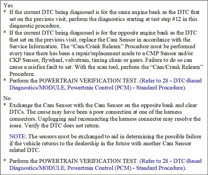

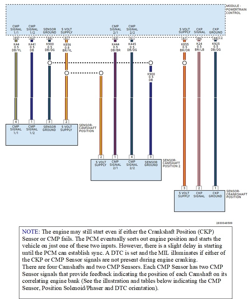

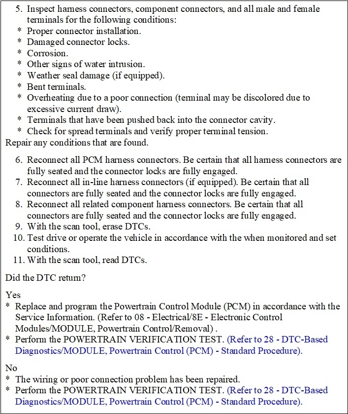

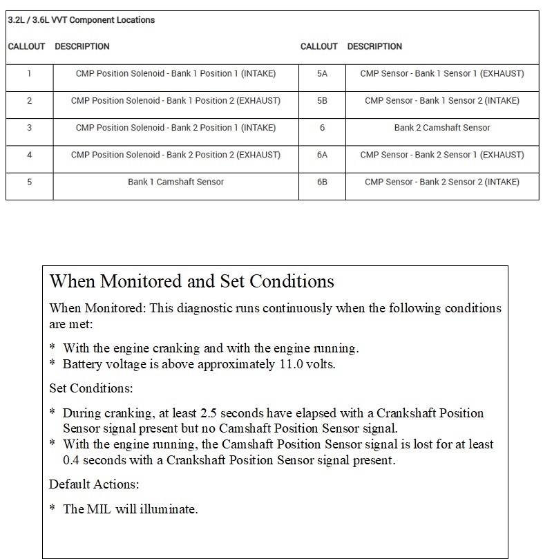

Thank you Steve, new development!!! I had it running! It ran on its own for at least 5 minutes, Blowing out white smoke like crazy. After 5 minutes or so, it started to act like it wanted to stall, until I stepped on the gas approximately 25%. It continued to run (with white smoke) only a little rougher. It ran this way until I turned the key off. It was long enough to clear the permanent codes! But five of the seven came back. I have a new report from the Innova 5610 showing some of this new data. I will include it now.

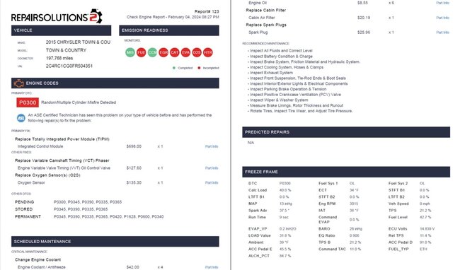

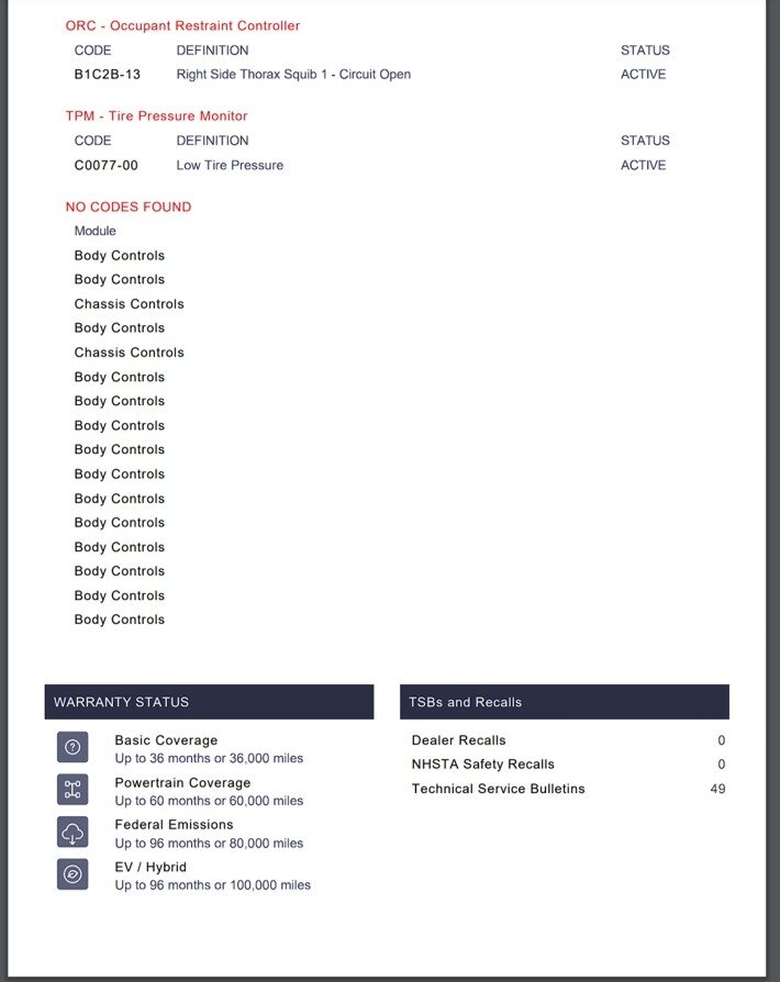

Feb 4, 2024 at 2:18 PM

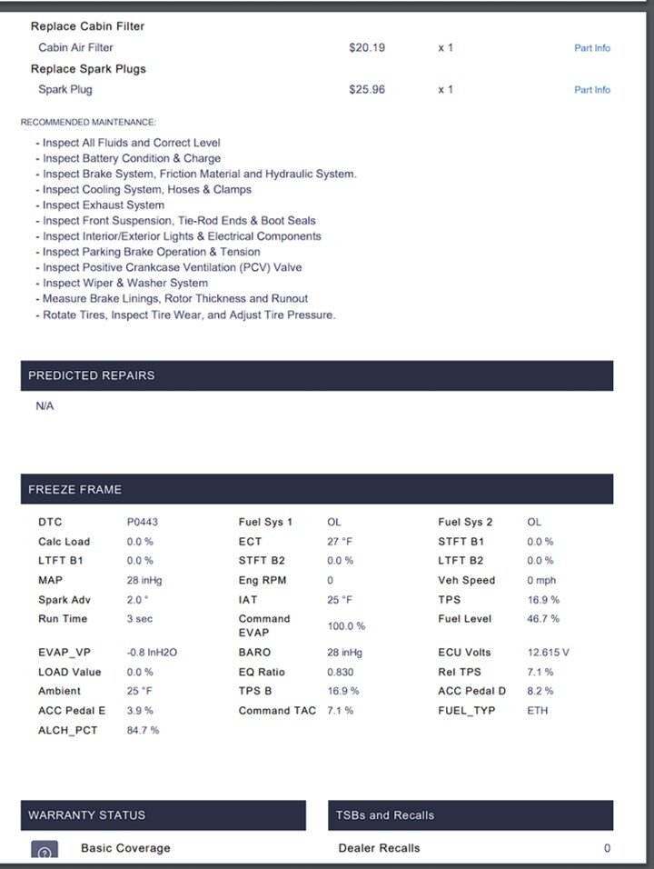

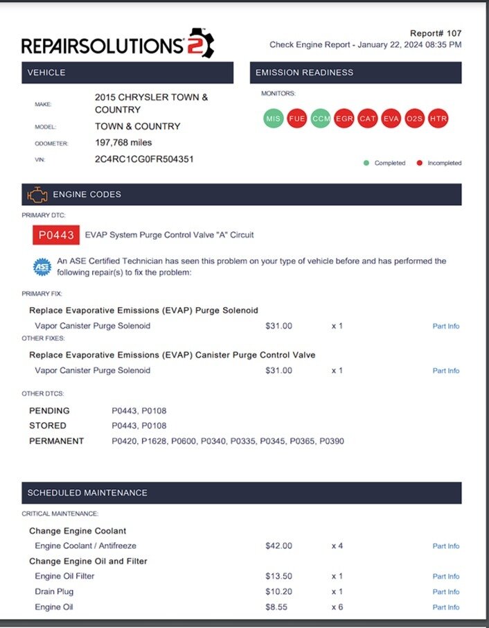

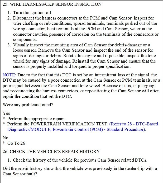

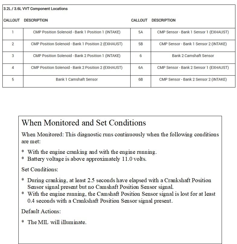

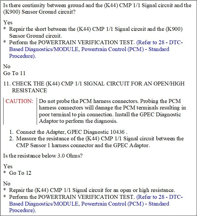

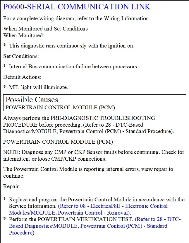

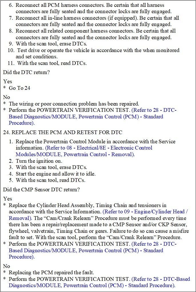

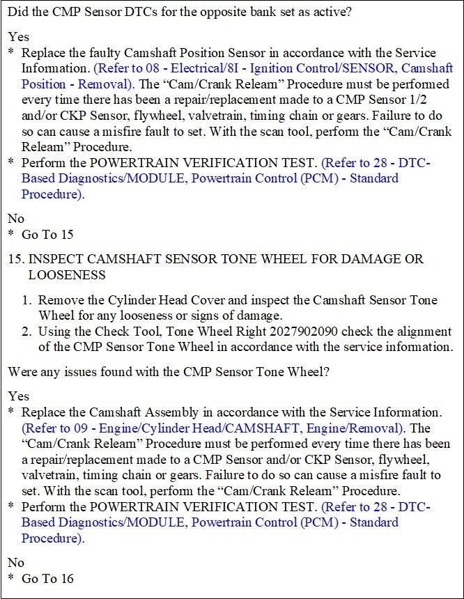

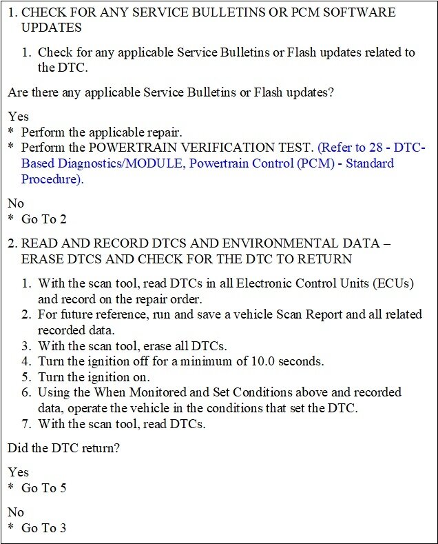

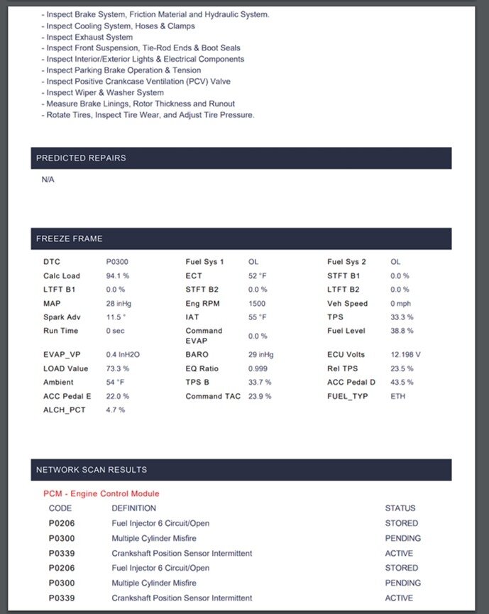

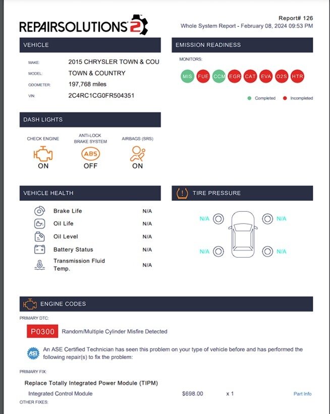

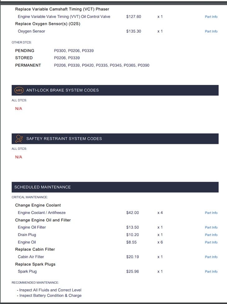

You shall notice in this report the five wiring codes came back, plus other. This report recommends changing oxygen sensors, which I can easily. But I'll wait for your recommendation. I'm not at all against changing all plugs and Packs, it's cheap easy and needed. But I'm not sure about the "Recommended fixes" and changing the VVT oil control valve. I am so glad it ran on its own for a few minutes. White smoke and stunk like a Skunk.
Feb 4, 2024 at 2:25 PM
Yeah, I wouldn't rush into those "fixes". Most of the time those are the same things the parts store is going to sell you for parts. Many times they don't actually track parts sold = actual repair. So, you have a random multiple misfire (P0300), they sell you a set of plugs, except they rarely fail in groups! Same with coils. However, it goes on the books that "we sold X number of sets of plugs to fix a P0300 code", so that is a possible fix that pops up.
Remember it hasn't run for a while and you have been trying to start it. Every attempt dumps fuel into the exhaust and that is going to take a bit to clean out. It's also likely the P0300 is from that and the cam codes. The cam sensor circuit codes returning that way though isn't a good sign for the ECM. You tested that they have ground, they have power, but the ECM still doesn't see them. Makes me think that there is corrosion or a failure inside it. Unfortunately, there isn't a great way to find that for a DIYer and they are not plug and play. However, you could check the powers and grounds to the PCM. If they all check out and the sensor wiring all checks out, but you still get errors, there isn't much left.
The TIPM is doubtful as a problem as the engine will run and the sensors are not powered from it directly.

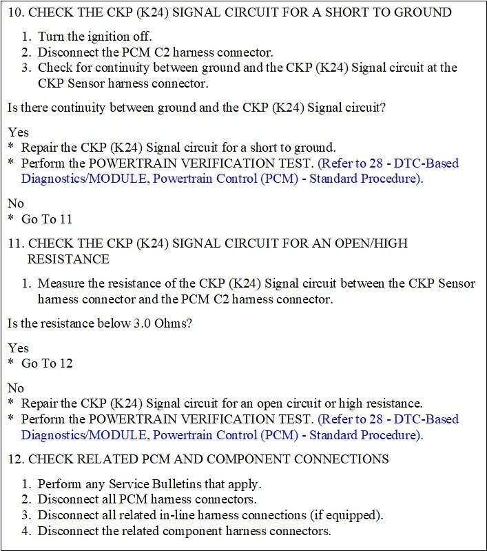

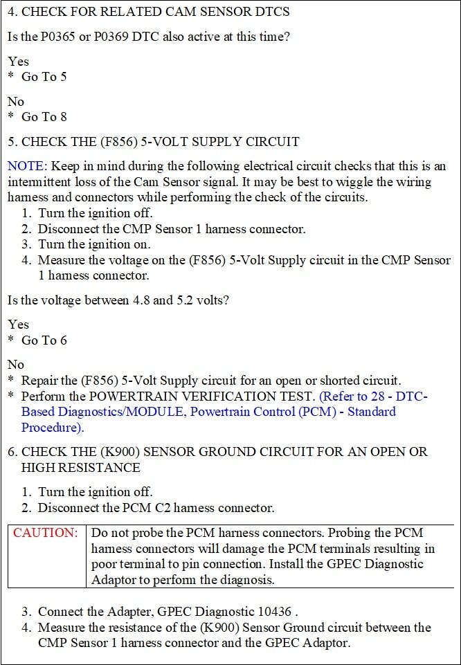

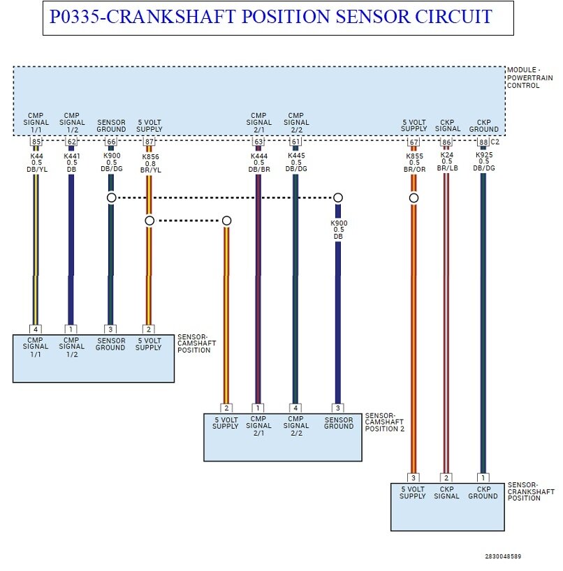

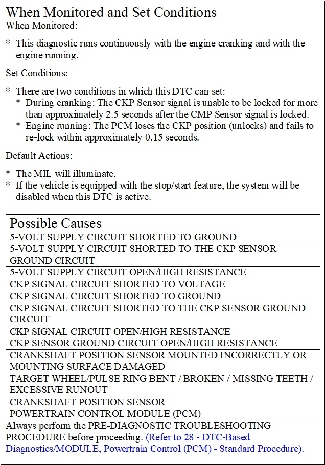

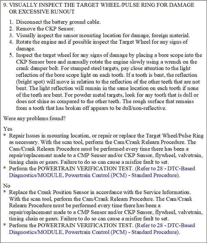

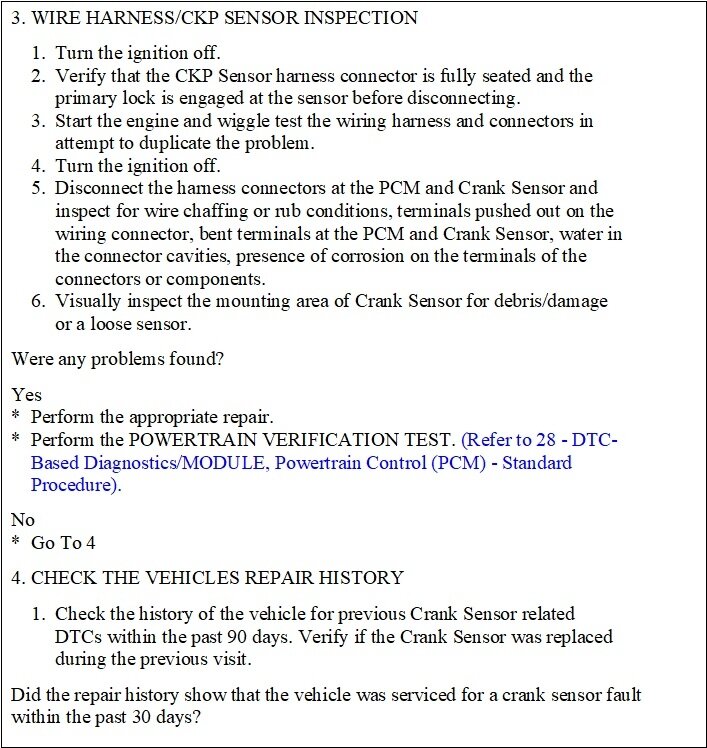

The crankshaft sensor wearing has not been inspected or tested. I found it very difficult to get to in my driveway. Tomorrow, I will jack it up higher and really check the crankshaft! I've been waiting on a pair of hands to do it but nobody shows up so...
Feb 4, 2024 at 4:13 PM
Just be sure where you are getting the parts. There have been a lot of fakes sold online. I buy from the local stores normally but I have accounts with them, so I get a better price than others. I'd show up to help, but the weekends are when I can work on my own stuff. Did an alternator on an F150, two front hubs and an axle on a Journey, put a bumper cover on a Mitsubishi and have a taillight with glue curing on it for a Hyundai in the bay waiting for tomorrow. That should clear out the family vehicles for another week.
Once you get the crank sensor tested and look at the other power feeds at least we might have a better idea if it's ECM related.

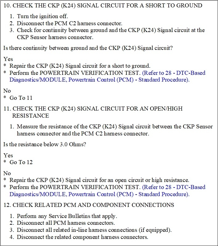

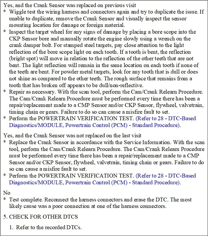

I thought I sent an update for you guys. But I don't see it.

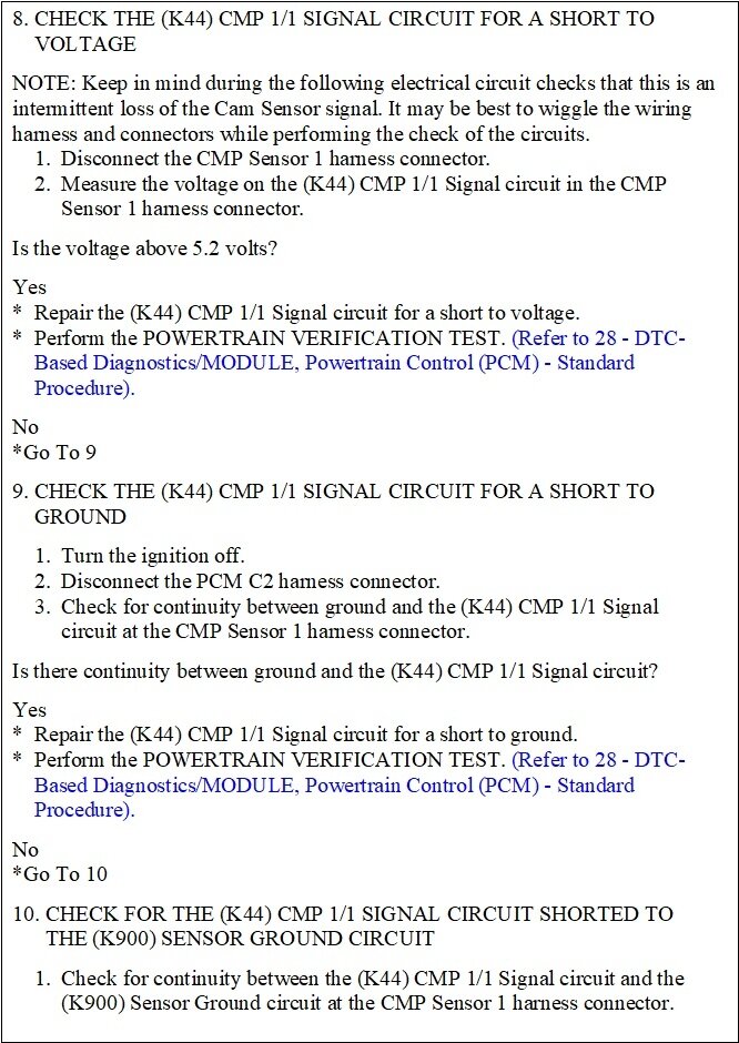

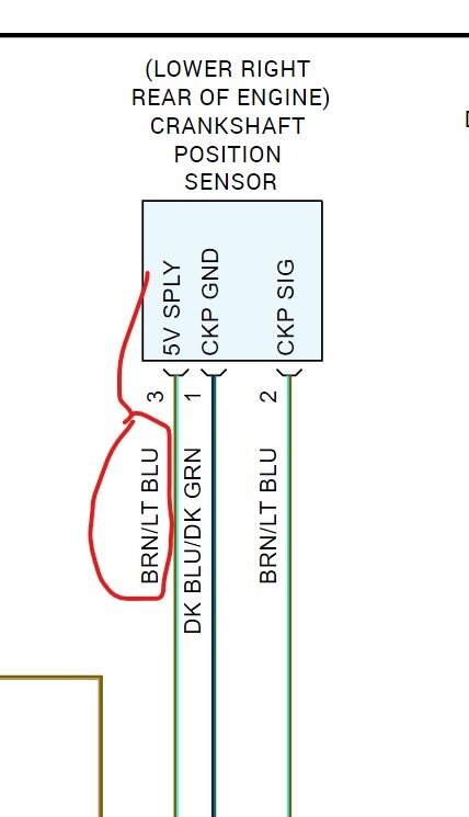

The wire to the crankshaft sensor looked good. I was able to follow it 90% of its way it was still covered in the thermal foil, to where it entered the harness.
I had it running yesterday all day, it even took me to a store or two. Although I never shut it off till I got home. It ran like crap. I felt like what a bad coil pack or two feels like, or should I say a cylinder or two misfire, and that's how it was running. But it would idle by itself.
So the newest codes I get after clearing the rest Again, is a P0206, P0300. The original permanent codes are still permanent figuring I haven't driven enough. I am going to change the 6 fuel injectors, at 197,000 miles on the original injectors warrants change. While the airbox is off, because I do not want to take it off again! I might be changing the packs and plugs on all 6 cylinders as well. It's a nice van Worth putting a couple of Bucks into. Wish me luck I'll let you know how I do... Also adding a report.

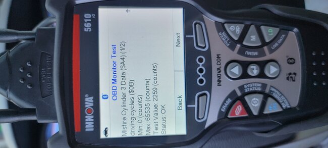

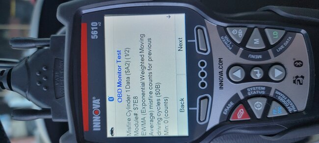

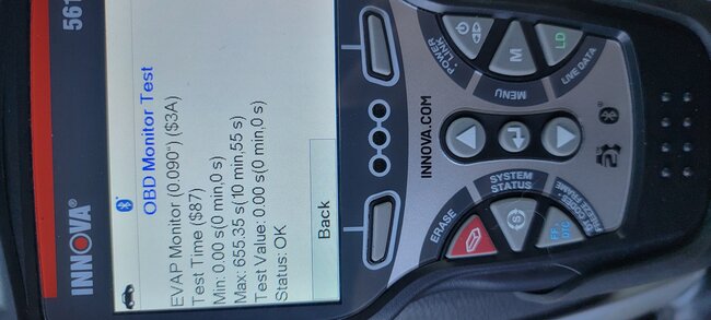

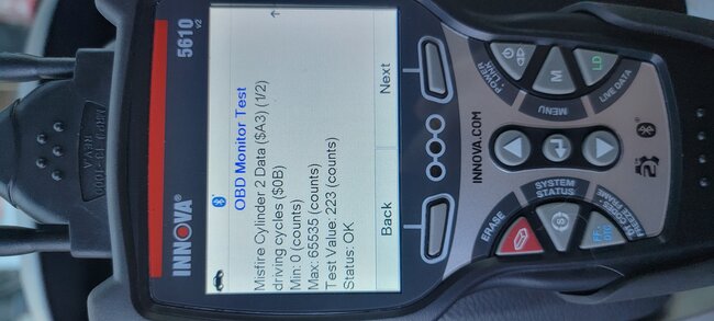

Feb 9, 2024 at 9:22 AM

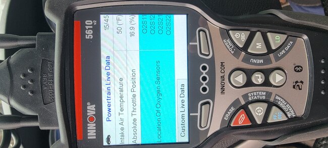

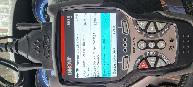

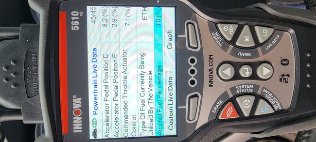

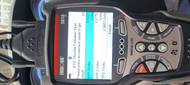

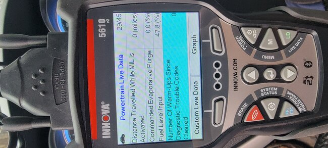

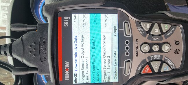

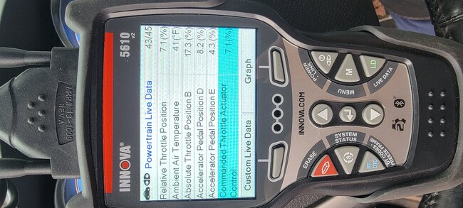

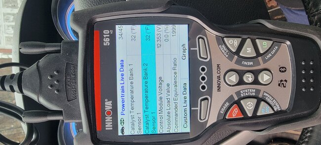

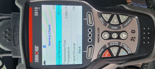

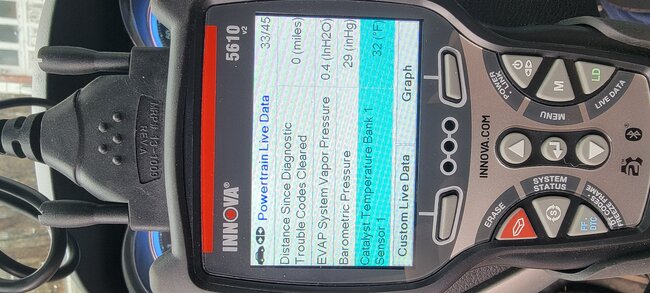

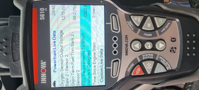

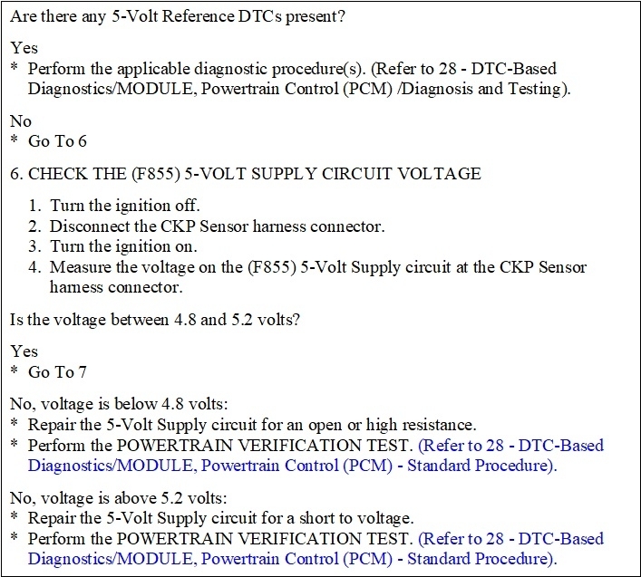

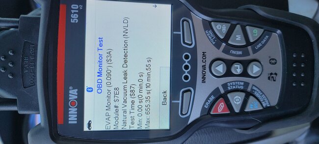

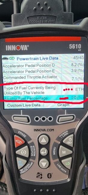

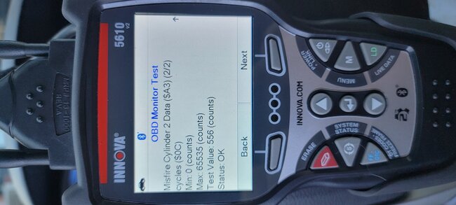

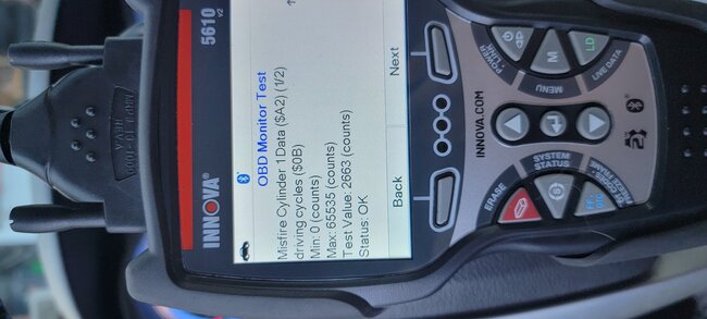

I also wanted to ask about some readings I got on the scanner. I'm sending pictures of those readings. I'm interested in the cylinder misfiring. And I'm wondering if I'm reading it correctly. Plus, an evap screen shot or two. Again, I'm not sure what I'm looking at...

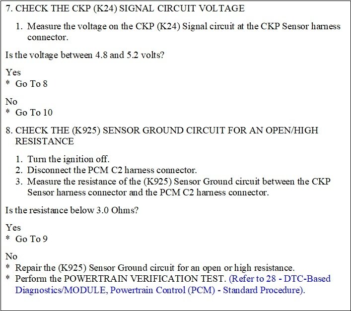

Update: yesterday I spent the entire afternoon Find the crankshaft sensor out of the engine block again. This time to test voltage at the connector. Between terminals one and three I had five volts. Between two and three I had five volts, between one and two 0 volts! I also inspected every inch of the wire, Covered with aluminum foil heat shield, And seen no evidence of damage whatsoever From the sensor into another wiring harness near the battery. So right now I currently have P0206, P0339, Existing trouble codes. Could not get the engine to Start at all yesterday. I plan on changing the set of fuel injectors. anything I should know? is there an engine shut down circuit? If so why and when?
Feb 10, 2024 at 7:39 AM
Sounds like there is bias voltage at the sensor and it's likely okay. Running as long as it did shows that the sensors are working at least most of the time. Pin 3 to ground should be 5 volts (which it is pins 3-1) Pin 1 is ground pin 2 is a simple square wave signal that changes state as the engine rotates, and the sensor reads the reluctor. It basically turns on and off and tells the PCM where the crankshaft is by the pulse count from a trigger notch.
For the misfire readings it looks like 1&3 are the worst offenders and 2 might be clearing itself out by the counter trending down. Typical of an engine that hasn't run for a while but had several starting attempts, the plugs get fouled from the fuel.

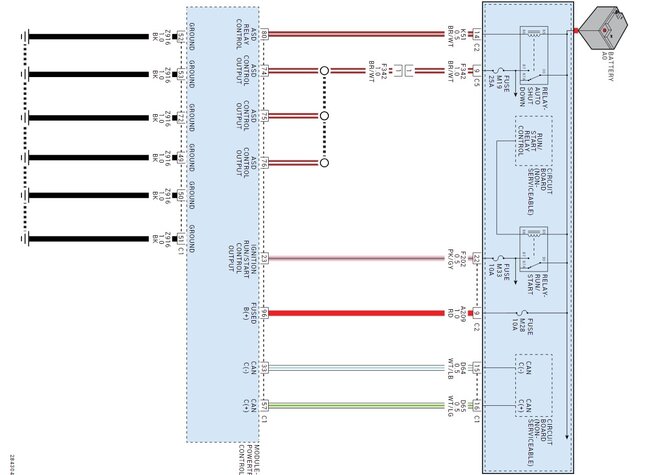

It uses the Auto Shut Down relay for the engine shut down, but that relay is easy to test. Pick any coil positive feed, turn on the key, do you have voltage? Yes= ASD is okay.

100% not really, but 90% is possible mainly because of some of the ways they are used. The problem is that doing the testing without an OE level scan tool and a scope is hard. In many was I wouldn't trust most dealers for this either. A couple folks I would suggest would be Eric at South Main Auto down in Avoca or Markhams up in Constableville. Believe they are sort of in your neck of the woods.
