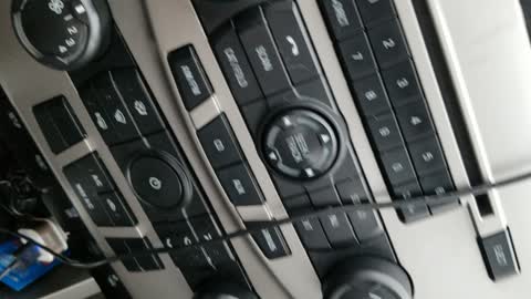

MARBLCK86
  • 19 POSTS
Now I do know if you can really hear the noise but it's on this video, I did a little research and came across this one. Boy that was having the same issue with his truck, and found out that it could be the CV axle.

  • 110,194 POSTS
Welcome back:
I listened to the video. It sounds like something that is turning making the noise. It could be one of the joints in the axle or even a wheel bearing. Is there any humming when driving or clicking when turning?
Take a look through this link:
https://www.2carpros.com/articles/symptoms-of-a-bad-cv-axle-joint
Let us know.
