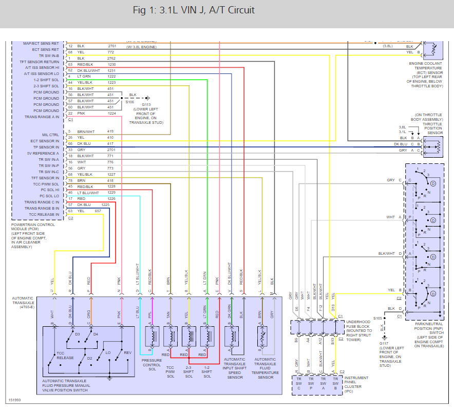

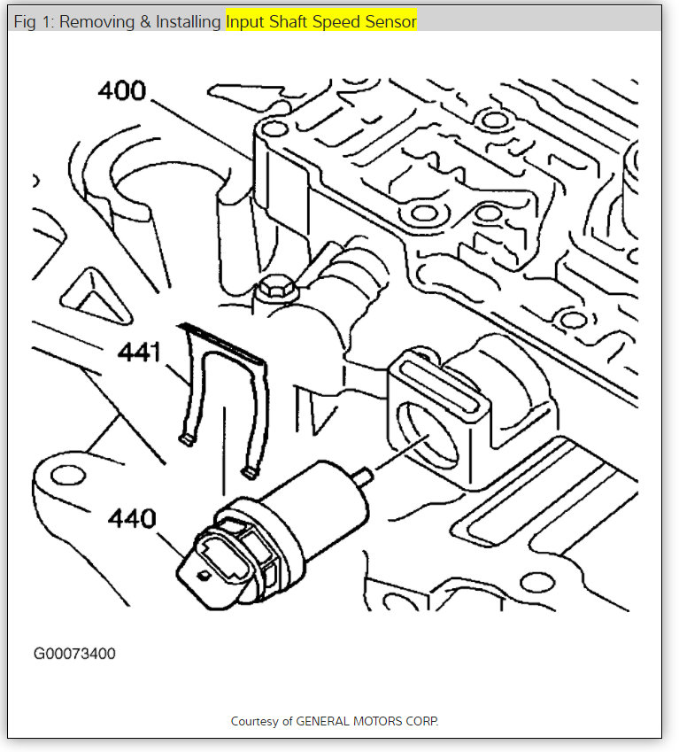

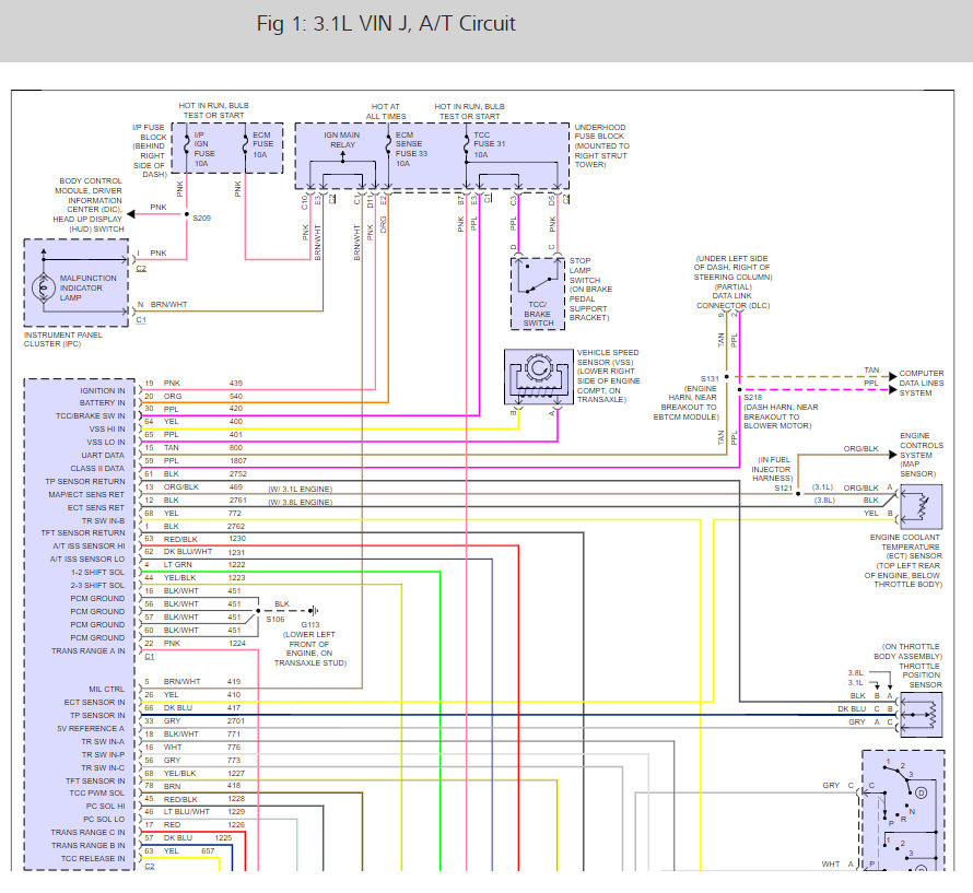

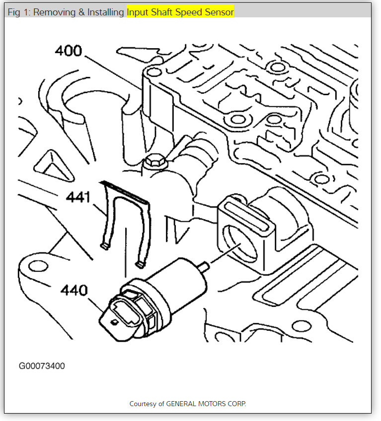

It sounds like you have an input shaft speed sensor that is going out but to be sure lets run the codes to see what codes up. Here is a guide to help us get started:
Here are the transmission wiring and speed sensor location.
