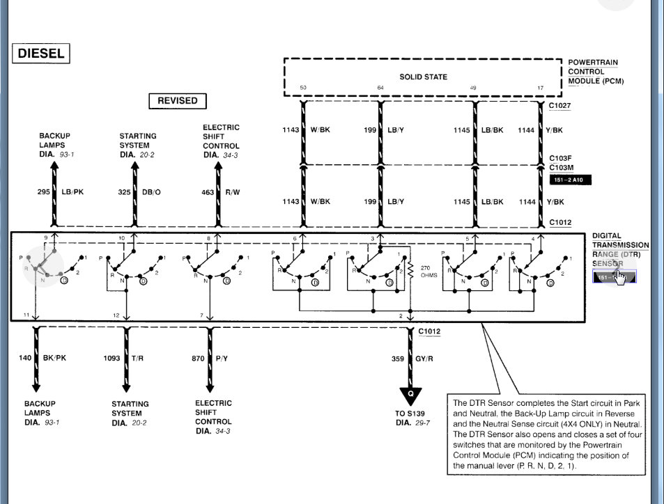

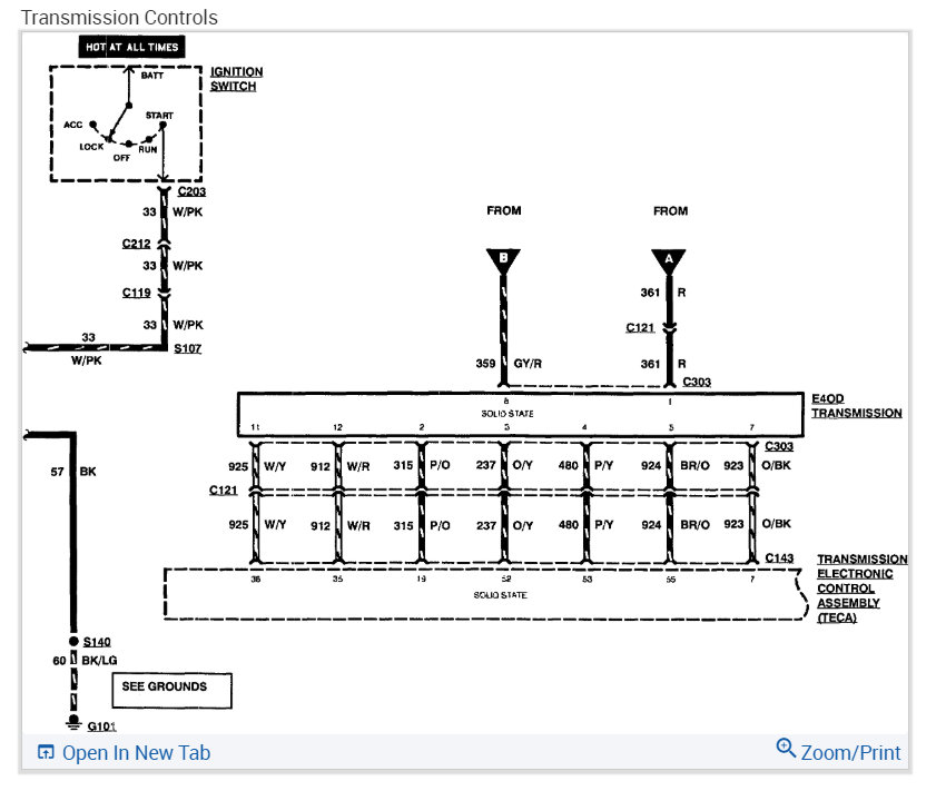

Needing to replace my neutral safety switch wiring and check wiring for whole transmission.
Saturday, April 25th, 2020 AT 12:24 PM
17 Replies

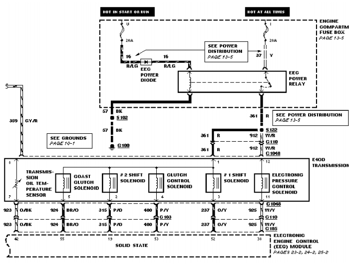

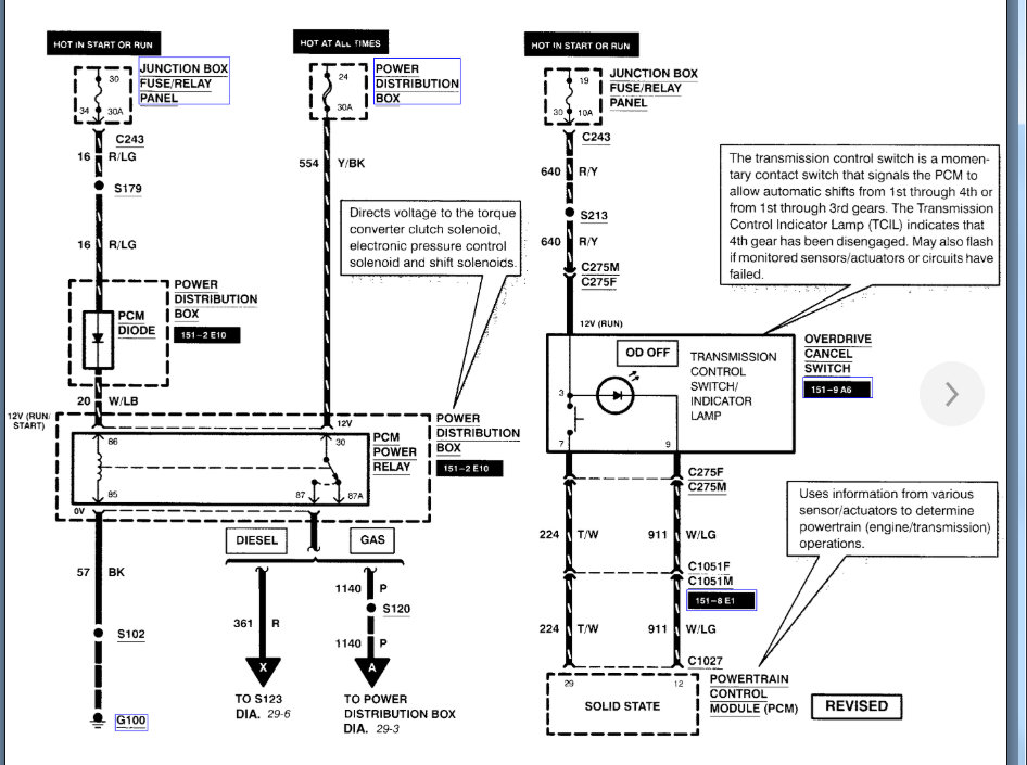

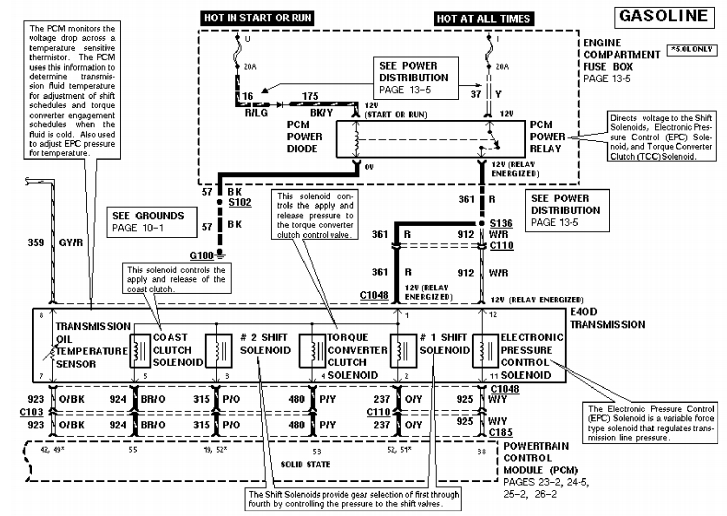

I attached the wiring diagrams from Ford on the transmission. Let me know if you need more info and we can get it for you. Thanks
FYI - The neutral safety switch on an automatic is called a digital transmission range sensor. Others call it a transmission position switch or just a range sensor.

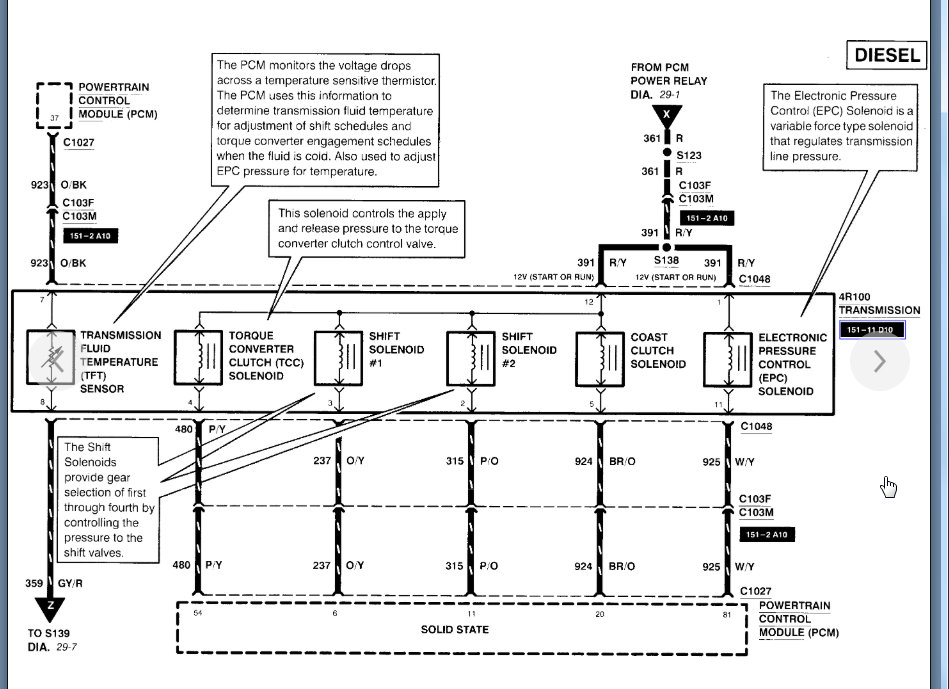

I have a 92 f-250 7.3L diesel and the wiring harness from the transmission somehow got wrapped around the axle and pulled some of the wires out of place. I can not find this particular wiring diagram anywhere is there any place that it can be located.
Thanks!
Monday, July 27th, 2020 AT 5:11 PM (Merged)
HMAC300
  • 48,601 POSTS
Here are the transmission wiring diagrams and a guide to help you test the connections.

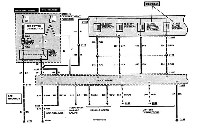

I am having some problems with my 92 ford truck I just put a transmission in it from a 94. I think the torque convertor lockes up right after I put it in gear. Connectors fit but looked different. Diagrams would help. Thanks!
FIXITMR
  • 9,990 POSTS
Do wire colors in plugs match?

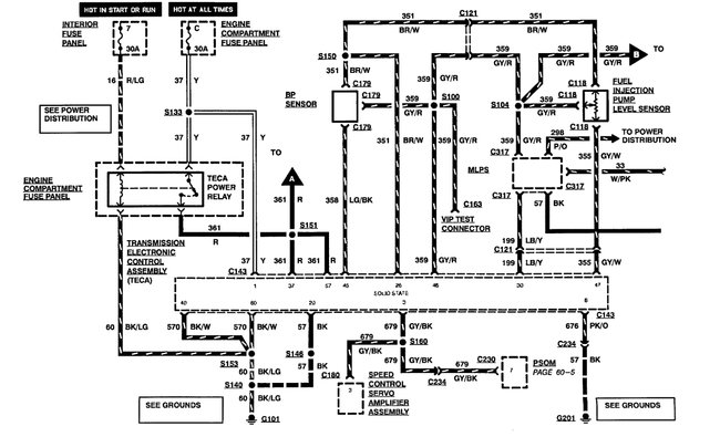

Does this help?
-1
FIXITMR
  • 9,990 POSTS
That was 94 schematic, here is 92.
+1

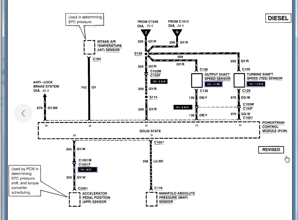

I found out whats going on but not shure whats causing it. The engine is only running on 4 cylinders at times. The computers ground pulse is cutting out on cylinders 2, 3, 6, and 7. This is all happened when I put the transmission in. Truck runs bad now, Any ideas to further troubleshoot this problem?
J.STIEG
  • 361 POSTS
I forgot to mention that it was the fuel injectors that are not being driven by computer.
FIXITMR
  • 9,990 POSTS
Those cylinders are ground bank #2 from computer the other 4 cylinders are bank 1. Check output right at computer pin 69 (white wire) next to it is pin 68 (tan wire bank #1) if good wiring/connections are suspect.
