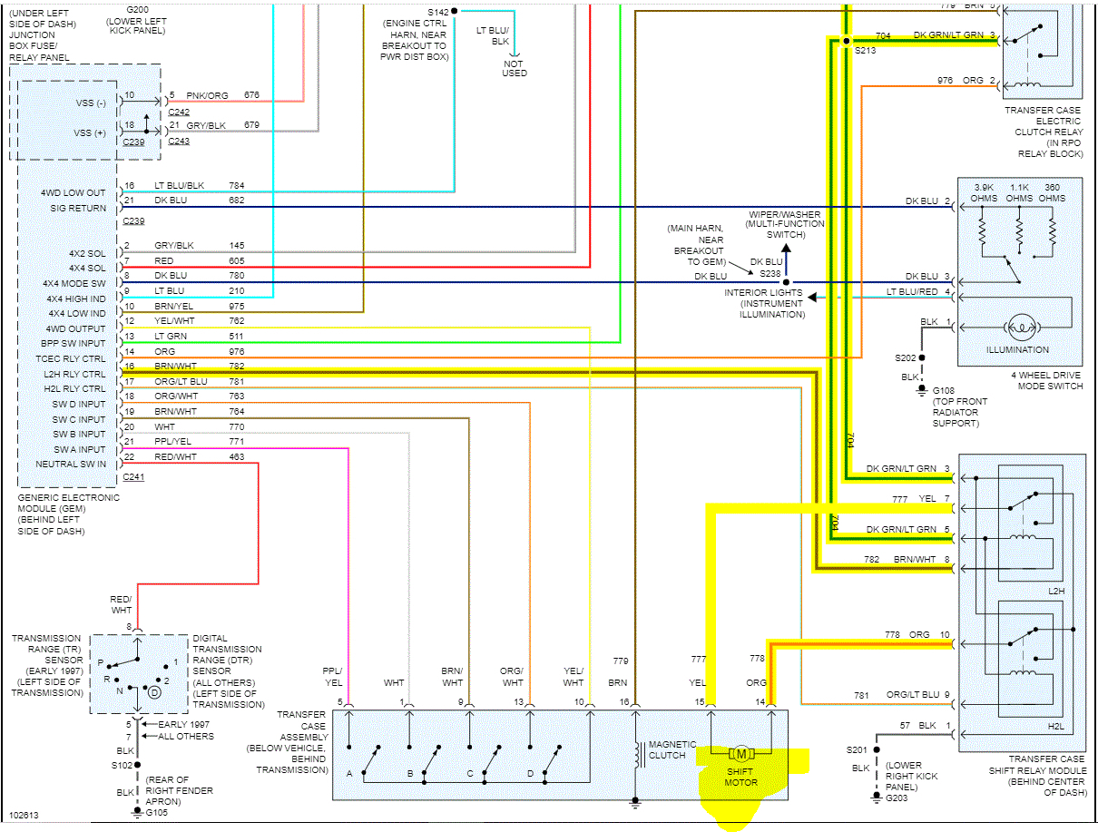

Truck starts in park or neutral. When put in gear, reverse, or drive, the RPMs will go down like it's engaging but acts like it is still in neutral. Truck won't move. When put back in park the parking pin sounds like it's grinding. Wont lock tires out. Will roll with it in park. The code tripped says it's the shift module behind the fuse box. But why would it not lock out in park? I can see maybe the fluid pressure sensor not engaging but is there some way to check this out?

I pulled it home with a tow bar and the person that road in it said no noise. It was in neutral. The code tripped was p1838 and the torq converter lock up was 0%.

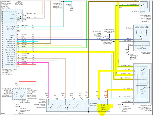

Okay, the code is specific to the shift motor. There is no movement in the motor when the relay is activated. I feel confident that the transfer case is stuck in neutral.
With this code, you could have a poor connection at the shift motor, a wiring problem, or the shift motor itself may be bad. Since you indicated it shows the 4wd system is responding, I don't think it's a power issue, but we need to check.

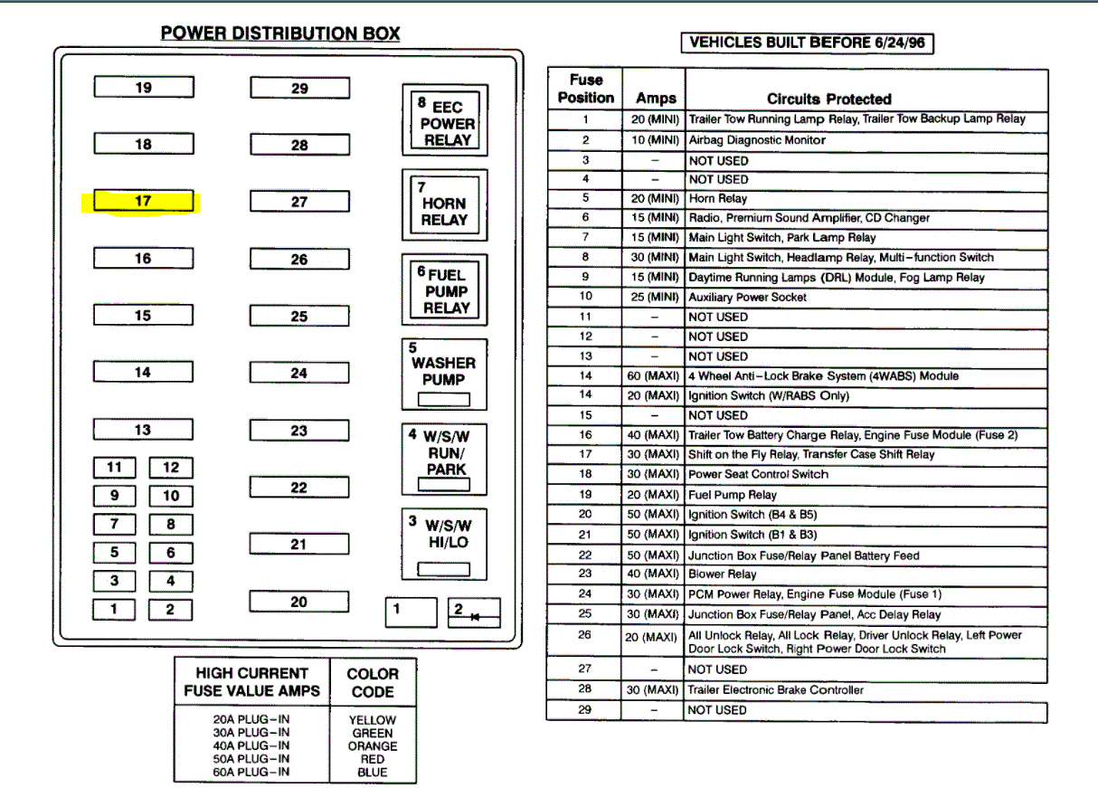

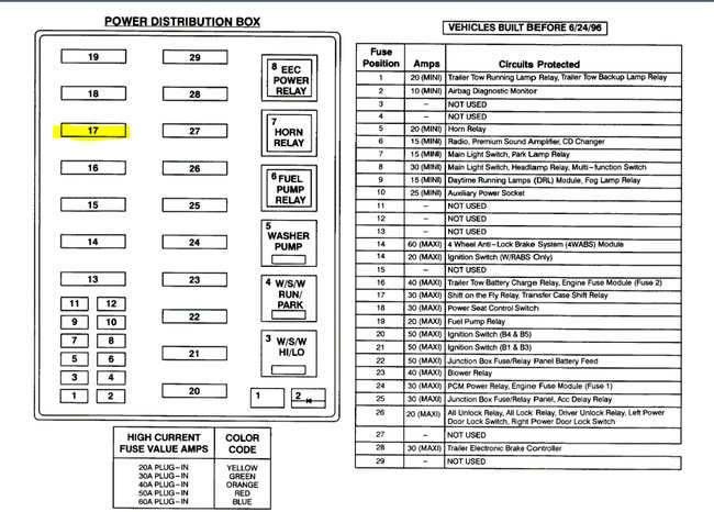

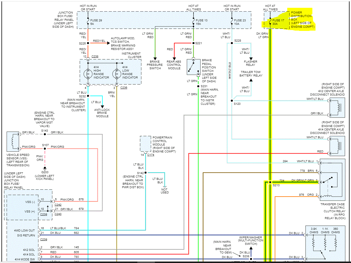

First, I need you to check fuse 17 in the under-hood fuse box. Confirm it's good and has power both to and from it.

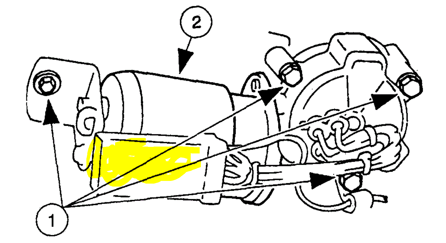

If that checks good, I need you to locate the shift motor on the transfer case. I attached a general pic of what it looks like. (see pic 3) Have a helper switch between 4wd and 2wd to see if there is power at either of the two wires (one yellow and one orange).
If you find there is power and there is no movement in the motor, chances are the motor is bad.

The last pic below shows the fuse to check in the under-hood fuse box.

Thank you! It was the shift motor. I took it off and it was in neutral. I used pliers to put it in 2 low and it drives fine. Waiting on a new shift motor now. Thanks again!
