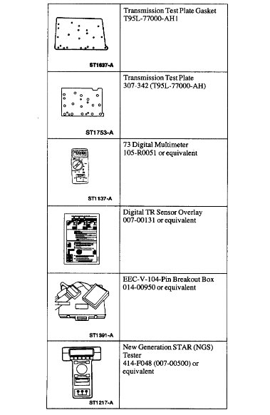

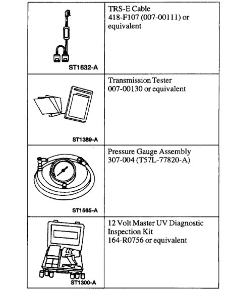

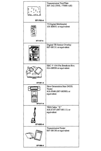

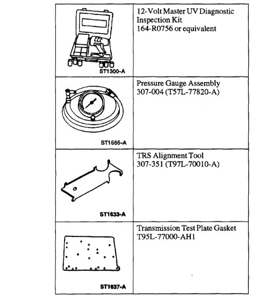

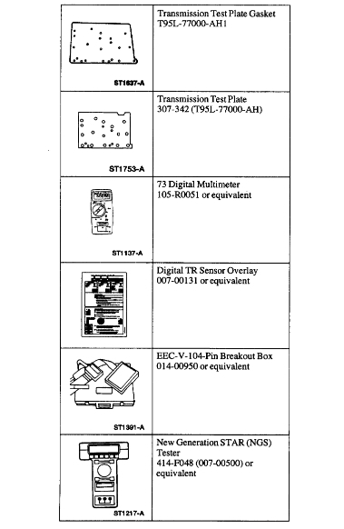

You would be doing a transmission rebuild.
Yes, you need a lot of special tools to perform this service.
Do you have a transmission stand?
