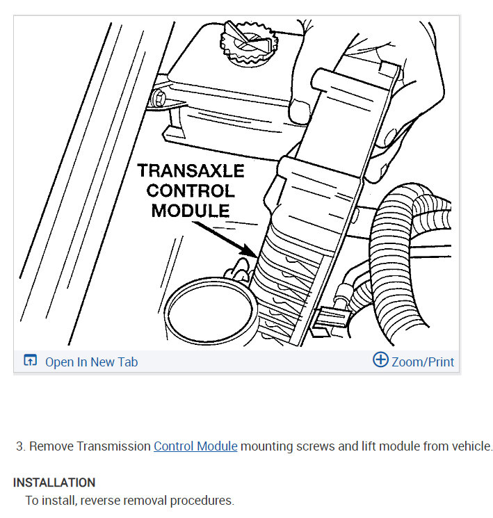

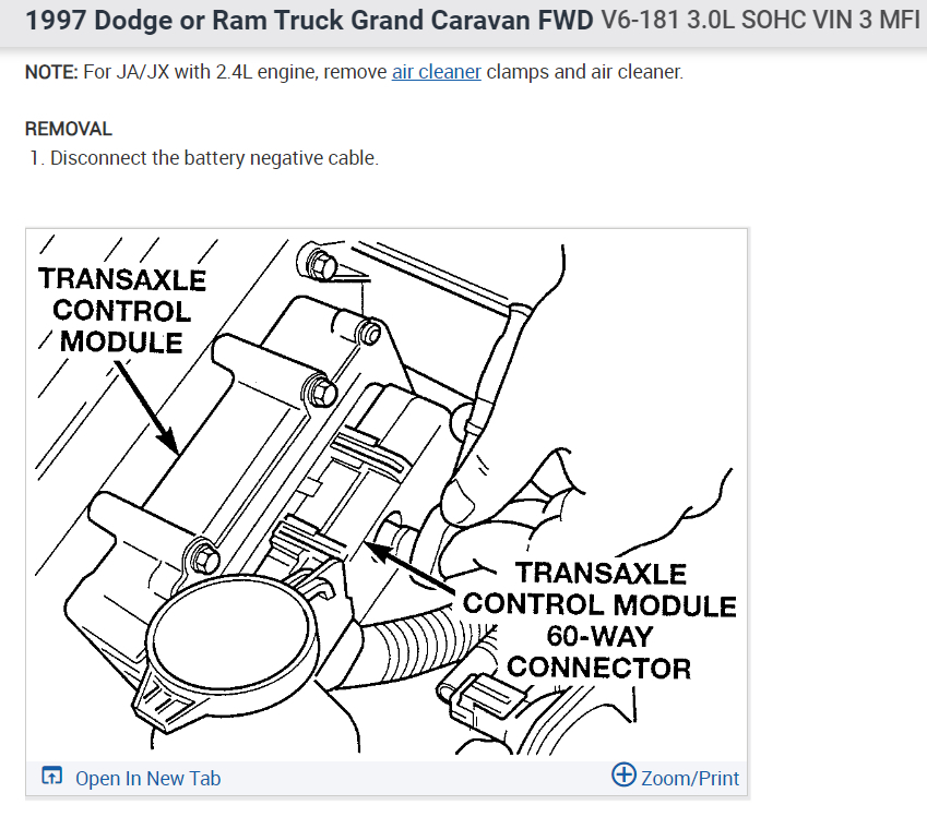

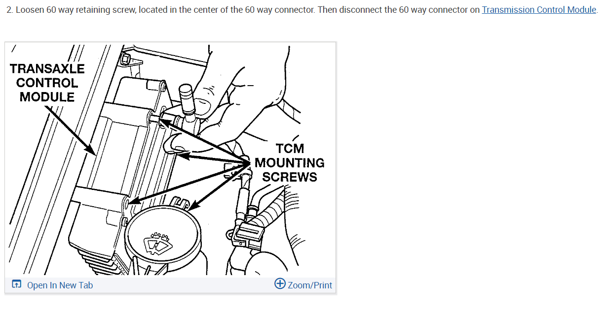

Yes, I have seen many TCM go out on these vehicles, here is the location and how to change it out so you can see what needs to be done. I would check Ebay for the part. Check out the images (below). Please let us know what happens.

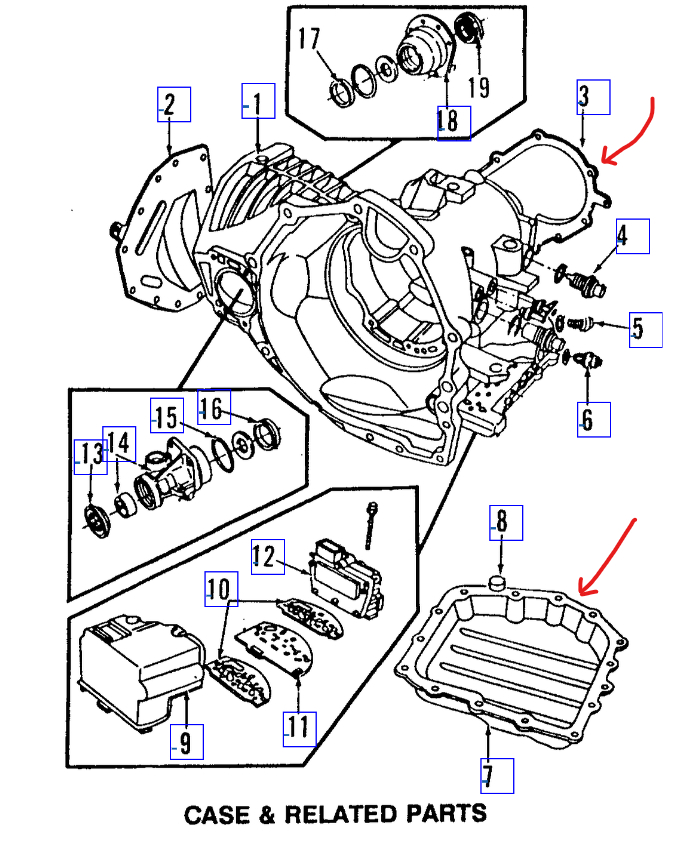

He told me his computer showed the TCM was getting no connection so that's why I asked you, but we should have it changed on Friday. Also, do we have to drop the transmission to put on the oil pan gasket? He said he got all the bolts out but one he can't get to and said he had to drop the transmission to get to it.
Tuesday, December 26th, 2023 AT 11:19 AM
KEN L
  • MASTER CERTIFIED MECHANIC
  • 55,266 POSTS
If he is changing the side pan gasket then yes it may need to be dropped down a little to get to the bolt, I don't think you need to remove the unit though. If he is changing the bottom gasket then you don't need to drop the transmission out of the car. Let's start a new question for the TCM issue please. We only handle one problem per thread, please post your new question here, you must be logged in.
