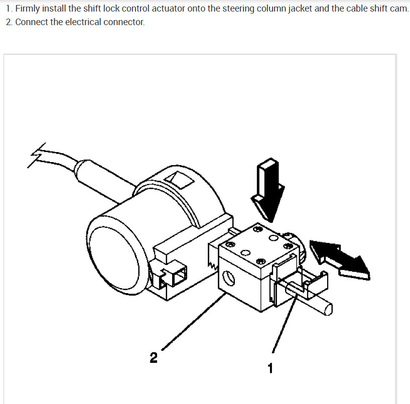

My truck won't go into gear when I start it, I have to cycle the key quite a few times and then it will shift into neutral. I'm trying to figure out the problem.

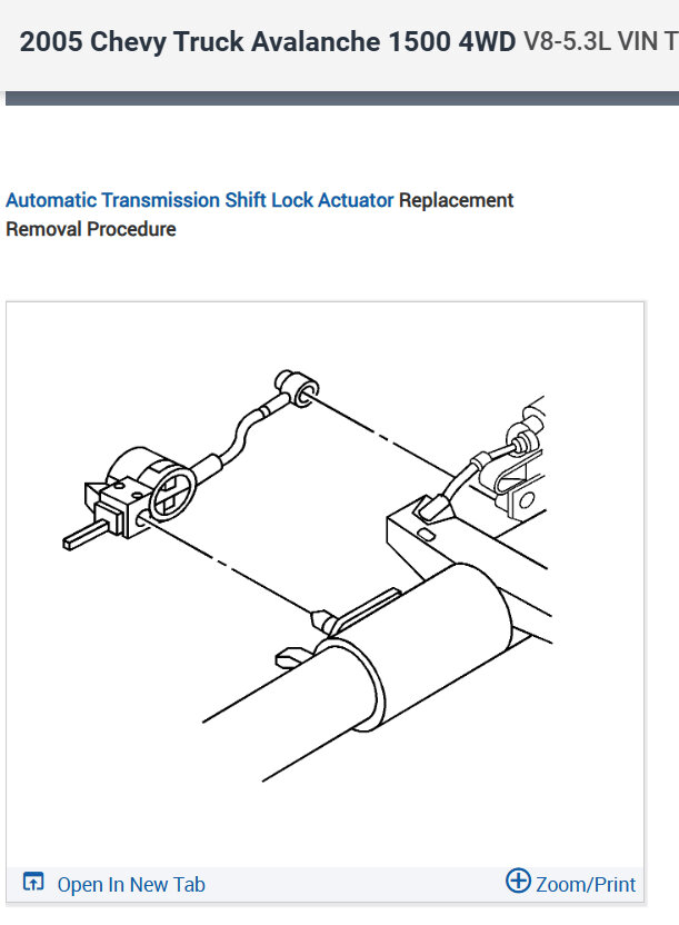

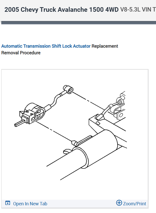

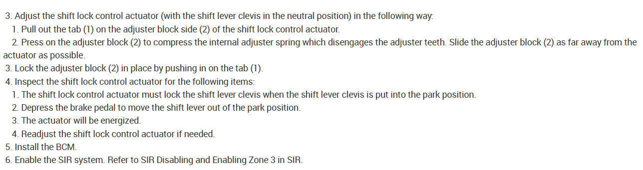

The gear selector doesn't move.

Okay, so it sounds like the shift lock is not working, I would check the B/U LP fuse and the BTSI fuse both are under the hood. Here is a guide to help and test the fuses, also if the fuse is okay here is the location of the shiftlock and how to adjust or replace it in case the fuses are okay.
Can I ask if the brake lights work? Check out the images (below). Please upload pictures or videos in your response of any problems so we can see what to help you with.
