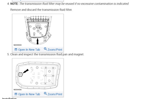

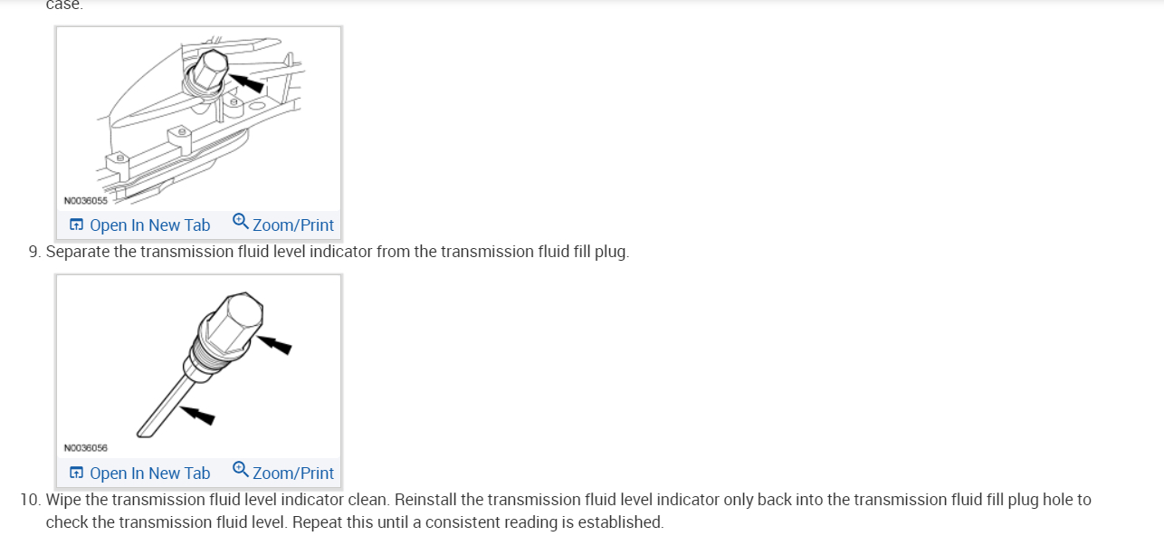

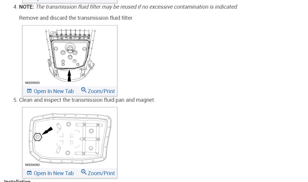

While driving the transmission will hard shift on fourth gear.
Nov 18, 2022 at 5:40 AM
  • 54,520 POSTS
You may have an accumulator spring that is broken inside the transmission. Is your ABS light on or the check engine light? If so, we need to run the codes to see what comes up, this requires a CAN scan which is easy to do. You can get a CAN scanner (Controller Area Network) from Amazon from about $32.00.
https://youtu.be/u-4syLc-ifQ
and
Amazon CAN scanner link:
https://amzn.to/3sX8MCX

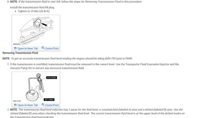

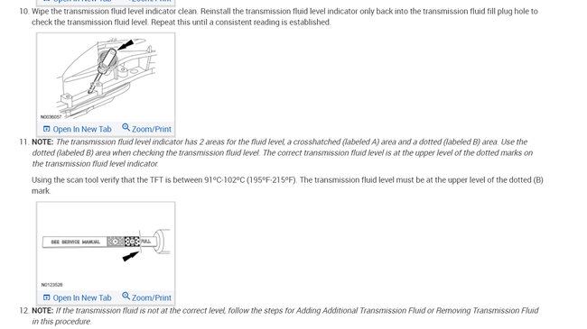

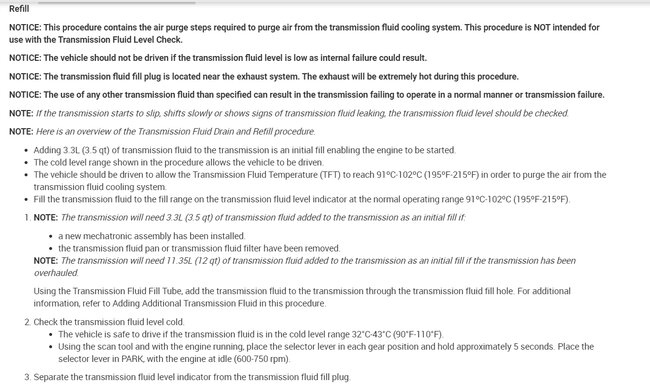

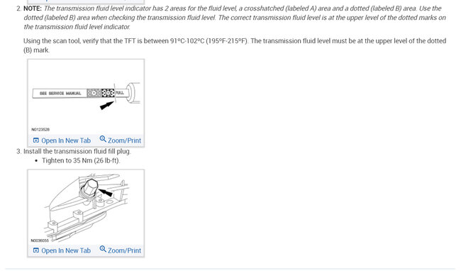

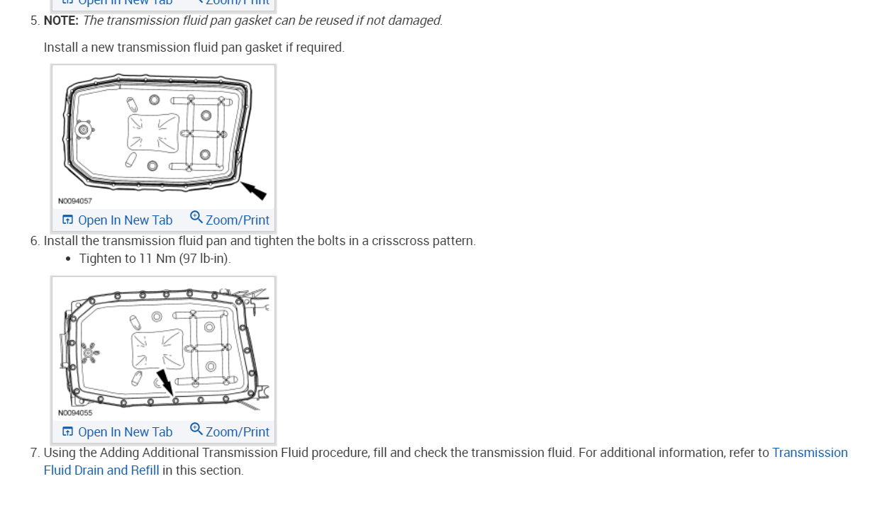

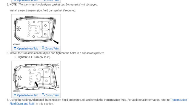

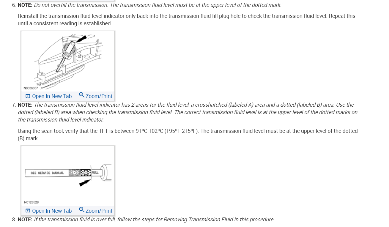

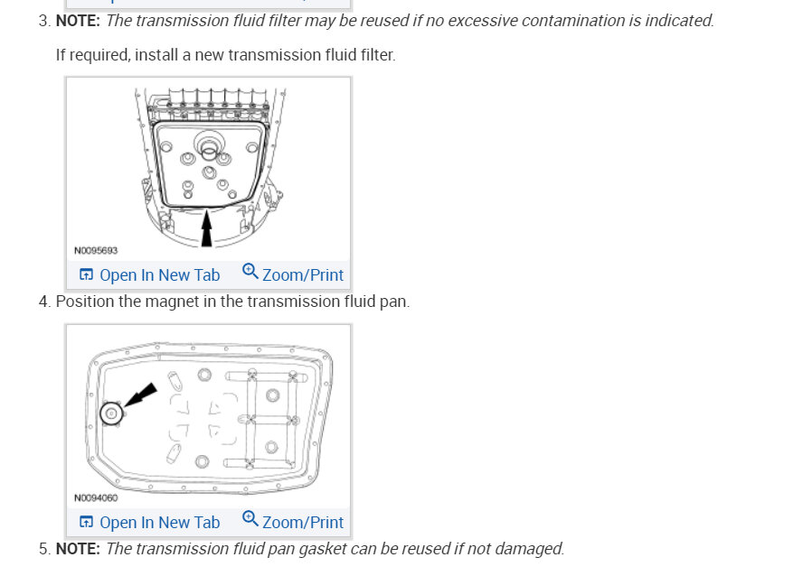

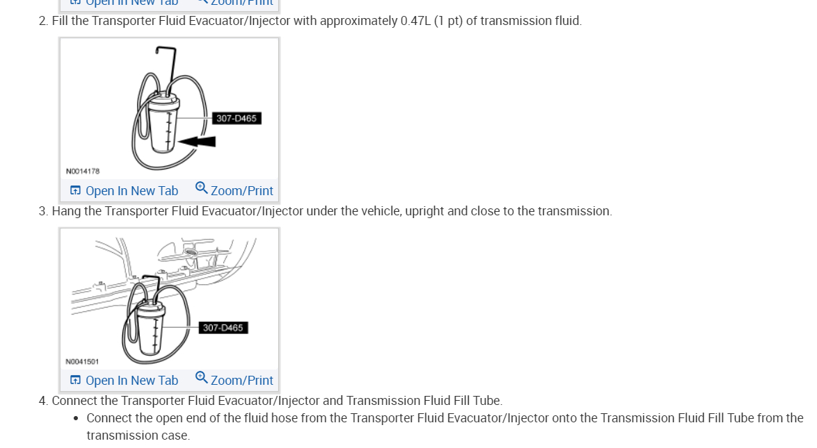

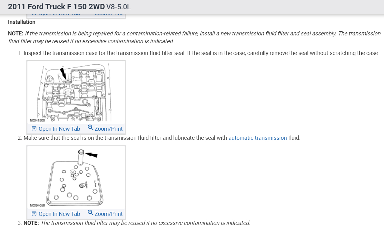

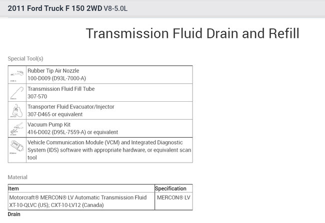

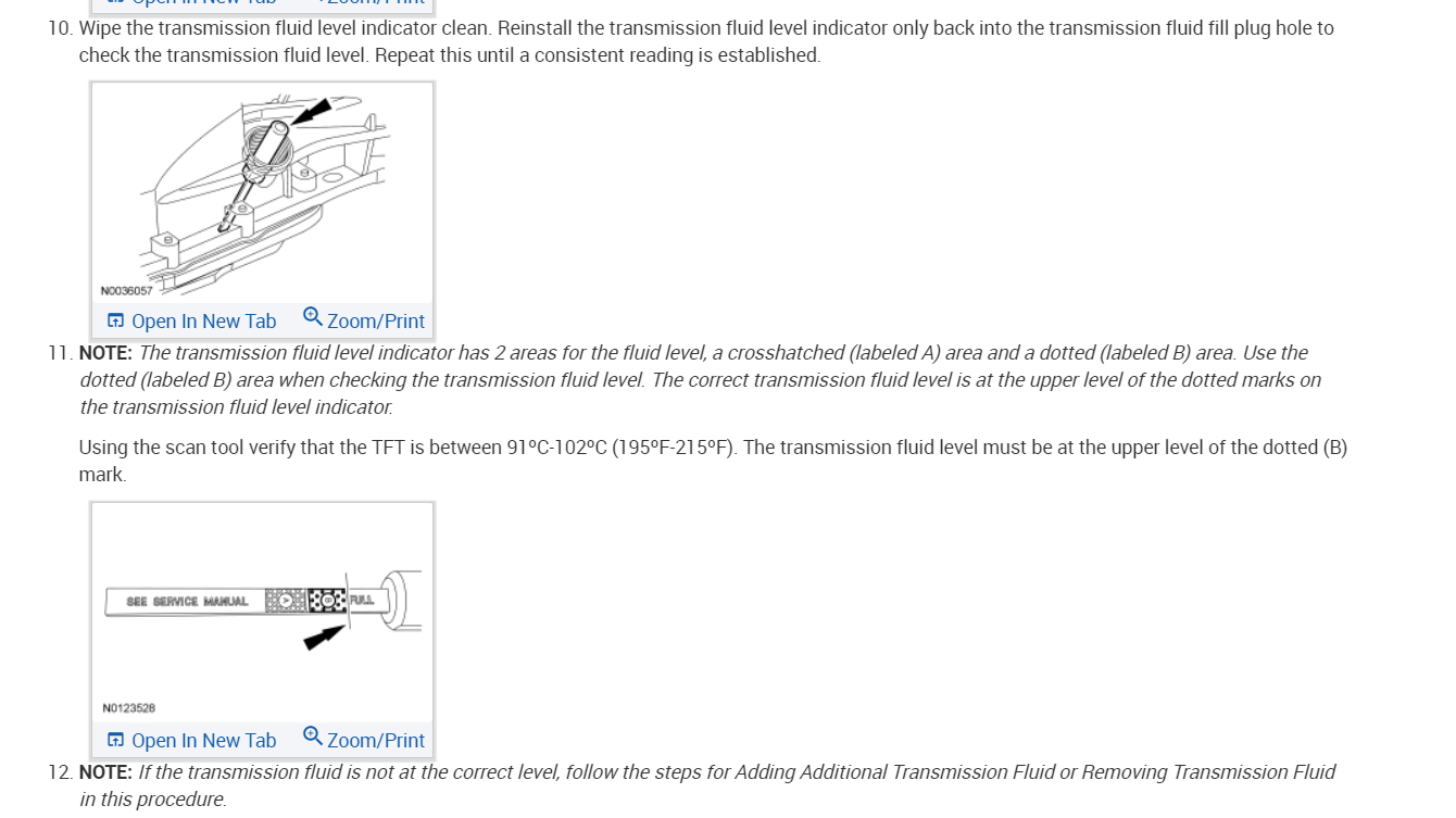

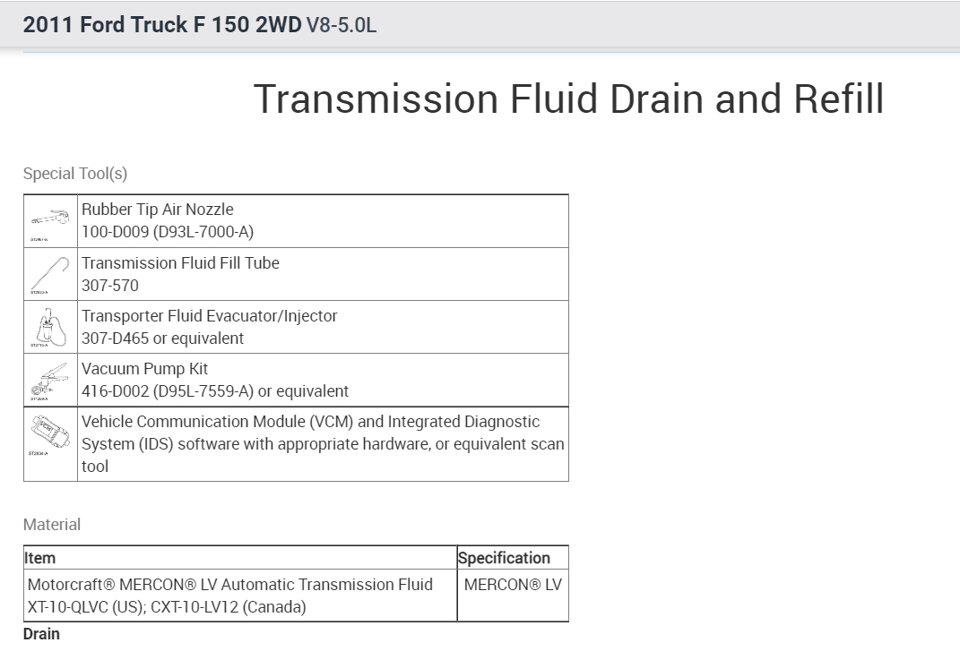

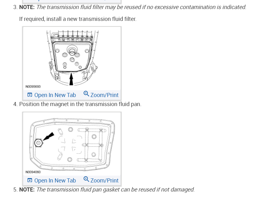

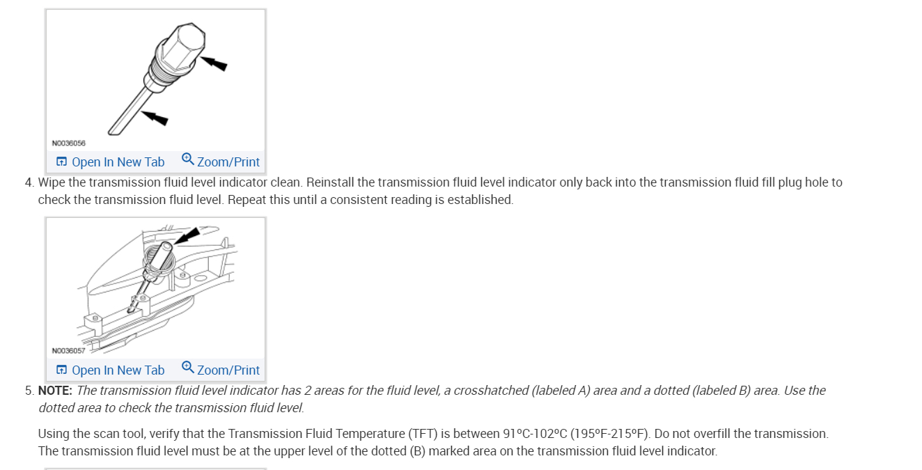

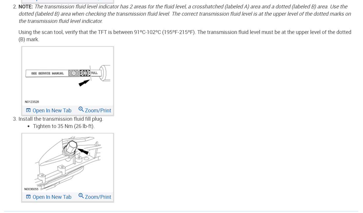

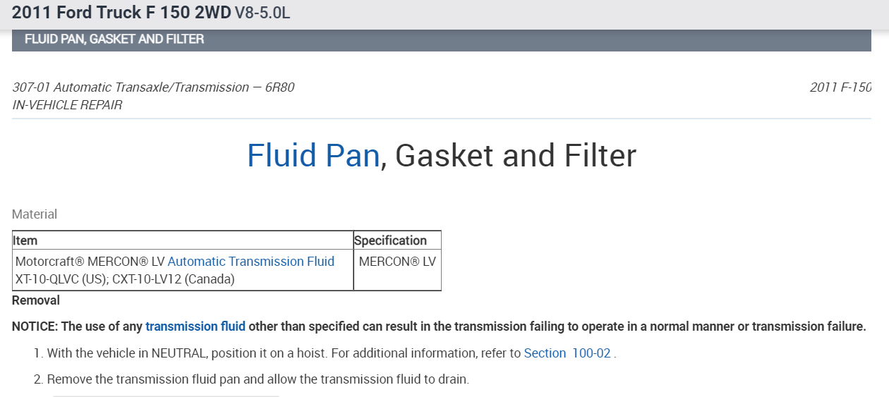

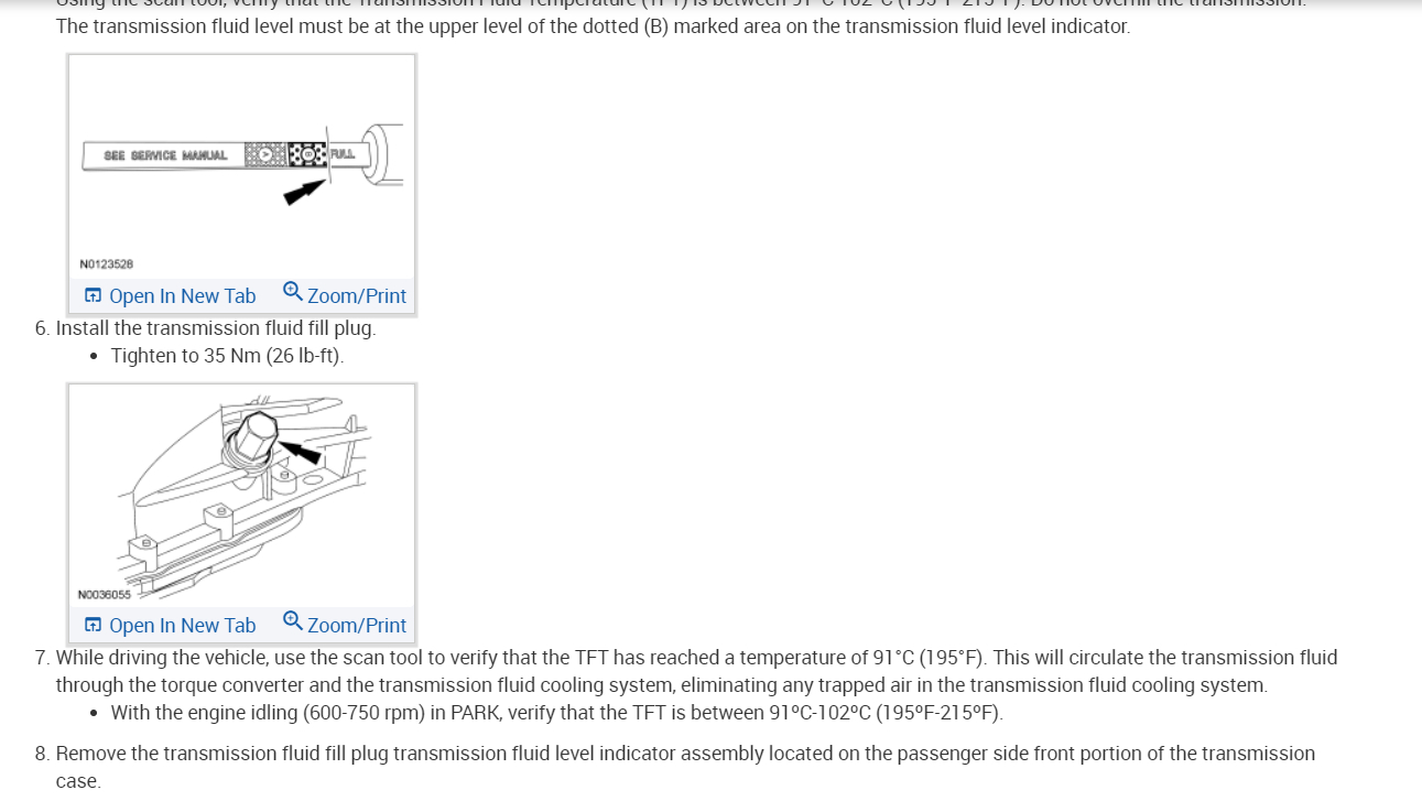

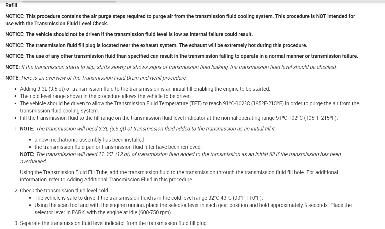

Also have you serviced the transmission recently? If not, I would install a new filter and fresh fluid. This guide can help with instructions in the images below for your truck:
Check out the images (below). Please let us know what you find. We are interested to see what it is.
