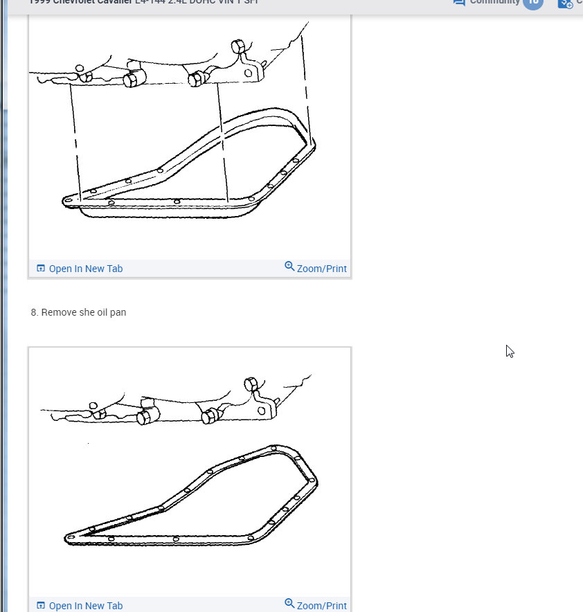

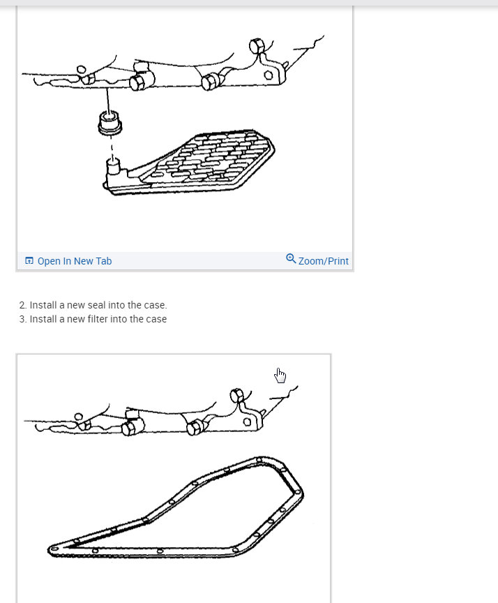

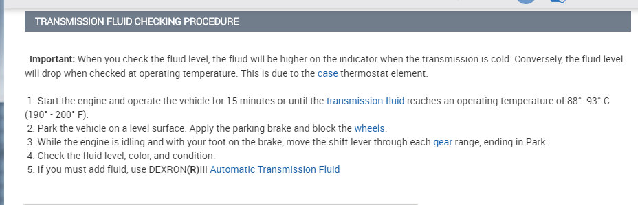

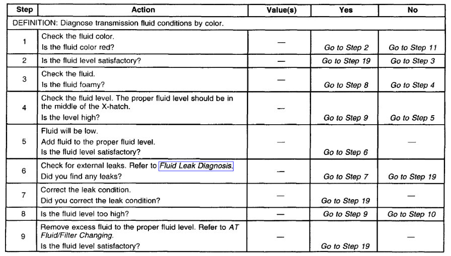

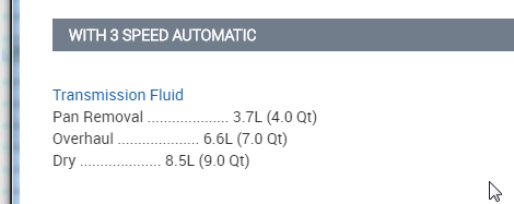

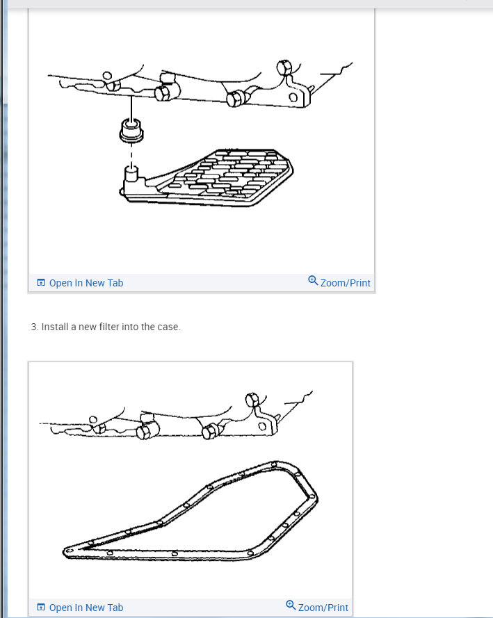

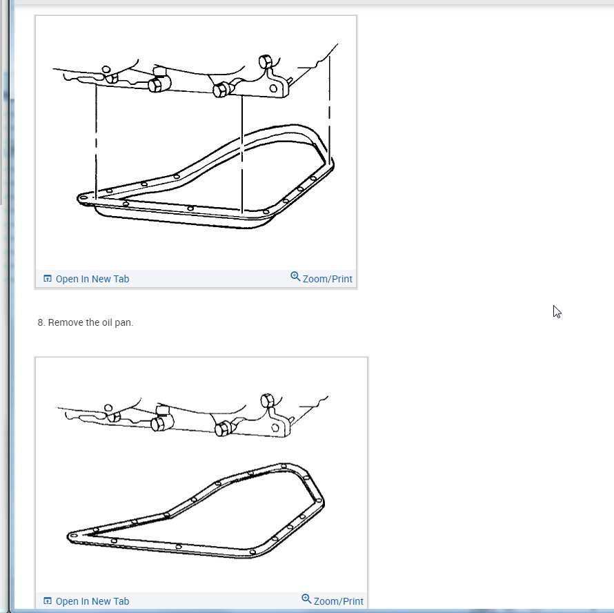

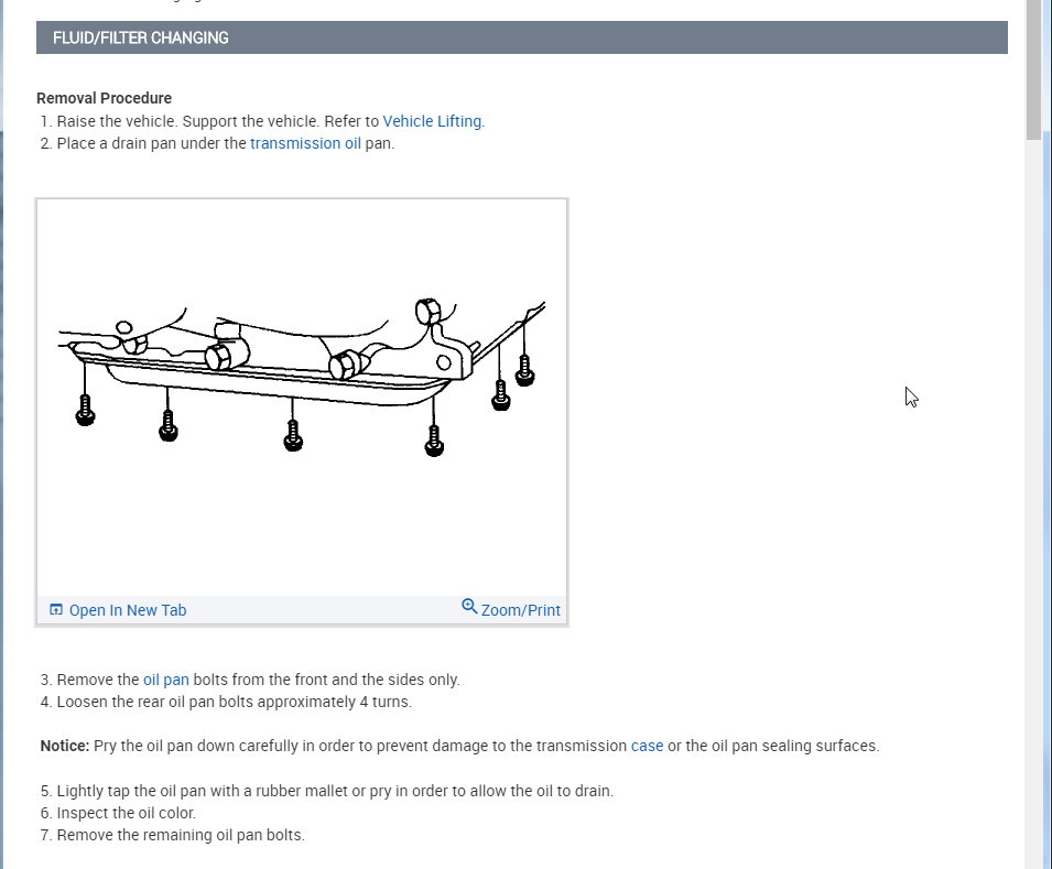

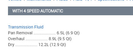

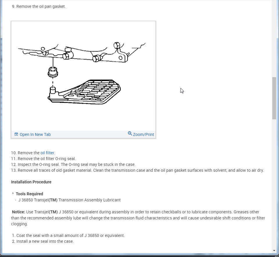

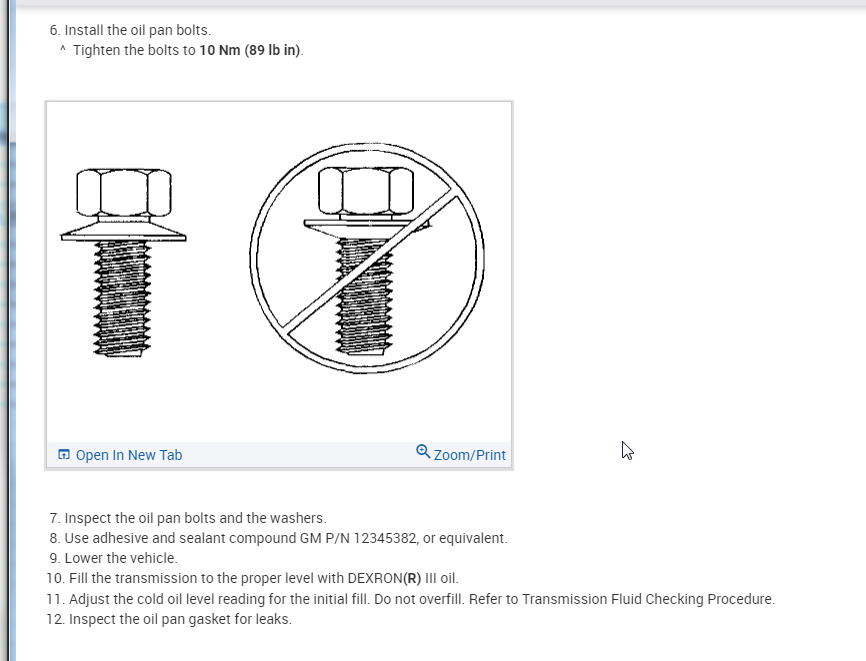

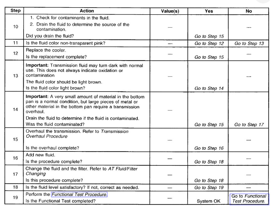

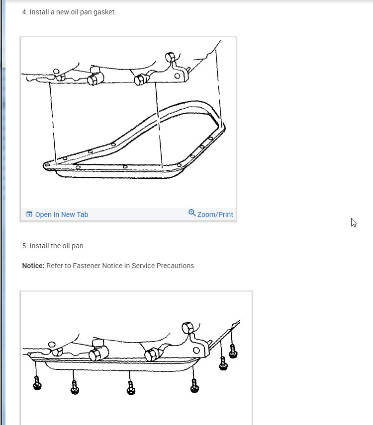

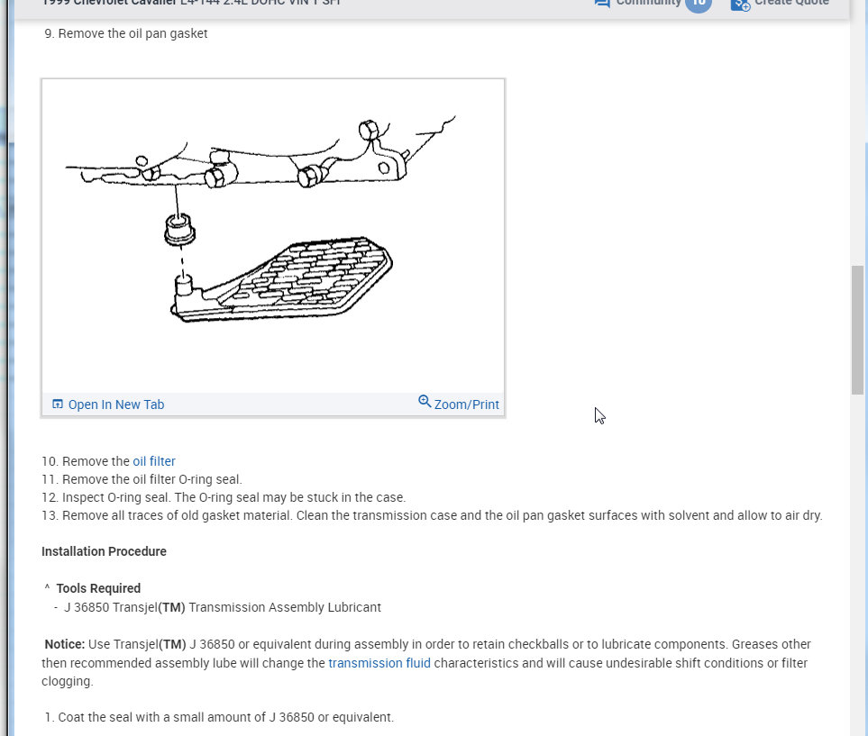

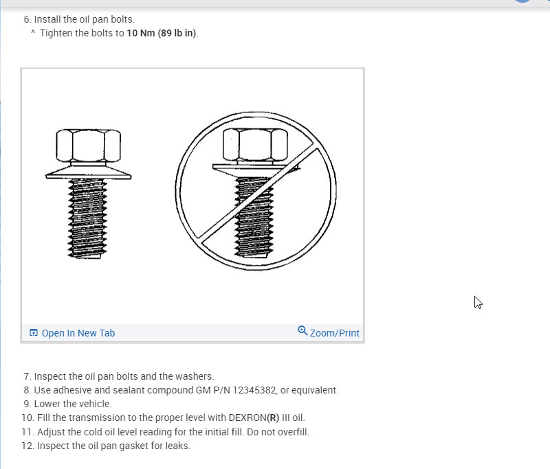

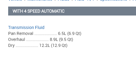

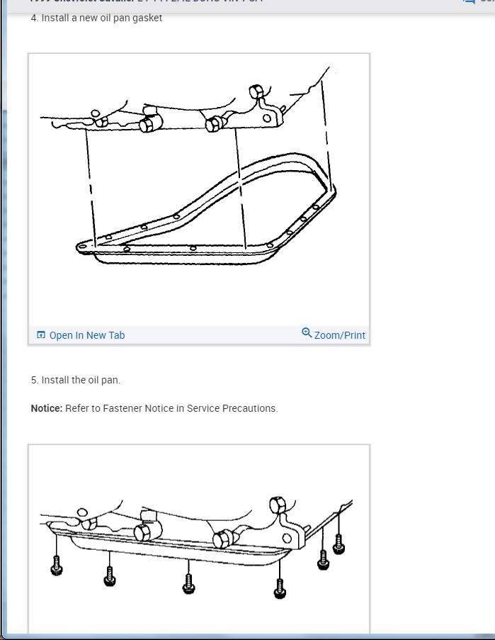

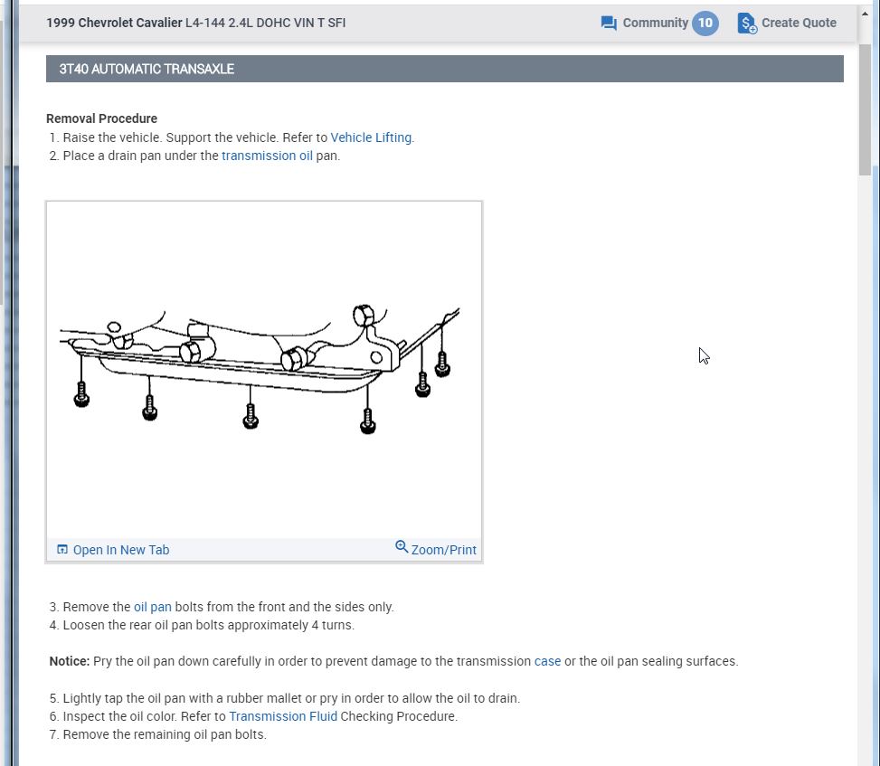

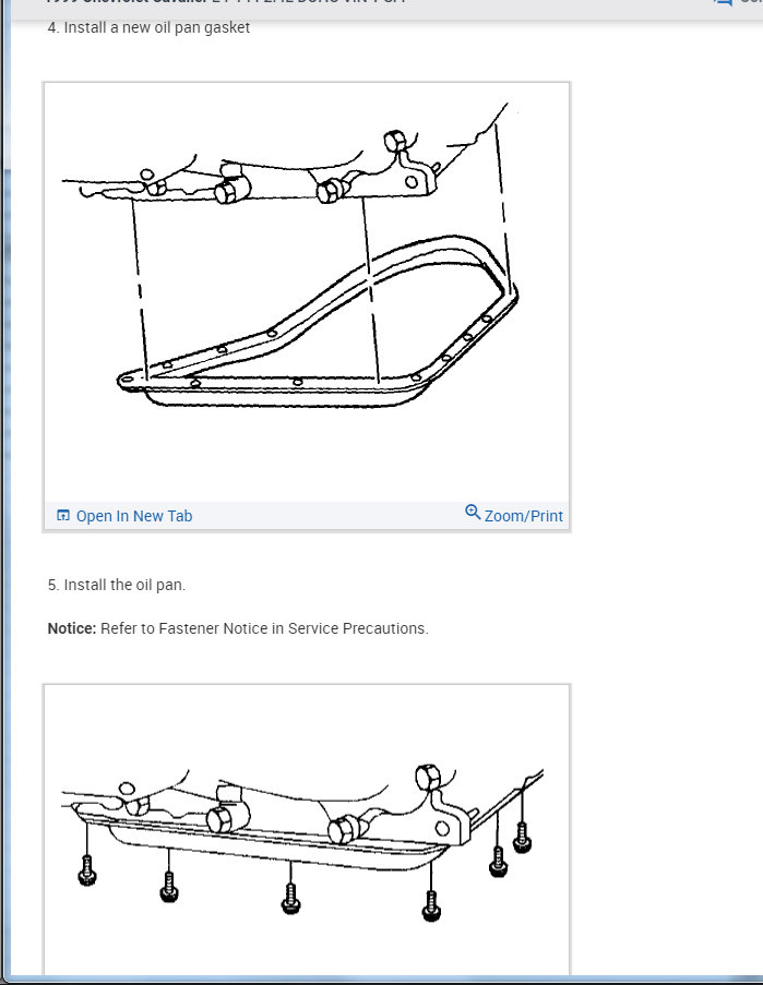

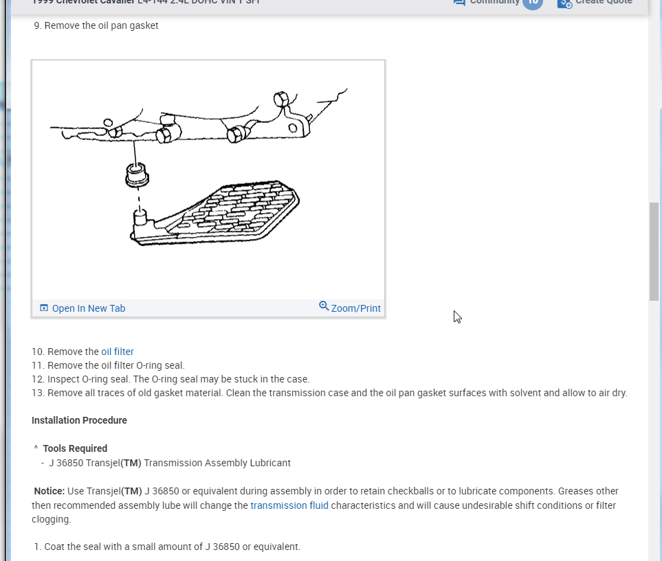

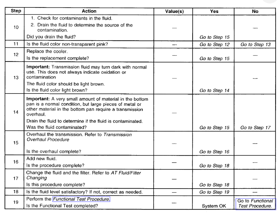

How many quarts of transmission fluid does it take to do.A filter and transmission change? How do I known when it is full?
Friday, June 26th, 2020 AT 8:11 AM
MECHANIC
18,907 POSTS
I have attached all the info for both transmission depending on which one you have. Either the 3T40 or the 4T40/45.
Please run through all this material and let us know if you have questions.
Here is a guide as well that talks about this in general terms. Thanks
