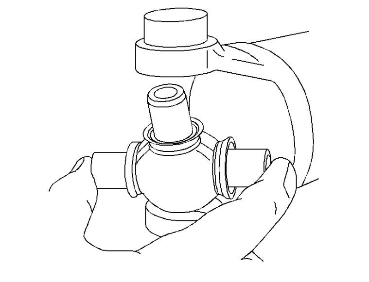

I would suspect the driveshaft universal joints maybe the noise if they are worn out and not lubricated.
https://www.2carpros.com/articles/how-u-joints-work
When they get tight or seized, they could make this noise. I would get them checked to be sure that they do not fail and leave you stranded.
