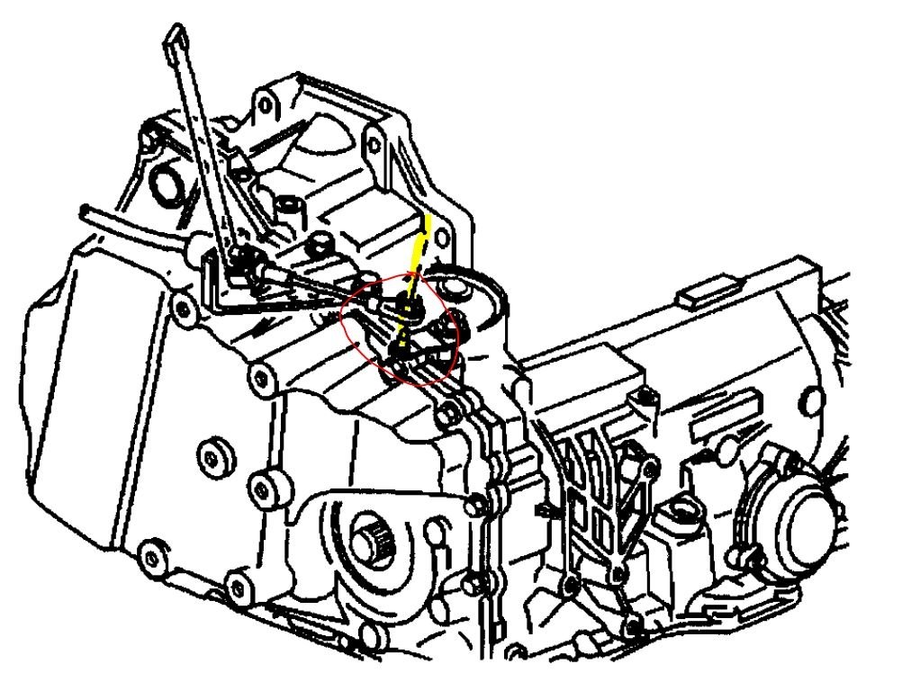

Car cranks shifts sounds good no problems other than the car will not move. I have changed out the exhaust gas recirculation (EGR) sensor it was making loud noise when put in park. I have gotten a neutral safety switch that I plan to change out tomorrow. My next step will be transmission control solenoid and maybe even thinking speed sensors. My car was stolen and wrecked but everything works and sounds perfect. No service engine light the only one was the code p0405 for the (EGR) so I fixed that. Car did not have any transmission problems in the past so I am just stunned at what in the world is going on. I did replace front dumper, back dumper, the side panel, the cluster, washer fluid reservoir, rotors and brake pads. Check all fluid had to add coolant and a little brake fluid but nothing is leaking. All plugs that I have inspected is plugged in. I have checked and changed fuses. Tomorrow I plan on getting closer up and personal with the transmission it self, but would really like to know what direction to go in.

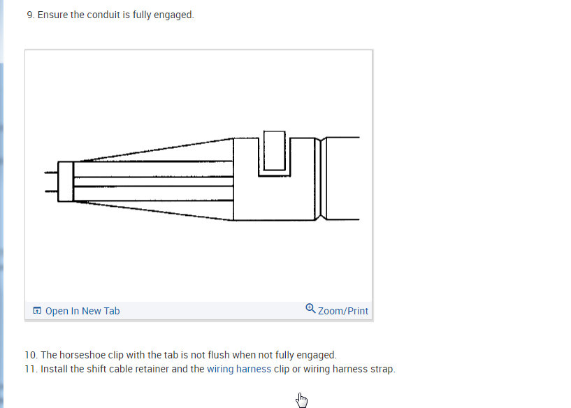

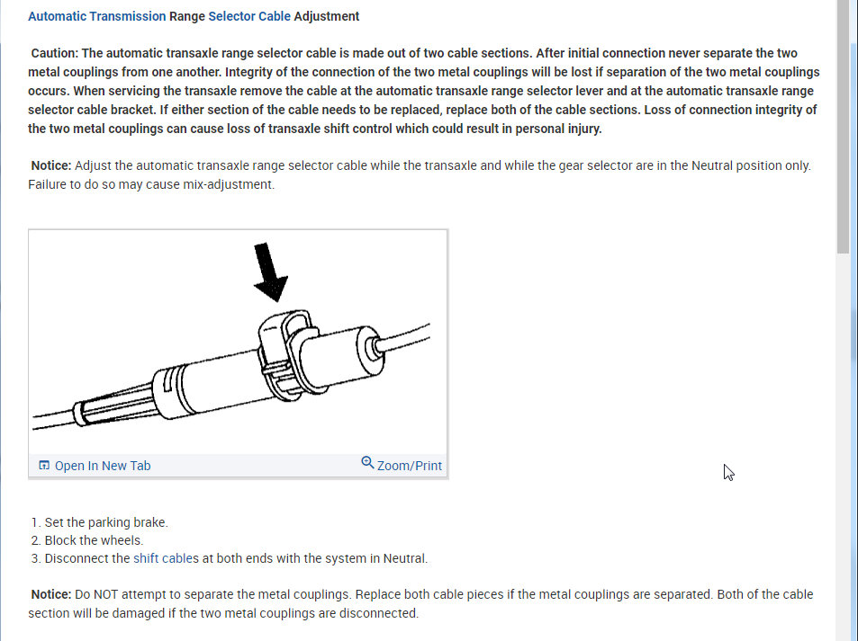

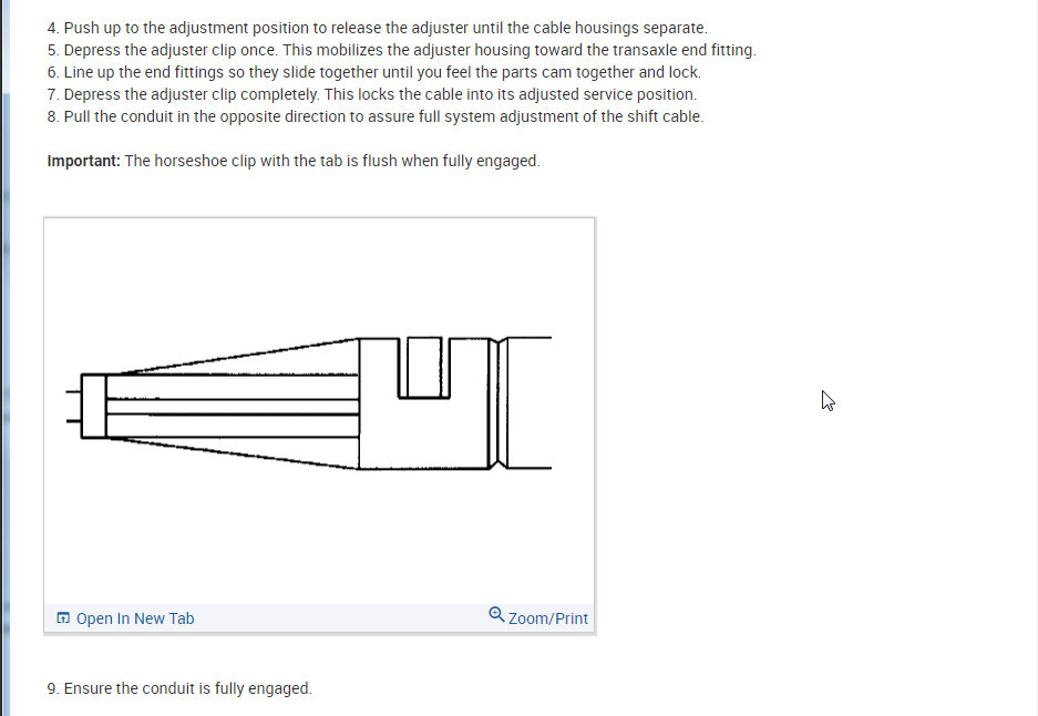

Any time we have a new or emerging transmission issue we want to start with the fluid. I see you checked it but what was the condition of it? Also, have you checked the linkage to make sure it is connected and adjusted properly.
I attached below the process to adjust it. I would suggest starting with this and go from there. Let us know what you find with this but if this all checks out then a solenoid issue would make sense.

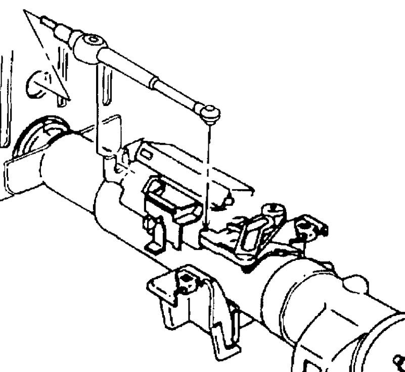

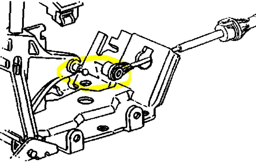

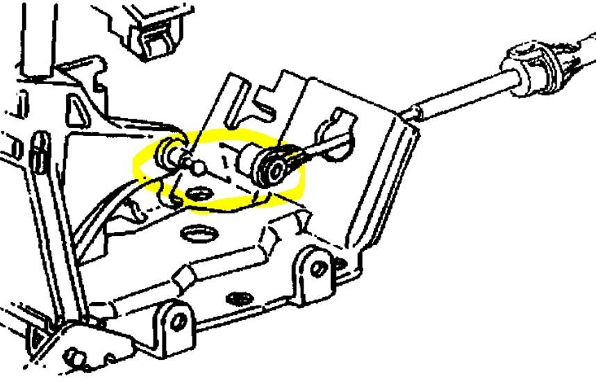

Okay, if you start the car and put it in gear does the engine sound change like the transmission is working or does it stay the same as if it was in park? How about if you shift into low, what does it do then? You say nothing moves in neutral? Is that all 4 tires or only the front drive tires you checked? Does the shift lever feel like it is moving the transmission selector itself. It's possible that the insert bushing in the shift cable failed or was damaged and the car isn't shifting out of park. Have someone watch the shift lever under the hood as you try to shift it inside the car. If it's not moving or the cable is off on either end then that is the issue.

Neither the solenoids or sensors would cause that issue. If I'm understanding you the car runs but when put in any gear the front drive tires don't move. Correct. But you can turn them by hand. When you turn one side by hand does the other side turn the opposite direction? If so it sounds like the transmission isn't coming out of park, that would point at the shift cable or the lever on the transmission not an internal problem unless the thieves did neutral drops with it and damaged the parking pawl. What does the engine do when you shift it into gear?

Okay, so you move the lever and nothing, does the lever seem to move easier than normal or anything like that. Can you have someone watch the lever on the transaxle while you shift it to make sure it's actually moving? As I said earlier, the cables on them have inserts that fail or pop off on the studs that they just snap on. Those are on both ends.

I watched the cable under the hood move while we switched gears.

But did the lever on the transmission move with it? If yes then I think you have an internal problem as the solenoids in that transmission are not the only items in control, it should still move even if they are all bad. In this case it sounds like there is another issue.

I would verify that the manual lever on the transmission moves. If it does and the car doesn't move then something internal to the transmission is bad and likely needs to be rebuilt. You say it was stolen and wrecked, did that happen prior to the transmission issue? Or was it recovered and now has it. If so I would bet they did something like shifting into reverse at speed or something like that and did internal damage that can only be repaired with a rebuild. What color is the fluid and does it have any glitter in it?
