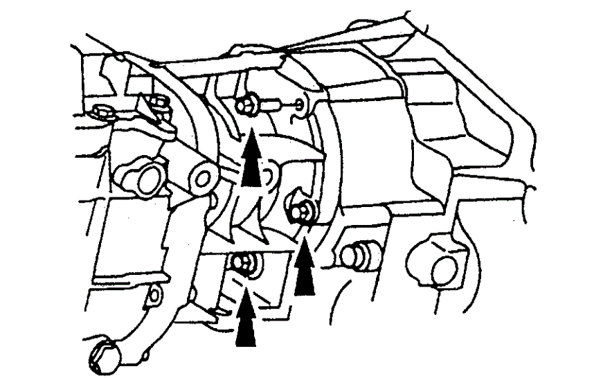

Do I have to drop the transfer case when taking out the transmission?

Good morning,
No, you do not but it would make it a lot easier for the procedure to drop it.
https://www.2carpros.com/articles/transmission-replacement-removal-manual
You would need a transmission jack that can support the combination to take it out together.
I posted a you tube video of removal of the transfer case for you.
https://www.youtube.com/watch?v=nki6EQw6zCQ

How do you remove the flywheel and torque converter bolts?
Wednesday, March 24th, 2021 AT 1:38 PM
  • 52,797 POSTS
There is a plate at the front most likely on the bottom of the housing. You can access them from there. Aside from the big mess you made leaving the converter in, once you remove the bolts for the converter and remove it, there will be 8 bolts for the flywheel.
If you pulled the transmission without disconnecting the torque converter, you most likely damaged the front seal. Make sure you replace it before installing it.
