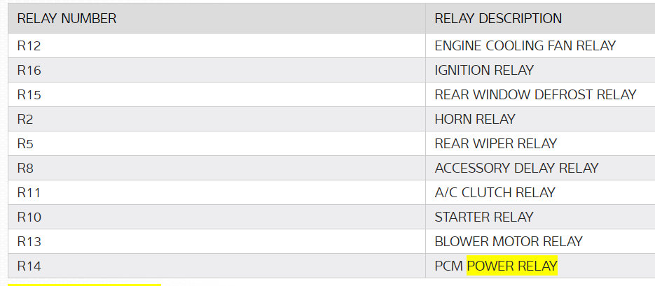

I have replaced the trans-axle solenoid body and it still shuts off. What would be next?

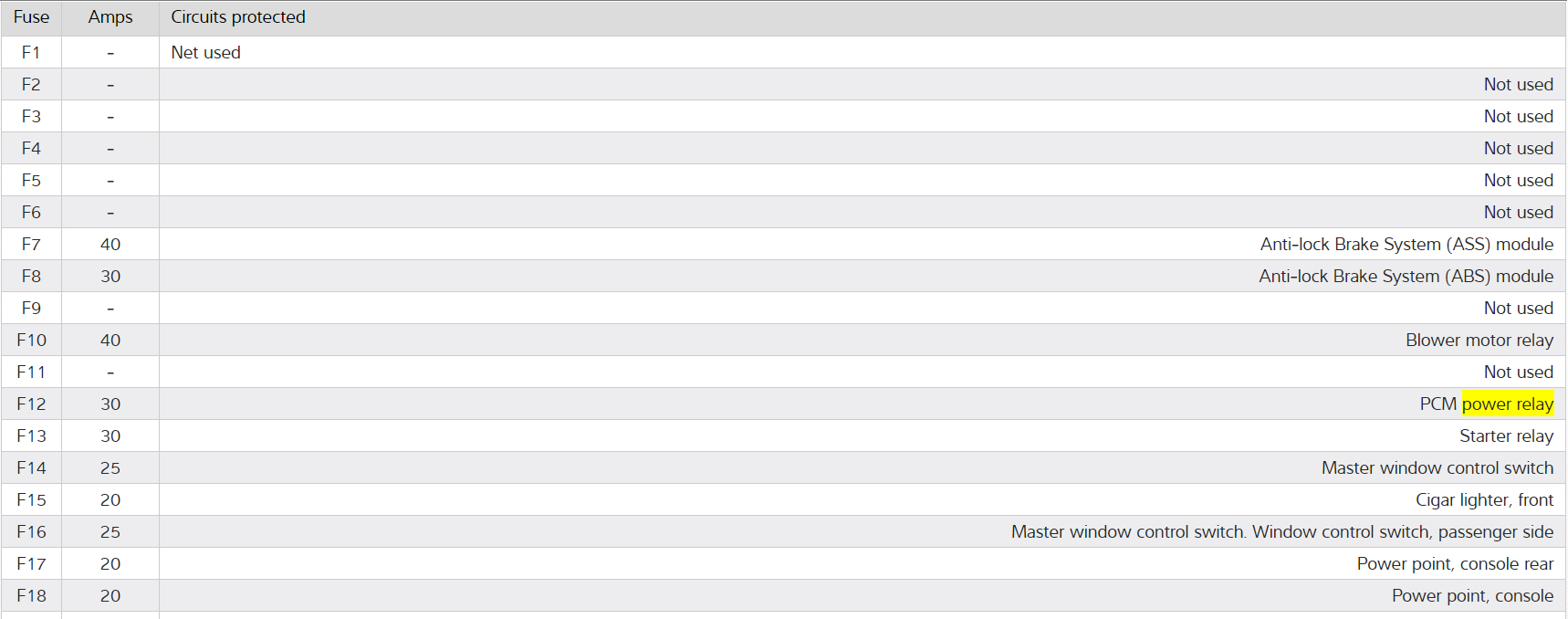

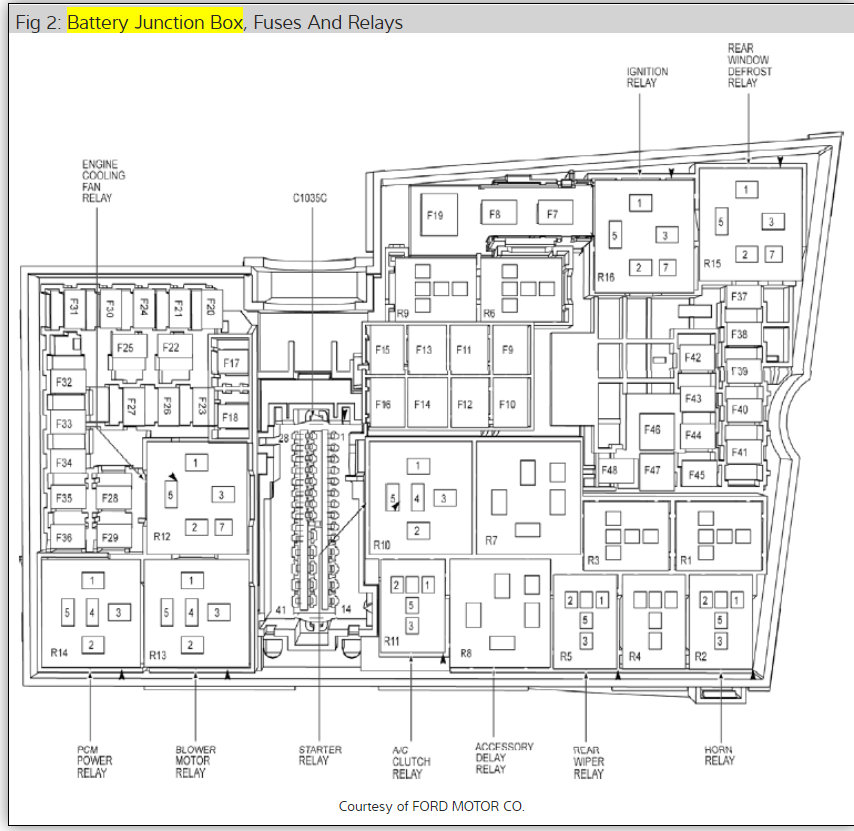

Got the encoder reading it is P068A. All fuses are good and all connections are tightly fastened in ECM circuit and harness.

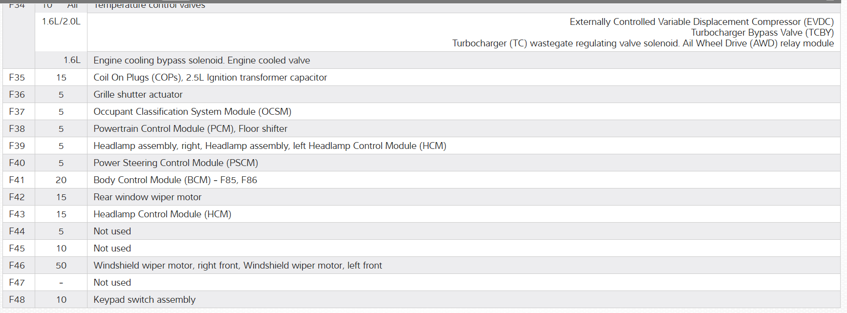

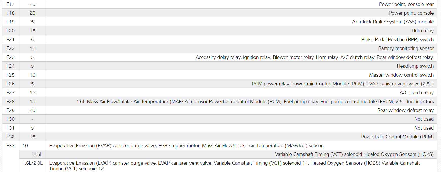

This code of for the PCM power relay. It sounds like it is bad but to be sure lets run down this guide to test the relay the location is below.
