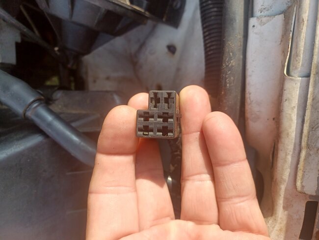

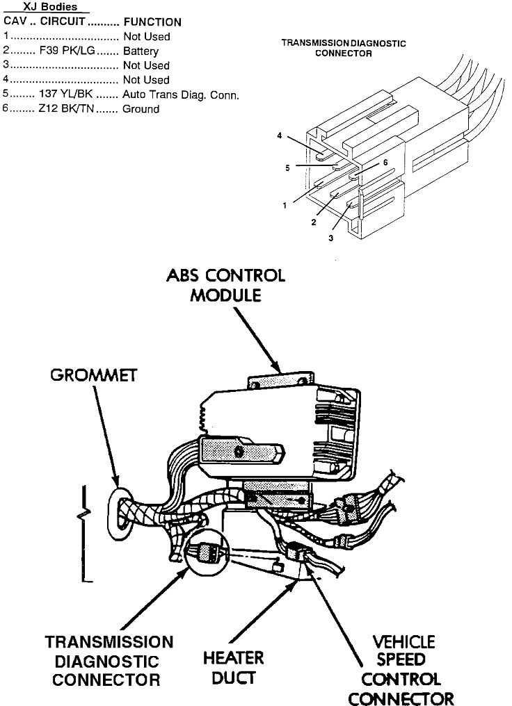

There is a kind of L shaped square connector behind the breath next to the computer under the hood. I thought that it was the odb1 connector. I can't get any readings from it. And on the bottom panel that runs along the bottom of the dash and the ashtray is a metal 16 pin module bolted to it. Is the TCM? I'll include some pictures when I get to work shortly.

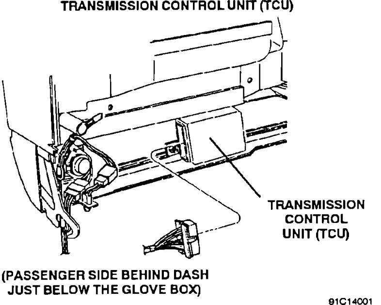

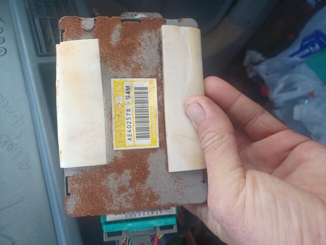

The first image is the TCM. Correct? And the second is the odb. Correct?

Yes, you do have the 4-speed transmission.

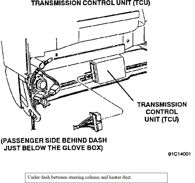

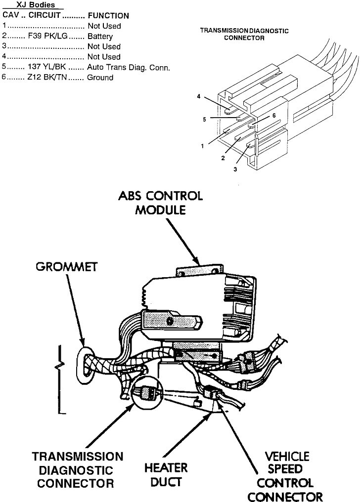

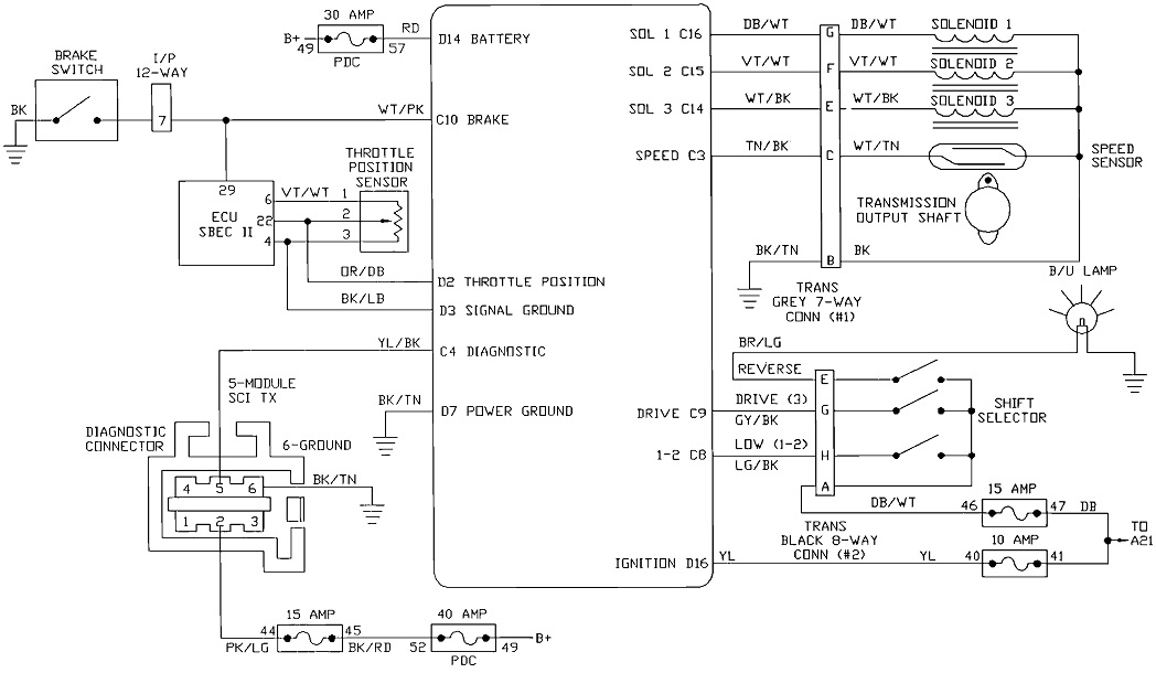

You're holding the DLC, (diagnostic link connector) for the Engine Computer. All other computers are accessed through the blue 6-pin connector, including Air Bag, Anti-Lock Brakes, and Body Computer. The shape of it is shown in the lower left of this diagram.
My experience has been with Chrysler and Dodge products. My dealership wasn't affiliated with Jeep, although I did get their training. In my effort to help out, I'm afraid I messed you up. I've always found ABS and Transmission Computers under the hood. In looking for the location of your Transmission Computer, I was surprised three times to find, first of all, you do have the Transmission Computer in your photo, it is inside the vehicle, and the ABS Computer is inside too. That places the 6-pin DLC right by the transmission hump where I would have looked first, not under the hood as I incorrectly told you earlier. I overlooked one important detail that I added to the third drawing. That's the notation at the bottom for the connector's location.

I went to the pull a part and got another TCM. Can you tell me how exactly to reset it or reprogram it for my Jeep?

Stuff it in and drive it. GM started giving us modules that needed to be programmed by the dealer in a few 2002 trucks, then everyone else copied that money-making ordeal later. For a '95 model, all of its learned data was erased when the battery cable was disconnected at the salvage yard. When you first turn on the ignition switch, that module will revert to its factory-programmed default settings, then update as soon as you start driving. Expect sluggish up-shifts or some minor engine runaway between shifts for the first two miles or dozen shift cycles while the relearn takes place. We were always told it could also start out with harsh up-shifts at first, but I never experienced that myself in ten years at the dealership.

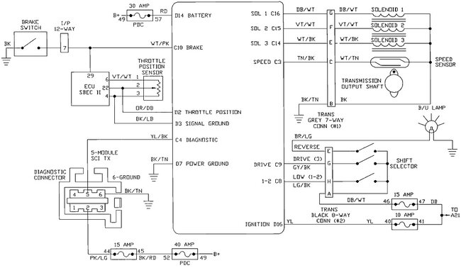

Chrysler was the first manufacturer to have this computer-controlled transmission design, starting with 1989 models. There are advantages and disadvantages to this design. The biggest benefit is if you look on a scanner, you can read the four values for "clutch volume index", (CVI). Those numbers are for the volume, in CCs, of fluid it takes to apply each of the four clutch packs. As the fiber plates wear down with each up-shift, they get a little thinner. With a half dozen of them in each clutch pack, that results in the need for a higher volume of fluid to squeeze them together to fully apply them. Years ago, as that occurred over 100,000 miles, we noticed a gradually increasing slippage when an up-shift occurred. It was just noticeable enough to let us know a rebuild was in the future, possible a few years from now.
That clutch plate wear is learned by your Transmission Computer. It calculates the volume of fluid it takes to fully apply each clutch pack. As that wear progresses and it takes more fluid, the computer will activate a shift solenoid / valve to engage the next gear, then wait a fraction of a second longer before it releases the previous gear. That eliminates the slipping or sluggish up-shifts. The goal is to cause every up-shift to be as nice and crisp as when the vehicle was new. The problem with this is there comes a time when there's so much wear, it can't update any further. If there's not enough fluid pressure on the plates, their friction can be overcome by engine torque, then slippage occurs.
In most cases the Transmission Computer looks at engine rpm from the crankshaft position sensor as "input speed", and it looks at a vehicle speed sensor, (VSS), in the back of the transmission as "output speed". It knows what output speed must be for a given input speed, for every gear the transmission is in. When one of those doesn't agree, it knows slippage is occurring in one of the multiple clutch packs currently engaged. It sets a diagnostic fault code for "incorrect gear ratio", or "gear ratio error", puts the system into "limp" mode, and since this will increase fuel consumption and therefore emissions, it tells the Engine Computer to turn on the Check Engine light. The Engine Computer will only have fault code P0700 set which just means there are other codes that need to be read in the Transmission Computer.
The only way to know wear has been taking place is to read those CVI numbers with a scanner. In fact, that's a good way to assess the condition of the transmission in a vehicle you're planning on buying. Other than that, the problem is one day the transmission shifts perfectly fine, and the next day it dumps into limp mode. You don't get the two or three years of sluggish shifts to warn you that wear is occurring.

If you do find a DRB2, be aware there are two different cables for it. One connects to the L-shaped square plug under the hood, for the Engine Computer. The one you need is for the smaller blue six-pin plug under the dash. That one is used for every other computer on the vehicle. If you find a newer aftermarket scanner, many of them use just one cable, but they have different connectors, (adapters), that plug into the end of it. You would need to find the one that matches that blue connector. Those adapters individually can usually be found on eBay for as little as ten bucks or less. I'm not promoting any brand, but I do have a Monitor 4000 that was made by the same company that made the DRB2 for Chrysler. It looks and works the same but for multiple brands. Also, you need a special cartridge and cable adapter for transmissions. I got that Chrysler transmission package included for free, which is why I bought it. I also have a Snapon Solus Edge, but for as much as most people would use it, you're better off going to a mechanic for things that need a scanner. Our other experts have scanners from a number of quality companies, but I don't have any experience with them.
