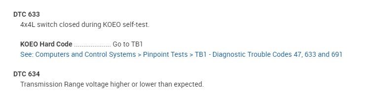

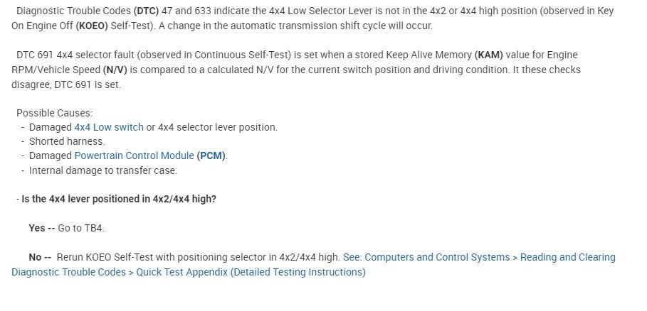

Truck has 633 code.
Sunday, January 5th, 2020 AT 7:39 PM
MECHANIC
52,796 POSTS
Good morning,
If you did a key on engine off test and the 4 wheel switch was in 4 wheel drive, that would set the code.
Redo the test with the switch in 2 wheel drive and see if the code is still present.
