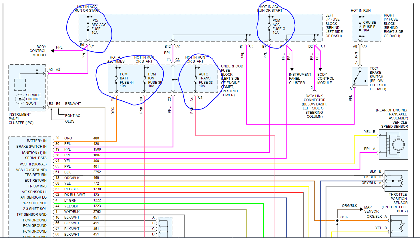

I am looking for the fuse for it.

I attached the wiring diagram for you to review. It shows the fuses for the transmission.
