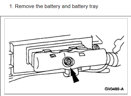

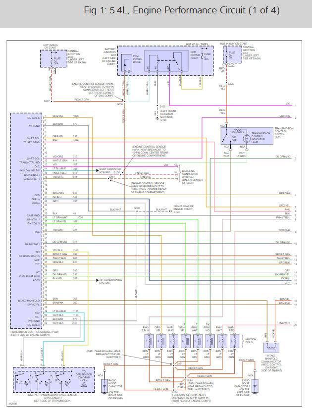

Codes p0708, p0743 and p0755. Truck had trouble taking off as if lack of power and does not shift gears. The original problem I had was that the transmission wiring harness melted to the exhaust. Wiring was repaired and is good again. I have replaced; TPS, transmission internal wire harness, transmission range sensor, torque converter clutch solenoid, and transmission shift solenoid. The only solenoid I have not replaced yet is the transmission pressure control solenoid that attaches to the transmission range sensor. Could that be the issue? Also, when the harness melted I was no longer able to start the truck via the key and had to bypass the key function to start the truck. Could this one solenoid be the cause of my problems?

Okay,

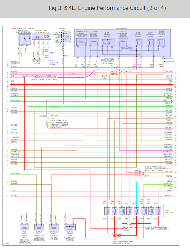

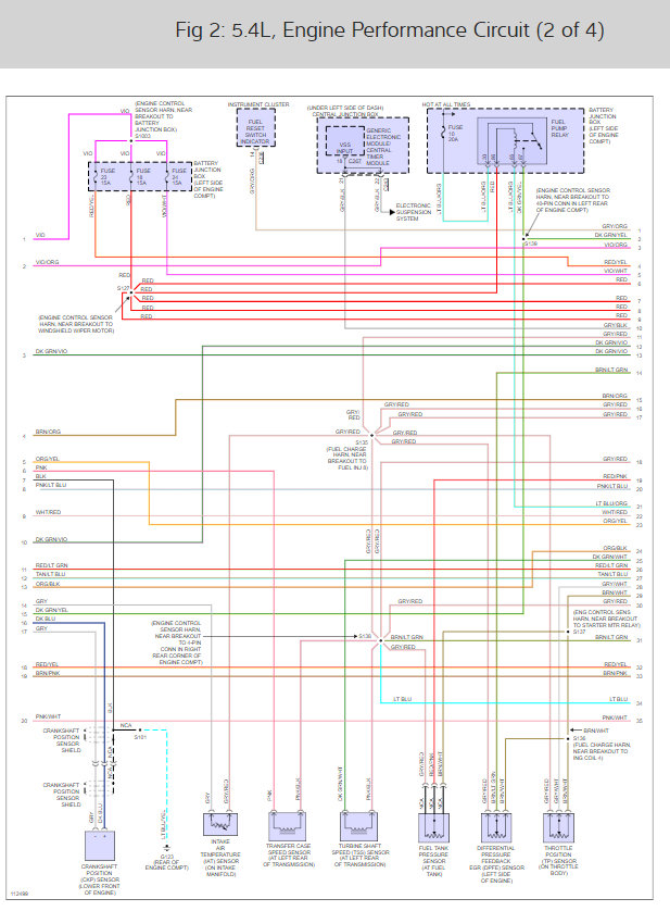

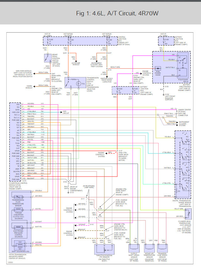

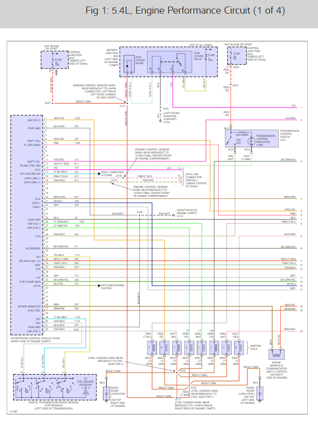

With three separate issues I would say the wiring needs to be checked to make sure everything is connecting the way it should.
Here is a wiring diagrams and guide to help you see whats going on:
Let me know what you find, Ken

Wiring is sound, no bad wires or terminals anymore. That was already checked and or replaced/repaired.

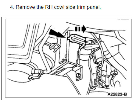

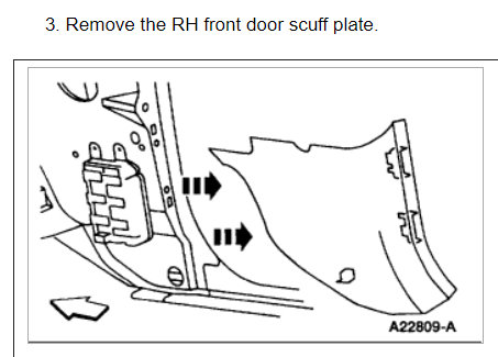

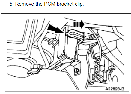

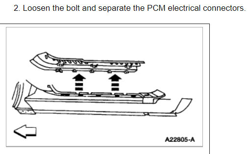

With all three codes being different issues and the wiring okay I think we are safe to say the PCM is out and needs to be replaced. Here is the location I would try a used one.

That is strange, when you click on the diagrams I sent you go to a website? The ad is close to the diagrams are you clicking on that? Next lets clear the codes and then just turn the key to the on position without starting the engine and then see what code comes up first.

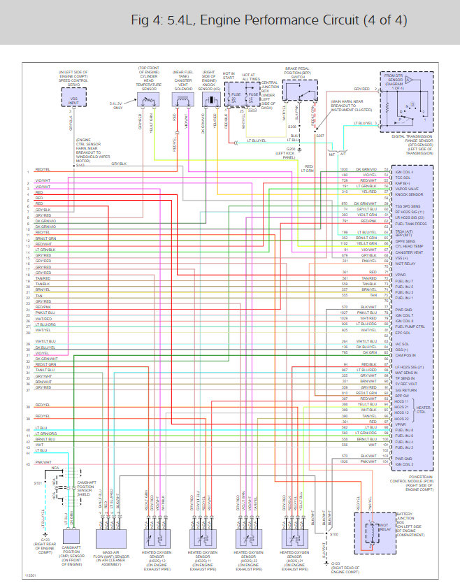

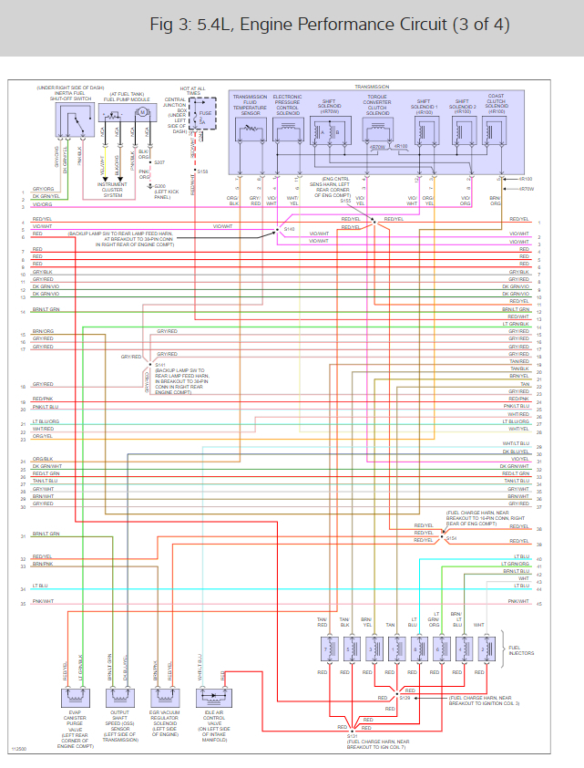

Have you checked the transmission valve body wiring connector? It sounds like you have a connection problem between the transmission and PCM here are the engine wiring diagrams as well.
Let me know if you need large versions of the engine wiring diagrams.

It seems as if the issue I'm having is that the power source/signal that crosses from the pressure solenoid to the remaining solenoids inside the transmission (4r70w) is not acting correctly, I've replaced the internal wire harness but the pressure solenoid is the only solenoid I have not replaced yet. All if the remaining electrical parts and or wires have been repaired or replaced.
