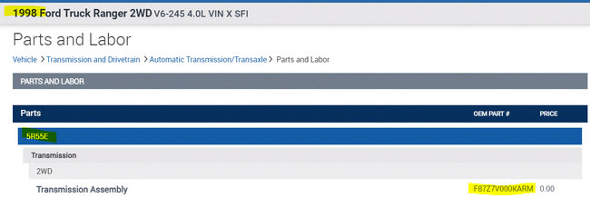

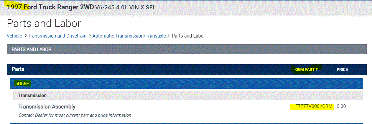

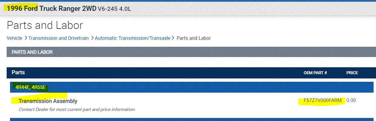

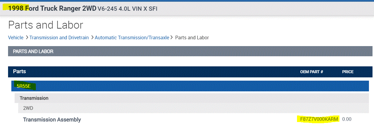

Since this is a 2wd, it should make it easier, but they constantly change things. For example, if you look at pic 1 below, it shows the OEM part number for the transmission used when it was new. Pic 2 is for the same vehicle but a 1996 and pic 3 shows the same vehicle but for a 1998. Note that all three are different.
So, if you have a specific year and model (for example a Ford Explorer, let me know I'll check it out for you.

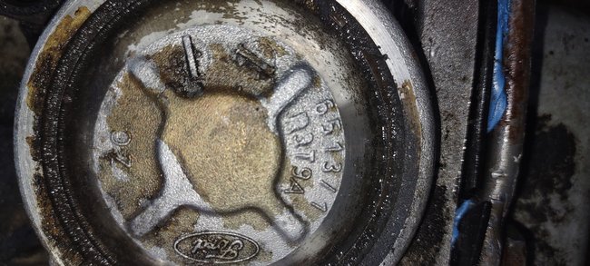

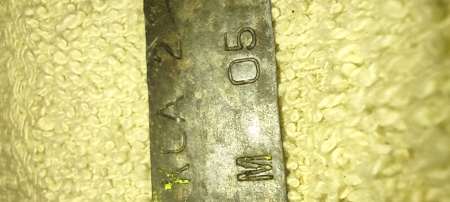

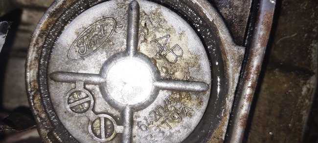

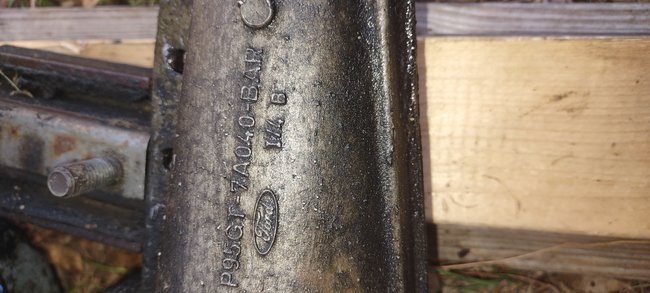

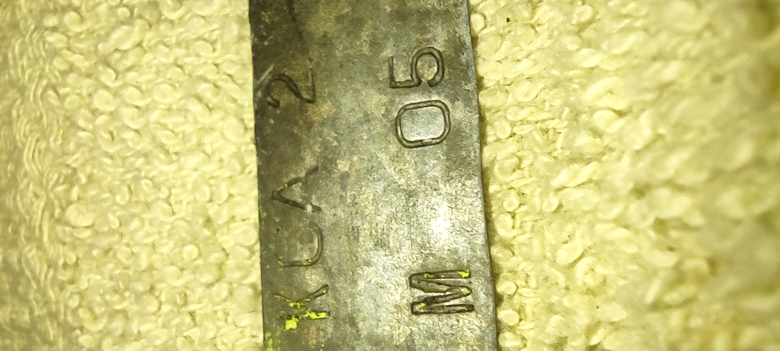

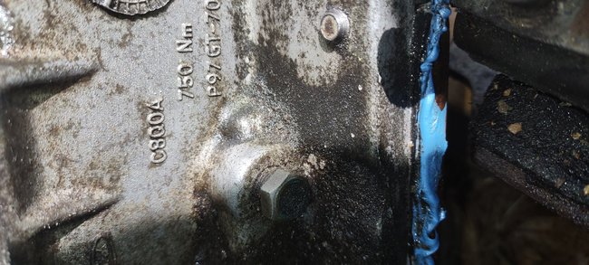

Here's the only numbers that are on the transmission out of my truck listed above XLT model.
Friday, April 1st, 2022 AT 1:58 PM
  • 110,192 POSTS
Based on the casting number, it is either a 4R44E. If you can get me a model year, I can now cross-reference it.

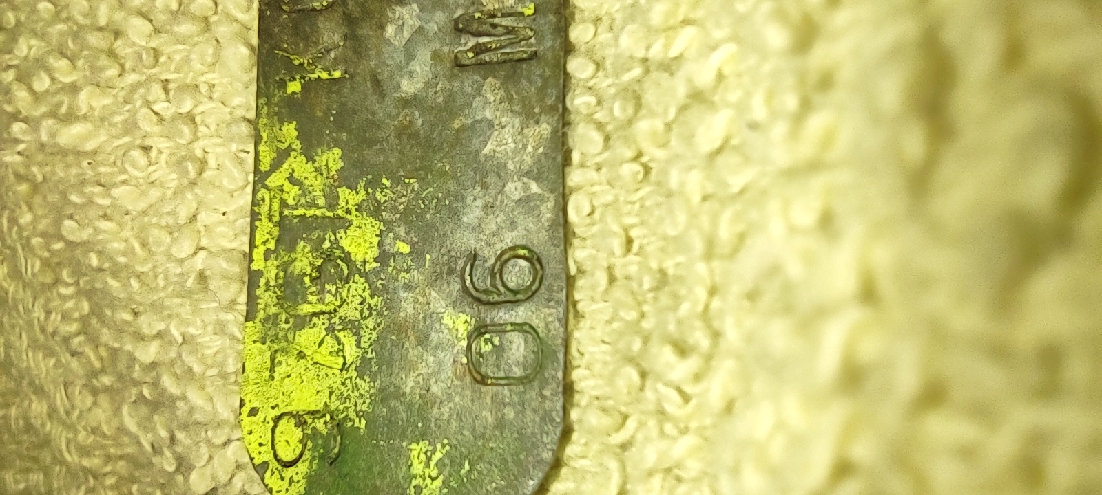

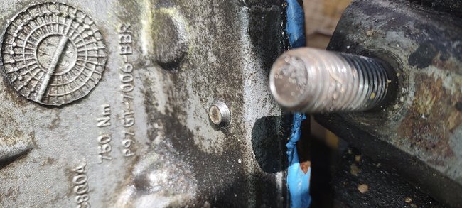

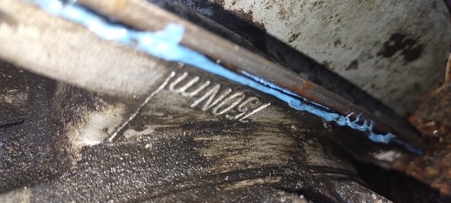

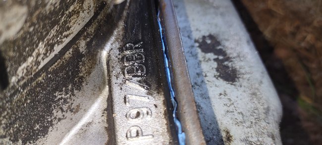

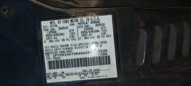

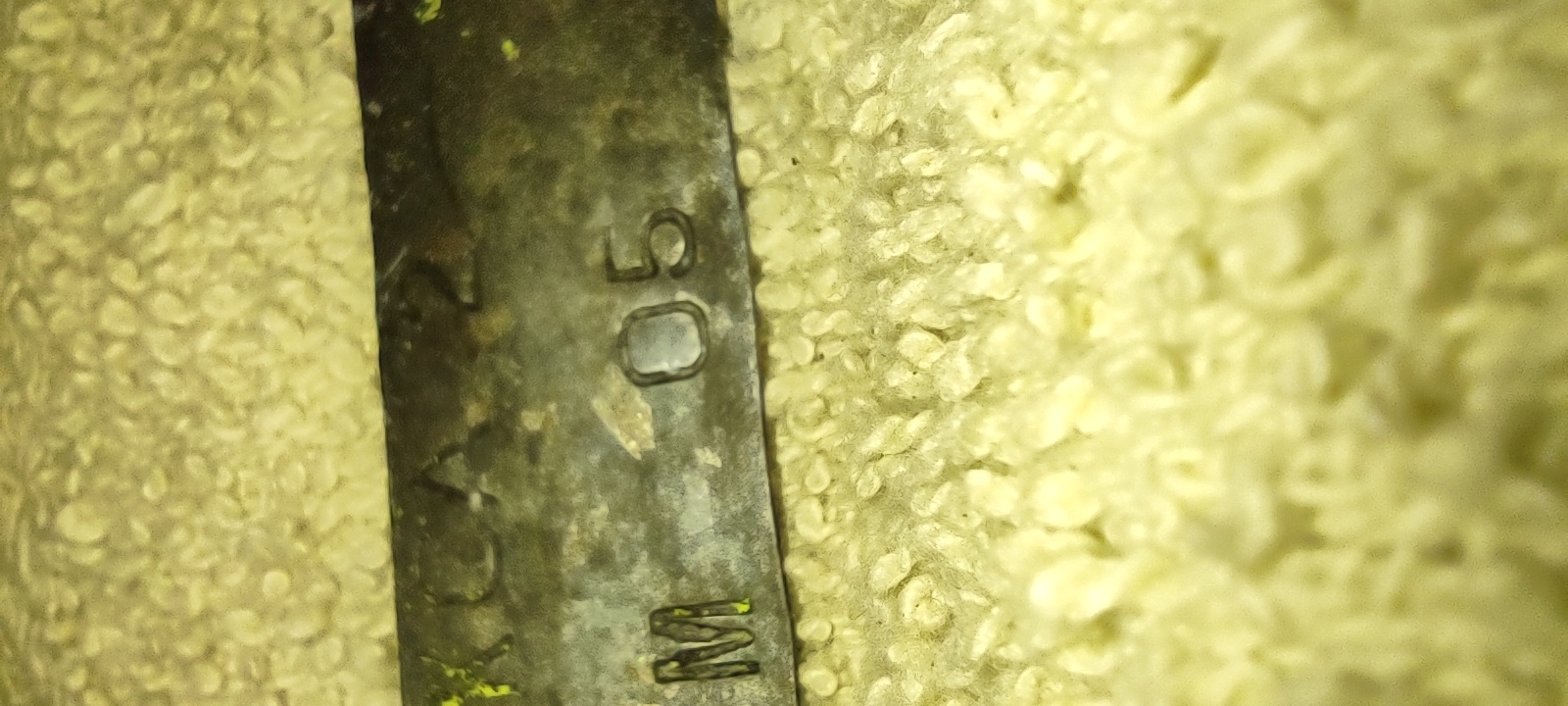

This is the VIN number for the truck and all the numbers off the transmission that I could find I went back out there and looked I don't know what year model transmission it is. I just need to know what year models will interchange with a 1997 Ford Ranger XLT 4.0 with overdrive sensor.
Friday, April 1st, 2022 AT 4:23 PM
  • 110,192 POSTS

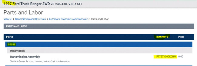

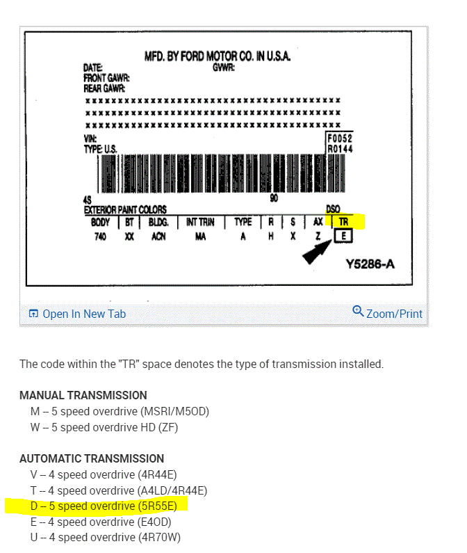

Actually, it is the 5R55E. See pics below.
If I recall, this transmission was only used behind the 4.0L for the following vehicles.
1997 Aerostar
1997-'03 Mazda B4000
1997-'01 Explorer
2002-'03 Sport and Sport Trac
1997-'03 Ranger
Please keep in mind, the aforementioned vehicles had optional engine sizes that would have used a different transmission. However, if you find one of them with the 4.0L, it should be the same transmission.
If you find one, let me know the specifics and I'll try to confirm fitment.
I hope this helps. Let me know if I can help.

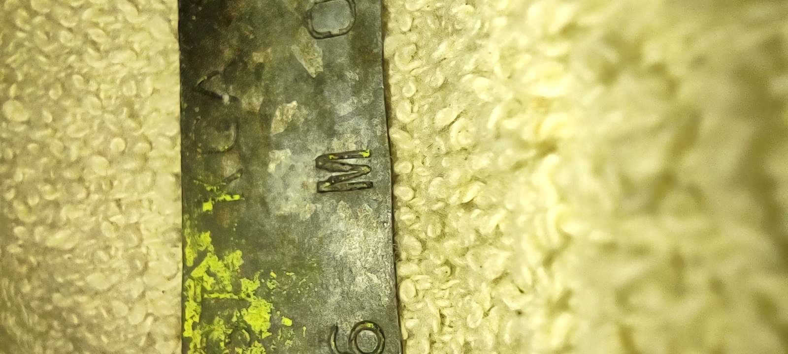

To be honest, I don't think that's the original transmission. I think it's done been changed once. Can you please let me know?
Saturday, April 2nd, 2022 AT 12:04 AM
  • 110,192 POSTS
Both the 4R44E and the 5R55E were used in the ranger. The 5R55E was used with the 4.0L engine. According to the label you sent me, the letter D indicates the truck originally came with the 5R55E. I did a little more digging, and it appears that the transmission case was used for both model transmissions.
Based on that, I feel that is the likely model transmission in the vehicle and what it came with. I hope that helps.
