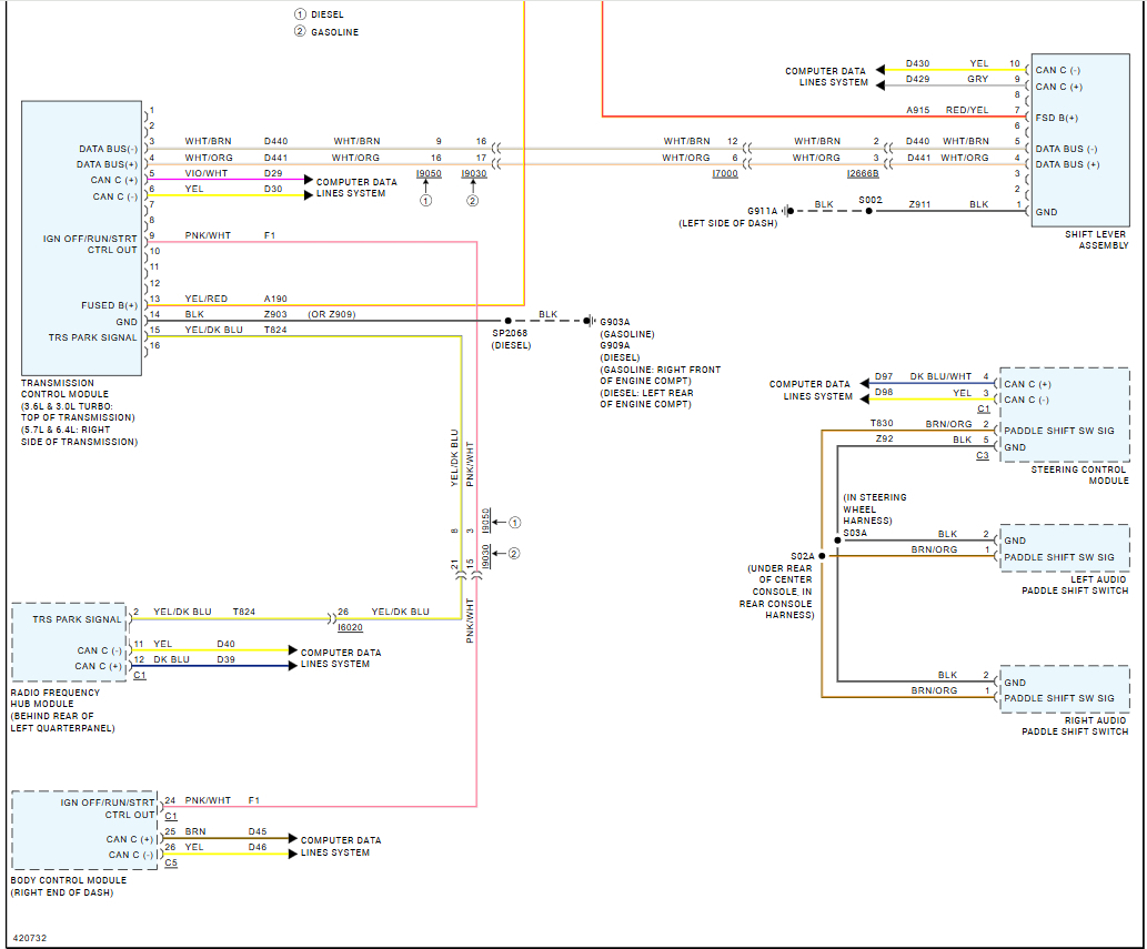

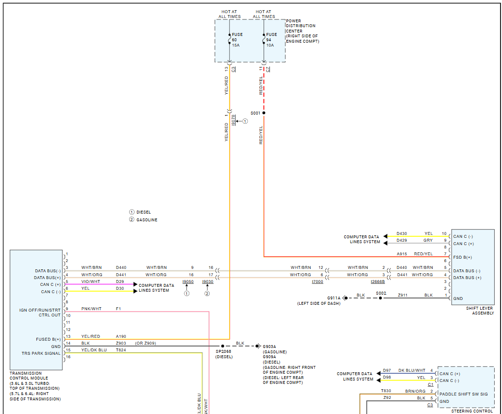

My 2014 Grand Cherokee Summit hasn't started for two weeks, and when I press the start button, the dashboard won't turn off. I think the transmission is disconnected or has an open circuit. Does anyone have a wiring diagram? It displays messages such as: (Vehicle Not in Park) (Until You Reach a Desired Location You May Not Be Able to Shift Again Until Serviced.) (Service Transmission Continue in D. Do Not Shift or Turn Engine Off)

and here is a guide to help you test the wiring with the transmissions wiring diagrams as requested.
I can tell you I have seen the shift lever sensor go out and cause this kind of issue. Check out the images (below). Please let us know what happens.

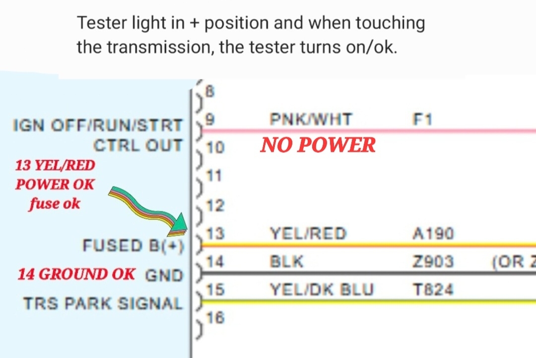

I have no power at pin #9, the pink wire with the white tracer (IGN OFF/RUN/STRT). I don't know where this wire ends because once it reaches the transmission it splits (Y) in the other direction. I don't know where to look, much less what to do. All the fuses and relays are fine. CODE = P1DCA / CODE = U0101

That wire goes to the BCM, but this is a signal wire that tells the module the car has been turned off so it might not have power or ground when testing.
Code P1DCA - Torque Request Signal from TCM Denied
Code U0101 - Lost Communication with TCM (Transmission Control Module)

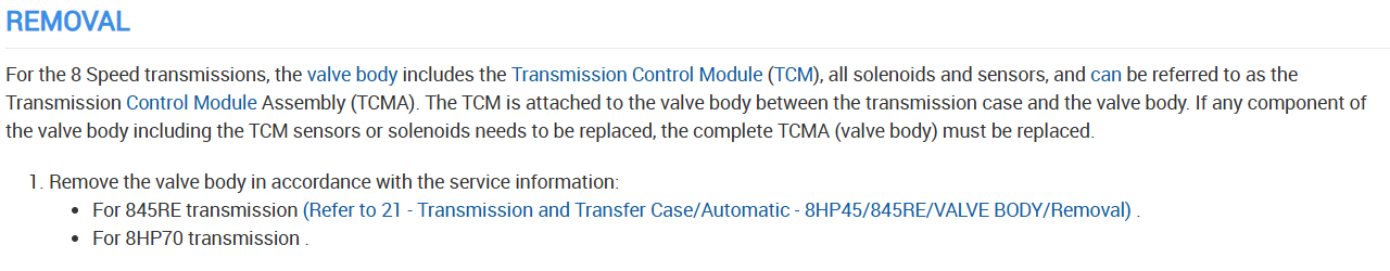

So it looks like you might have a bad TCM which is the valve body. I would remove it and get a rebuilt unit. Let us know how it goes

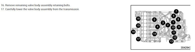

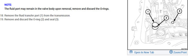

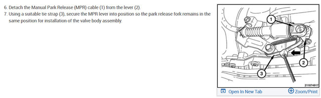

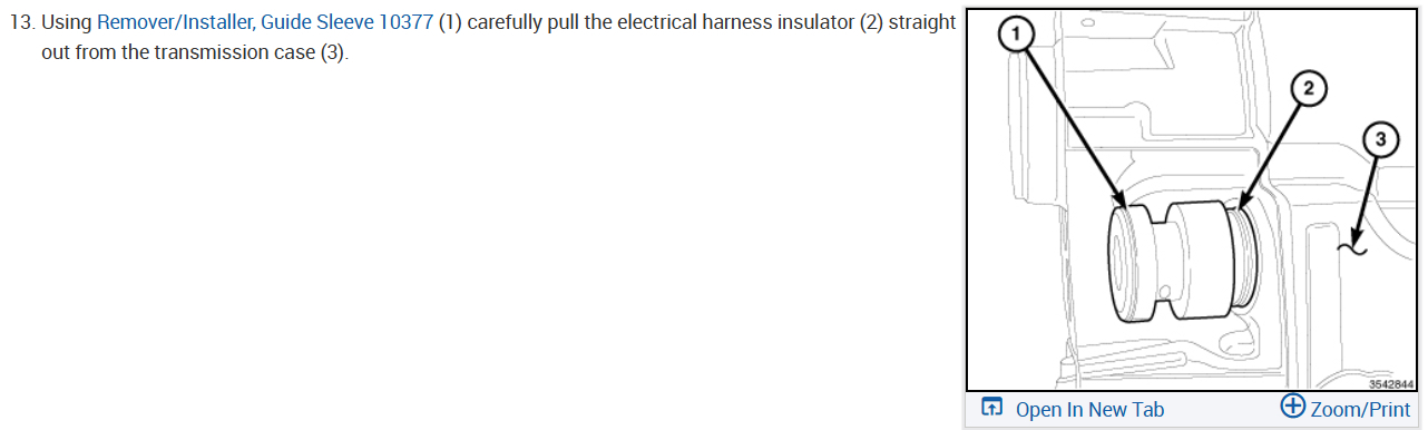

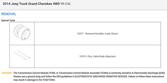

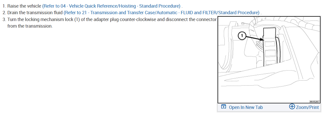

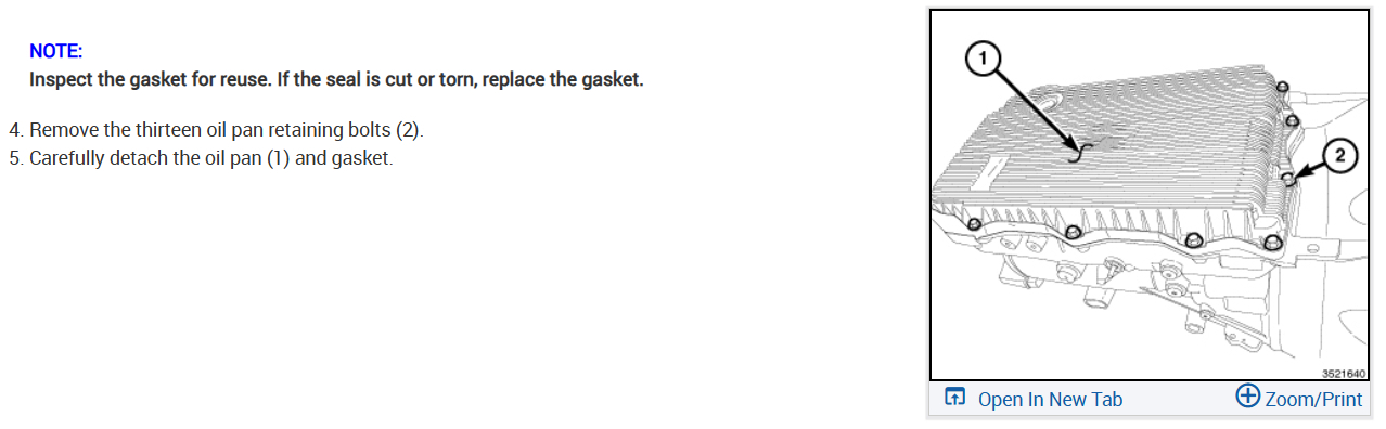

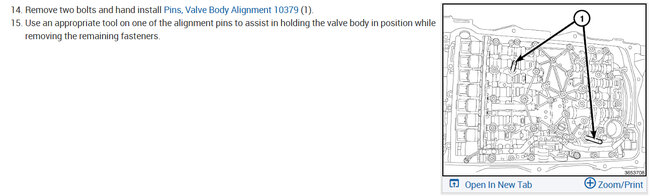

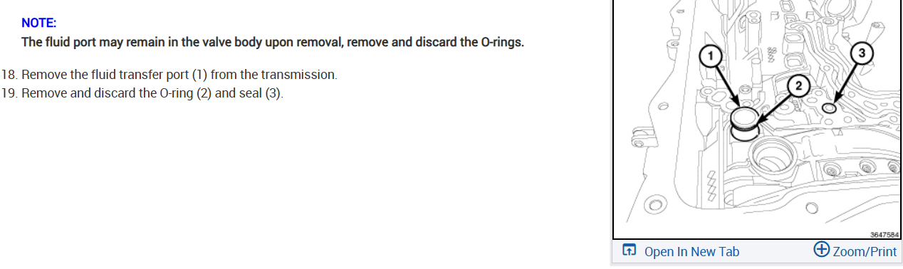

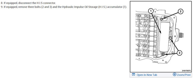

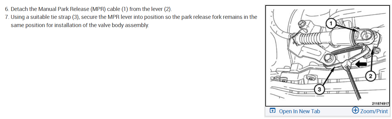

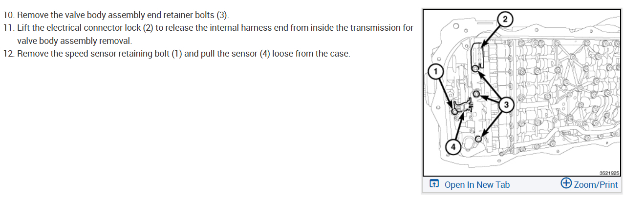

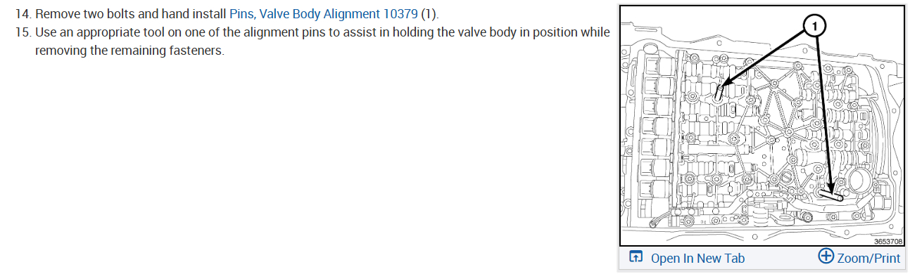

Sure, here is how to change out the valve body and TCM which is a common failure in these cars. Check out the images (below). Let us know what you find.
