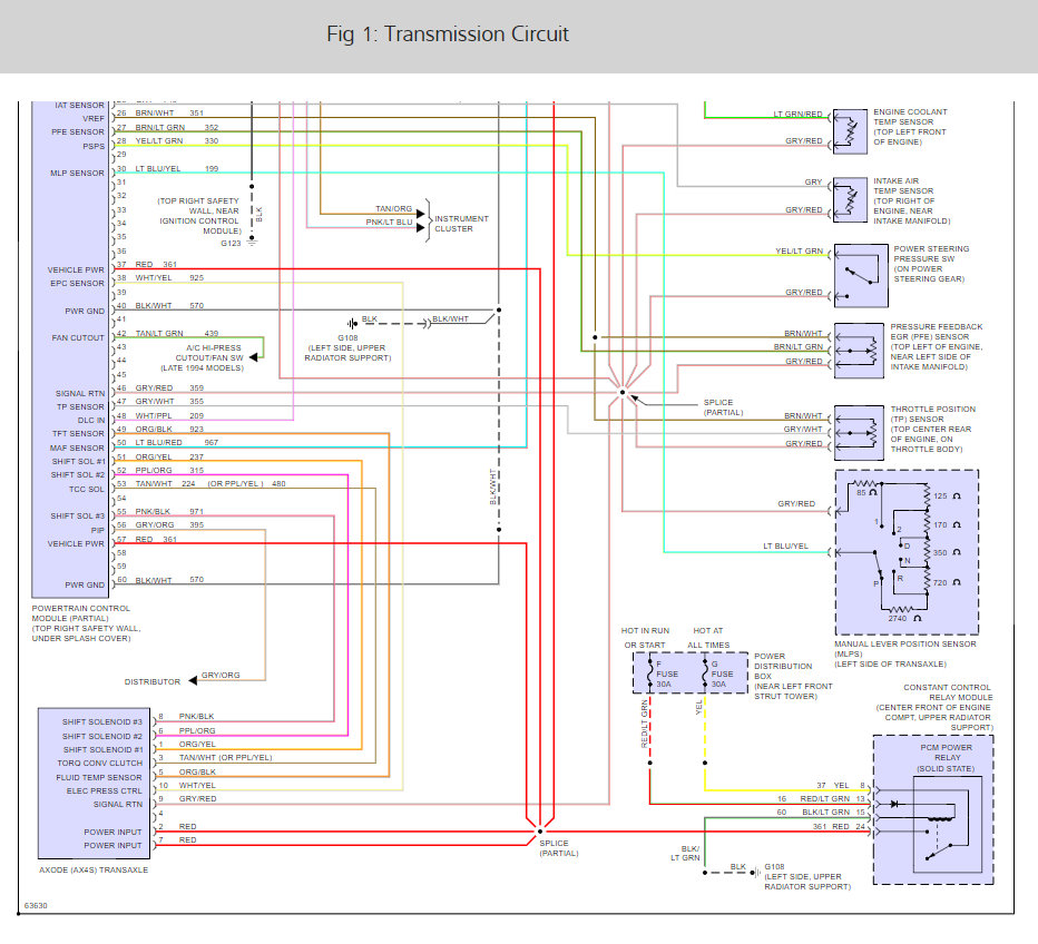

It does not shift into second or third, but the fluid looks good.
The oil stays clean between changes.
Saturday, November 11th, 2017 AT 4:19 PM
KEN L
MASTER CERTIFIED MECHANIC
55,535 POSTS

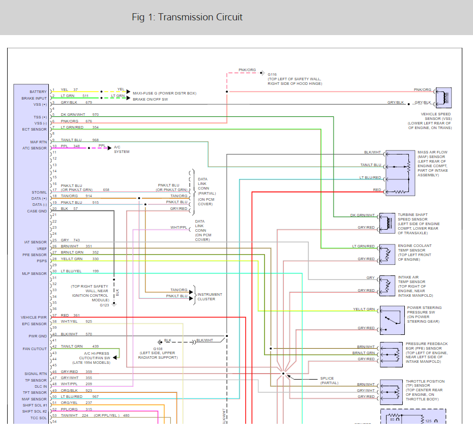

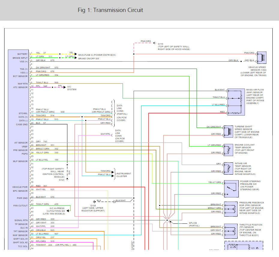

It sounds like you have a shift solenoid that is shorted out and not working.
Here is a guide to show you how to remove the pan so you can change the solenoid out:
It is the solenoid with the purple and orange wire.
You will need to lift the car up safely
