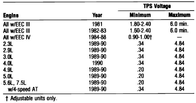

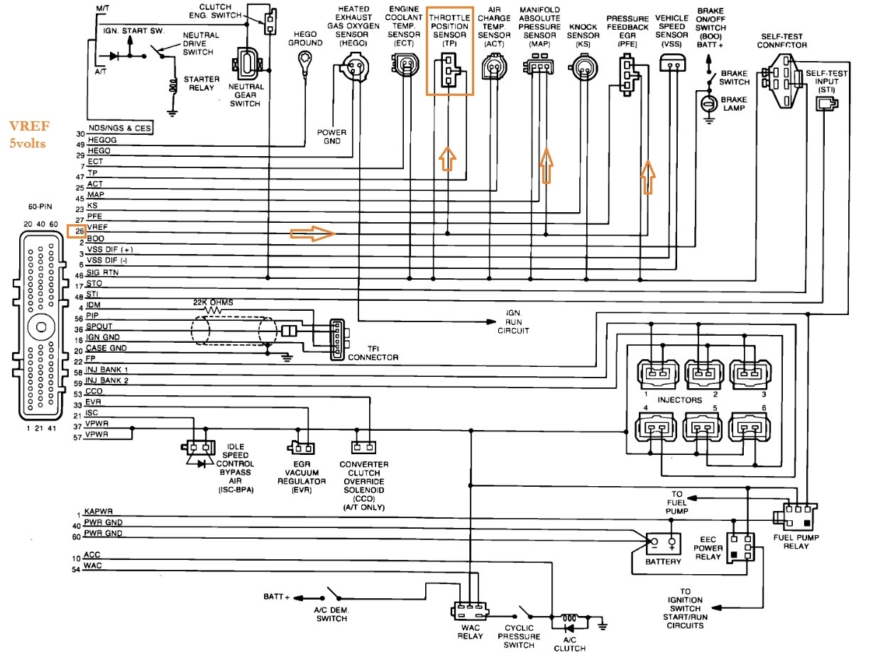

Hello, what voltage reading are you getting up to the OL reading? The TPS should have a 5volt reference wire, ground and signal. So, when opening the throttle plate the voltage reading should be either roughly around 0-5volts or the opposite, 5-0volts. I would check that there is a full 5volts on one of the wires with the key On. It is possible another sensor that uses the same 5volt reference is partially shorted to ground, causing this issue.
Jan 28, 2025 at 10:03 AM
87RANGER
  • 25 POSTS
With the key on the voltage is .8 and as I engage the throttle it goes up to 1.9 then reads ol. That's at approximately half throttle. While driving, with my foot on the accelerator there's a loss of power then it stalls and won't start again.
Jan 28, 2025 at 10:11 AM
AL514
  • 5,541 POSTS
Here is the wiring diagram for the engine wiring harness and the TPS min and max voltage readings. If you are reading almost 5 volts at half throttle it's possible one of the wires is shorted to a 12volt power supply causing a high voltage reading. Where are you getting the new sensors from?
Jan 28, 2025 at 10:14 AM
87RANGER
  • 25 POSTS

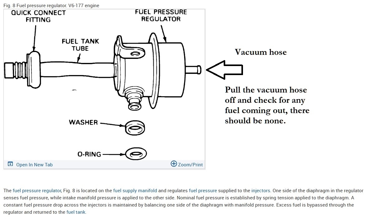

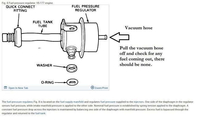

So you may have injectors leaking, or possibly a sensor not reading correctly and the PCM is over fueling. I would see what the front Oxygen sensor voltage is reading, with a multimeter you will only get the fastest average voltage the meter can read, but if you see the voltage stuck low (the front 02 should read a fluctuating 0.2-0.8volts), if its stuck below 0.4v the PCM will enrich the mixture constantly due to a false 02 reading, basically the PCM will think the mixture is lean and keep adding fuel to compensate for that issue. A bad coolant temperature sensor can do the same thing, if it's reading a cold engine constantly the PCM will keep the mixture rich, but I assume you are seeing a normal temperature reading on the cluster since you see it reach operating temperature.
Jan 28, 2025 at 10:57 AM
AL514
  • 5,541 POSTS
This would be something to observe on the live engine data of a scan tool, also check the fuel pressure regulator, there's a vacuum hose that goes to it from the intake manifold, check that no fuel comes out with the vacuum hose disconnected, if the regulator is bad it will pull fuel into the intake manifold through the regulator and the mixture will be extremely rich.

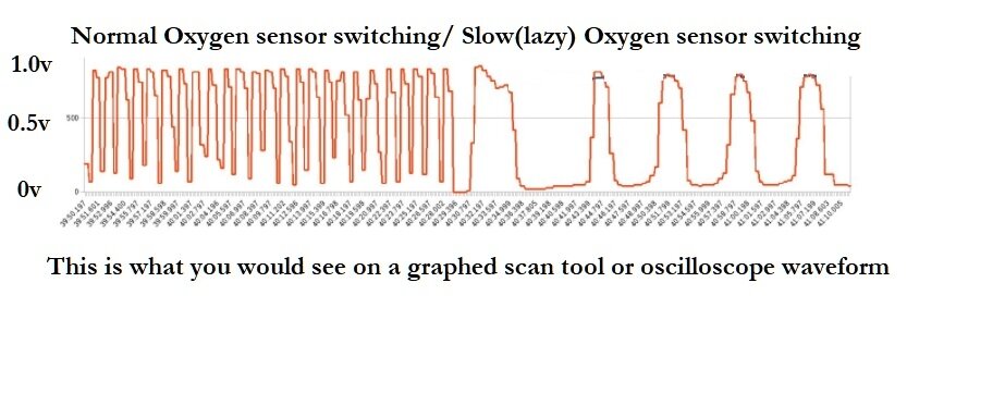

This is what you would see a normal oxygen sensor doing if you could observe the voltage fluctuation in real time. The first half is normal, and the second half is a slow responding sensor. But with a meter the signal is too fast so it will read the average as best it can. Here's a couple guides as well that may help. If the oxygen sensor were stuck at a low voltage due to the heater element inside the sensor not working or the sensor is just bad, the PCM would react by enriching the mixture.
But weak spark, low compression, or excessive fuel getting into the intake by some other means will cause fouled spark plugs with a lot of soot on them showing as a rich mixture as well.
https://www.2carpros.com/articles/how-to-test-an-oxygen-sensor-02-sensor
https://www.2carpros.com/articles/why-an-automotive-engine-will-run-rich

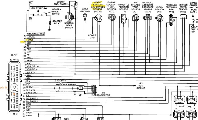

I got an obd1 scanner and I'm getting 2 codes. Cooling temp sensor and intake air charge temperature sensor out of range. So, I'm guessing the 38-year-old wiring harness may be to blame since the sensors look pretty new.
Jan 30, 2025 at 5:44 PM
AL514
  • 5,541 POSTS
Okay, both of those sensors use a 5v reference and also share a Ground. So start with unplugging either sensor and with the key On, check one of the 2 wires for 5volts, the other wire should be a sensor return (ground), when checking the 5volts you can use battery negative for the multimeter ground first to make sure the full 5volts is there, then use the other wire to verify ground. The meter should still read 5volts. Both of those sensors will affect the air/fuel ratio, especially the ECT.

So, for simplicity and clarity, the ECT signal wire from the sensor's two wire connector goes to ECM pin 7, the other wire goes to ECM pin 46 (SIG RTN- Gnd).
The Air Charge Temp Sensor's signal wire goes to ECM pin 25, and its other wire also goes to ECM pin 46 (SIG RTN-shared Gnd).
The purpose of disconnecting the ECM connector and each sensor's connectors is to isolate each wire, so you measured from the ECT signal wire to ECM pin 7 with the sensor disconnected and the ECM disconnected and got 85 ohms, if that's the case then there is high resistance on the ECT signal wire going to ECM pin 7,
But these wiring diagrams don't show any possible connectors in between the sensors and ECM, so you will have to note the wire color and try to follow it as best as possible. My diagram below also shows how to check each wire for a short to ground, but also not knowing the wiring harness's routing, makes it a bit more difficult. Most of the time a sensor Ground like this will be a direct wire to the ECM, so not grounding to the engine block first like many other grounds are done. This is to preserve the sensors signal quality. The high resistance can be and is most likely corrosion somewhere in the circuit. ie inside a connector or even a pin hole in a wire can cause it to corrode inside and it just grows right inside the wire insulation. This usually causes the insulation to discolor in places but can be difficult to spot.
You'll have to excuse my artwork below, but this should help simplify testing. Let me know what else you find, I apologize if you need to retest, it's not always easy to explain circuit testing. The method I would use is even more difficult with load testing a wire, but stick to resistance testing for now, since it sounds like you're onto a wiring issue here.
