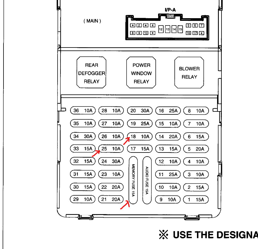

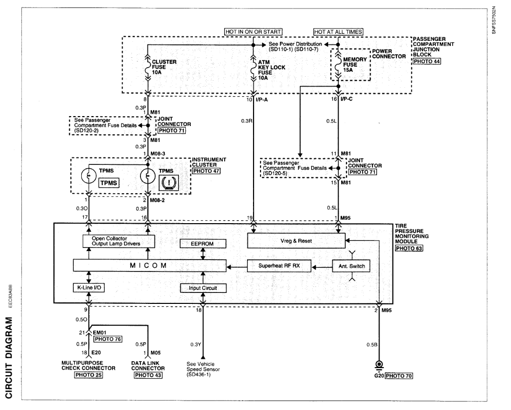

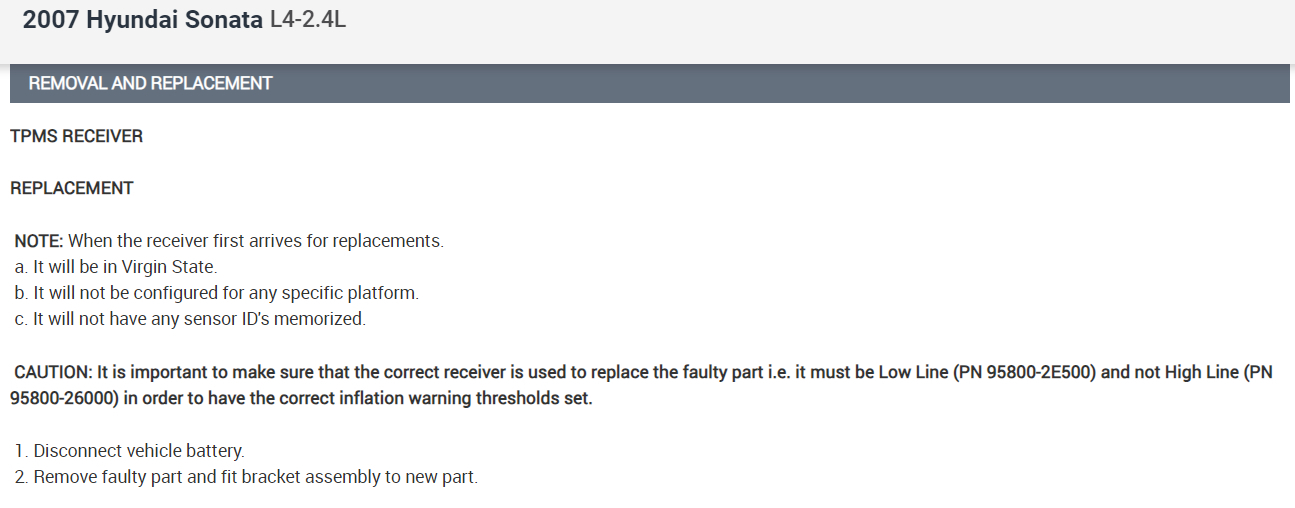

Hello Car Pros,
My tire pressure sensors are not communicating with the TPMS module.
Sensors are sending signals.

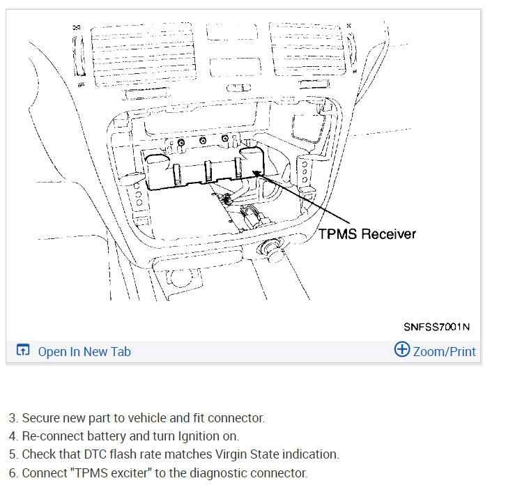

Should i replace the TPMS module?

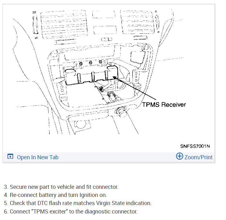

I can't find the location of the module.
if there is a reset button. Where?
Diagrams would be helpful.
thanks,
Robert

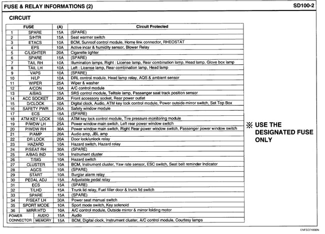

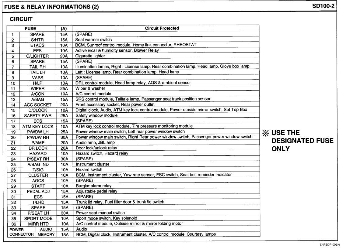

Hi Robert,
I would try a hard system reboot fuse and check the three fuses in the inside fuse panel which I have included in the diagrams below. If okay, here is the location of the TPMS control module so you can check it out.
https://www.2carpros.com/articles/step-by-step-guide-performing-a-hard-system-reboot-for-your-vehicles-electronics-systems
and
Check out the images (below). Let us know how it goes.
