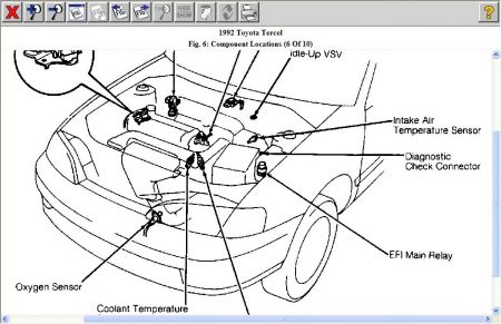

Trying to find out were to hook dlc data link connector I look under steerwheel and pull ashtray out I saw the computer box but I didn;t see the connector

Hi pompys1 and welcome to 2carpros
The diagnostic check connector see below for location-its on the side of the engine compartment fuse/ relay block no.2
https://www.2carpros.com/forum/automotive_pictures/12900_dcc_1.jpg
