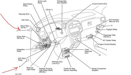

Check the earths as indicated, this pic may help locate them, it is the best that Mitchel 1 has.

What are the 2 red arrows pointing to? The connections are labeled what numbers? I noticed a connection under the hood near the air cleaner box which is bolted to the side of the van (inner fender) and grounded.
Wednesday, June 30th, 2010 AT 4:15 PM
MHPAUTOS
  • 31,937 POSTS
The arrow is indicating the vehicle earth points, there is no indication in Mitchell 1 as to where the exact earth point is, short of purchasing a factory manual I can't pin point the earth points any closer than this, a trained tech will see this diagram and have the ability to look at the car first hand and locate the earths looking at the loom, I can't be your eyes for this part, earths are normally a group of terminals if you follow the loom it will be apparent, when located you have the colour codes to start doing what jack has suggested.

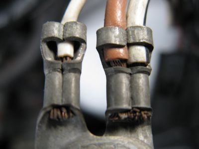

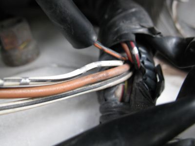

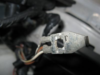

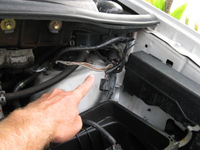

I found the ground(earth). It is the upper right corner by the air cleaner box. I unbolted the wire from the fender and read from the data link connector to the terminal where the three wires meet and the brown one seems to have continuity but high resistance. here are some photos to help us out............

Any ideas what to do with the brown wire?
Friday, July 2nd, 2010 AT 12:21 PM
2CARPRO JACK
  • 11,533 POSTS
Judging by the diagram I posted before, teh brown is to the key amp and the wire from the data link connector is brown/white. Im know it is a few bucks, but you may want to consider getting a sub for a day and printing out all the wiring diagrams so you can see all of what we are dealing with as far as grounds go.I dont see anything beyond a bad firewall connection/bad wire that would make that ckt have such high resistance

MHPAUTOS
  • 31,937 POSTS
Key readers or amplifiers are normally next to the key barrel, see pic I posted with the arrows, it shows the key amp in the steering column near where the key would be.

Well, I took the brown and white wire on the back of the data link connection and soldered a same size if not slightley larger wire to it and grounded it out permanently. The van starts up and runs perfectly and the new spliced in wire does not get hot at all or too warm so that I cannot touch it at all. So by me grounding that brown/white wire the van is fine. I looked at my ignition switch and the mitchell manual and according to where the mitchel manual says that the key transponder is my van does not have one. I double checked and iit does not have a key transponder. So, what did I do by grounding out the brown/white wire? That is the question now. I still want to know
Monday, July 5th, 2010 AT 7:06 PM
MHPAUTOS
  • 31,937 POSTS
I would say that if you have replaced that earth wire and all is OK, it is not so much a matter of making the earth sound, I would say that in the loom the earth wire and a power supply or signal wire have breached causing the high resistance and all the problems, the new sound earth should be proof enough that this is the case, I would terminate the faulty wire at the chassis earth and just run a new permanent earth.
