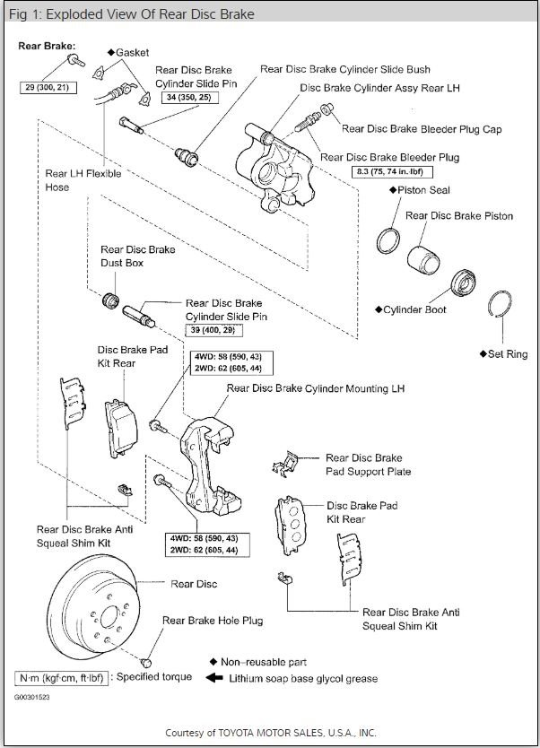

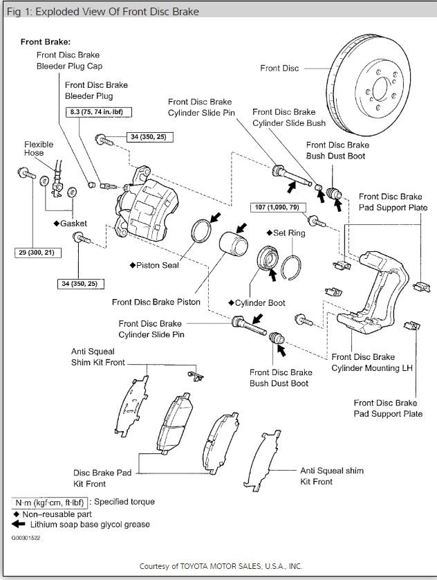

How do I remove the front and rear rotors on a my car
Thursday, February 12th, 2009 AT 7:26 AM
13 Replies
MMPRINCE4000
  • 8,548 POSTS
Remove wheel, caliper (hang it out of way with wire, do not let it hang by hose) and caliper bracket bolted to knuckle.
Some rotors are held in place with small clips on wheel stud, if so then remove them (they do not have to be replaced).
Rotor should pull off, but sometimes can be rusted in place, so you may have to use a penetrating oil and RUBBER hammer to dislodge.
See the guides below on front and rear brake replacement, they will help
https://www.2carpros.com/articles/how-to-replace-rear-brake-pads-and-rotors
Below are the diagrams for your front and rear brakes

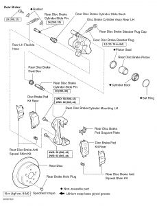

Is there any trick to removing the rear rotors from the Toyota Highlander? I removed all of the brake hardware(Calipers, carrier) but the rotor will not come off. It does not have a disk rotor screw and there is no nut on the axle. I even tapped it with a rubber hammer and still no luck. Any suggestions?
The car is a 2003 Toyota Highlander Limited with 97,000 miles. It is 2 wheel drive and has a V6 engine.
Thanks
+1
Wednesday, October 24th, 2018 AT 5:54 PM (Merged)
2CARPRO JACK
  • 11,533 POSTS
Toyota usually has 2 threaded holes on the face of the rotor. Screw 2 bolts into them and tighten evenly, should press it off
+1
MDILLARD
Thank you. This worked perfectly
