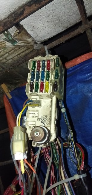

Before I put on a new pump it starts with starter fluid and stay running til you off it for about 2 hours then wont start until I use starter fluid again.
On the new fuel pump this time it's stalling when get to stop sign but starts right up-nightmare problem. What do you think it is? Perhaps an EFI relay/Circuit Opening Relay all the fuses checks out, with the fuel system its like I'm losing connections somewhere.
Trying to get a fuel pump gauge but hard with this Covid-19 give me a guess for the time being what can be wrong. Thank you.

I need wiring back fuse relay block junction how to read wiring colour & pin diagram directions tq

Based on that info, I would still think it is the fuel pump and here is why. Before you replaced it, you had to use starter fluid to get it started and then it ran fine until the pressure bled off. Then use starter fluid again and it runs again. This shows that the pump just didn't have the ability to build the needed pressure but one it had the pressure it ran fine. This also, shows that everything else in the system was working as it should as well.
Now that you have the new pump, it starts but shuts off. Almost like it can build the pressure but does not continue to run. You didn't have this issue before so unless something else just happened to fail, I would blame the new pump as it was the only thing changed when the issue changed.
Does that make sense? Clearly it could be wrong if we are missing something but if this is what we have to go on, that is all that makes sense to me.

KaseKenny1, we need to hold up on the fuel pump issue, I've lost spark. Now I need to find what cause it not to spark. I will be with you when I get the issue fixed. Once again thank you. See you
Tuesday, August 11th, 2020 AT 4:21 PM (Merged)
Sounds great. I understand. If you need some help with that issue, let's get a new post started on it and we will jump on it with you. Thanks
