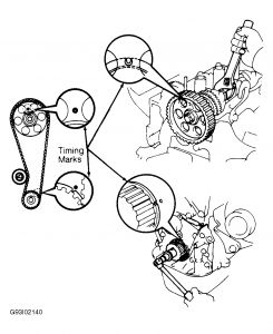

THEBUZZER81
where is the location of the crankshaft timing?
Oct 14, 2020 at 1:14 PM (Merged)
PMP
  • 177 POSTS
i actually just looked up my vin number on carfax and it says i have a 1.8 l4 fi engine.
BLUELIGHTNIN6
  • CAR REPAIR CONTRIBUTOR
  • 16,542 POSTS
https://images.2carpros.com/forum/automotive_pictures/261618_Noname_2157.jpg

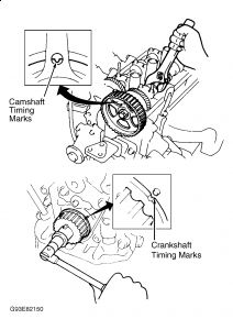

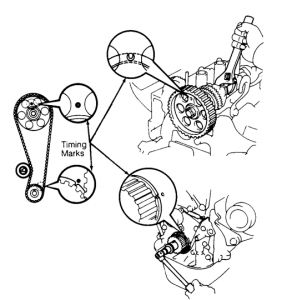

ANDREW RIVERA
  • 34 POSTS
how should the timing go on this car i want to know how the two camshafts go with their points and also the timing belt sproket how is it supposed to go and where should the point on that one should be aligned with. because the sproket has two holes one that says u and one that says e on wich one shoulg i put the camshaft key on
Oct 14, 2020 at 1:15 PM (Merged)
BLUELIGHTNIN6
  • 16,542 POSTS
https://images.2carpros.com/forum/automotive_pictures/261618_Graphic_577.jpg
