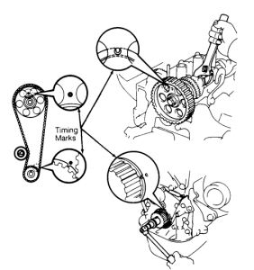

How should the timing go on this car I want to know how the two camshafts go with their points and also the timing belt sproket how is it supposed to go and where should the point on that one should be aligned with. Because the sproket has two holes one that says u and one that says e on wich one shoulg I put the camshaft key on

Not sure by what you mean by "reset". The timing belt is mechanical, if it were installed incorrectly (one tooth off), you would have some valve noise.
The crankshaft timing mark aligned, along with the camshafts timing mark (TDC #1), you then install the belt.
The ECM can be reset by disconnecting the negative battery cable for a minute or two, but if the timing belt was installed incorrectly, it would make no difference.

If anyone can help me and tell me how to line up the points on the ins tallation of a timing belt I will be very thankfull
