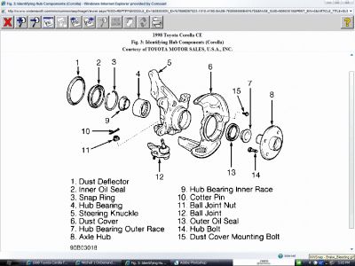

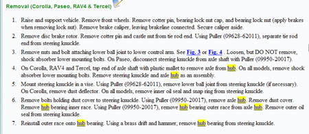

I am trying to remove the frunt hub from my corolla. Do I have to use a puller to remove it from the axle?

You need a press, and have to remove the knucke from the car...
