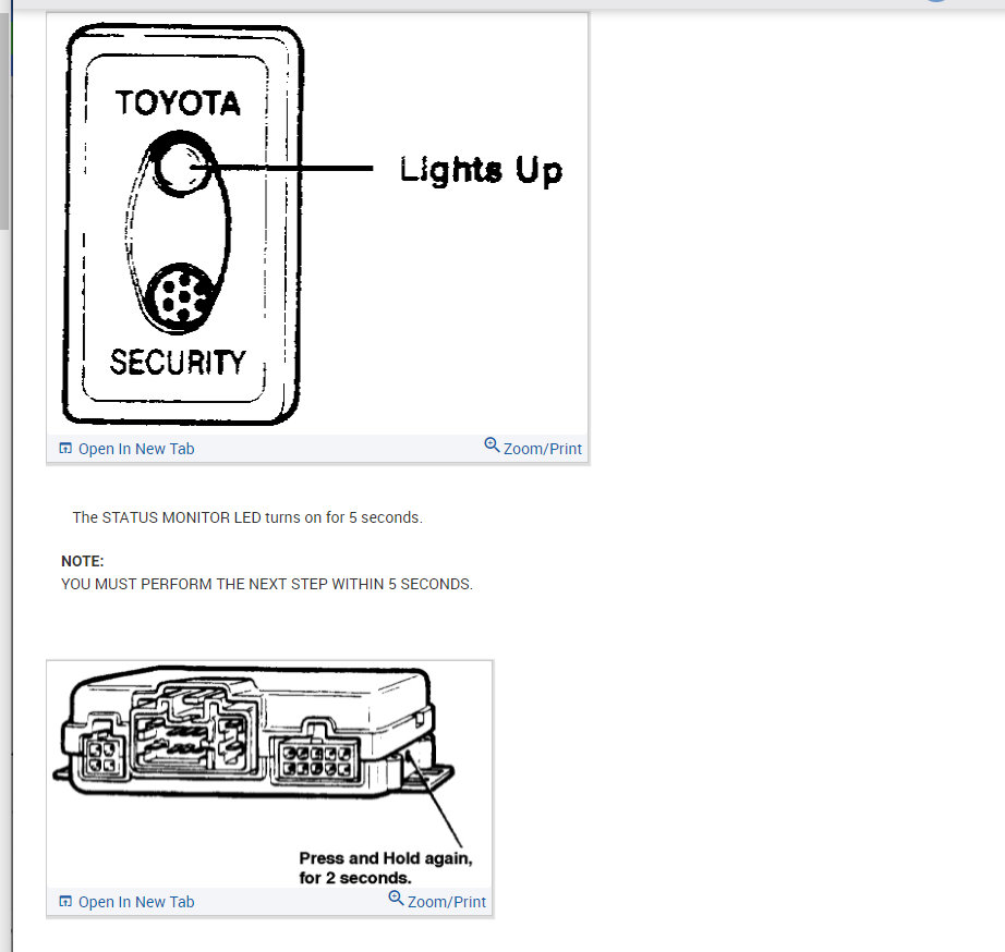

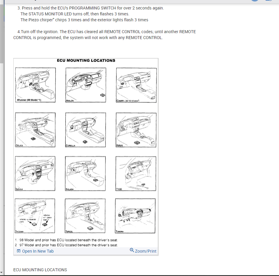

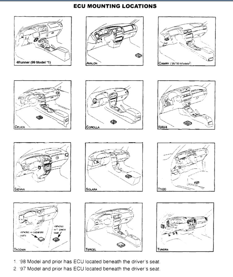

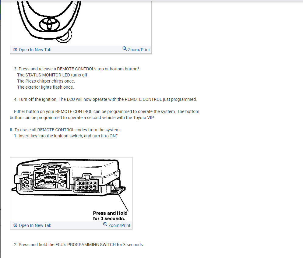

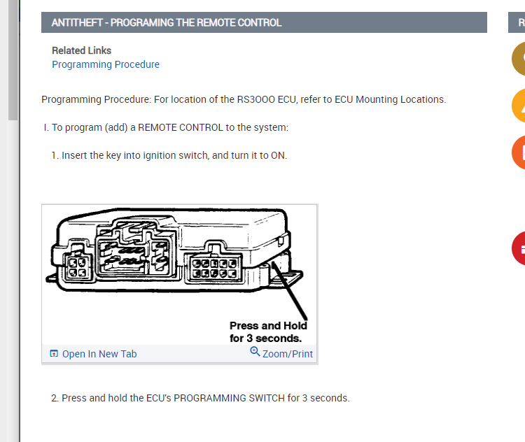

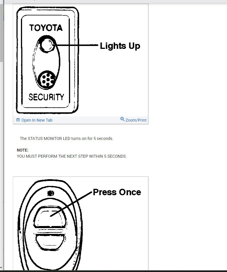

Do you know the procedure to learn a new fob on the car listed above AE102r? Does the old one have to be working?
Saturday, May 8th, 2010 AT 6:32 AM
This is not too complicated when you have the process and the location of the module you need in order to complete it.
However, here is a guide that will help with this as well in more general terms. This is more for those that may visit this page and not have this exact vehicle so this guide will help them.
https://www.2carpros.com/articles/how-to-re-program-a-key-remote-fob
The process for this vehicle is below. Please run through this and let us know what questions you have. Thanks
