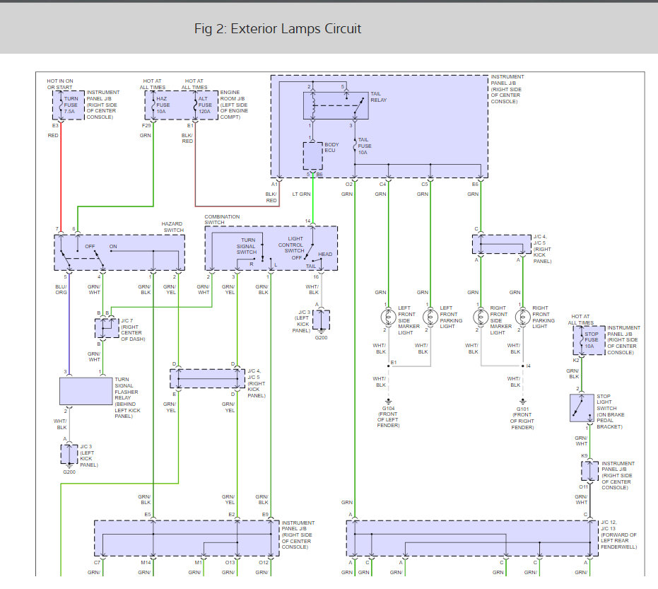

Brake lights work hazards also work?

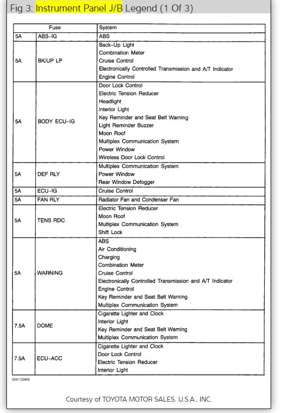

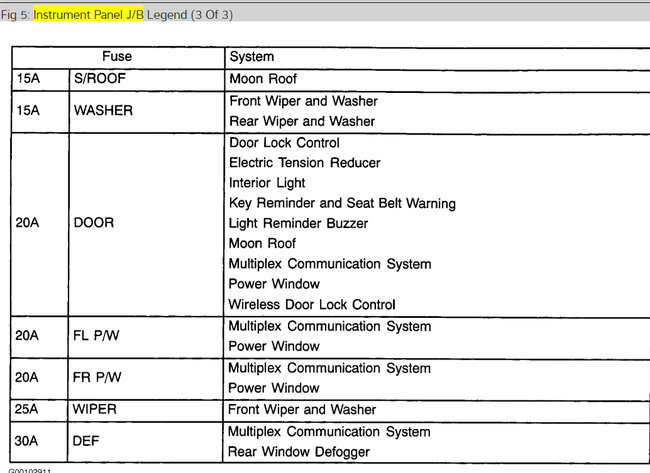

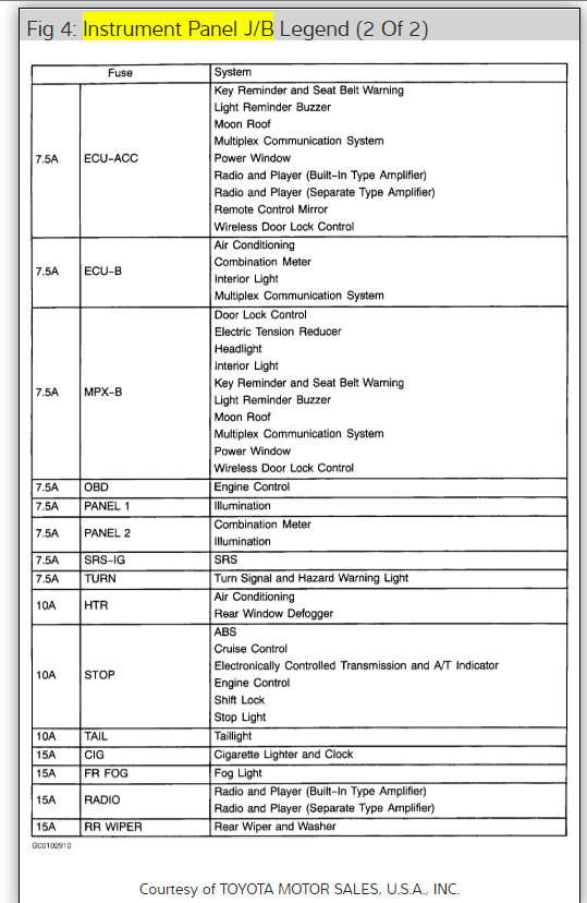

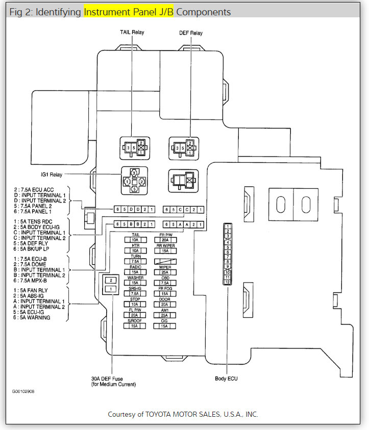

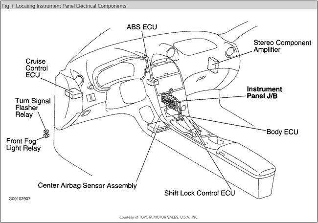

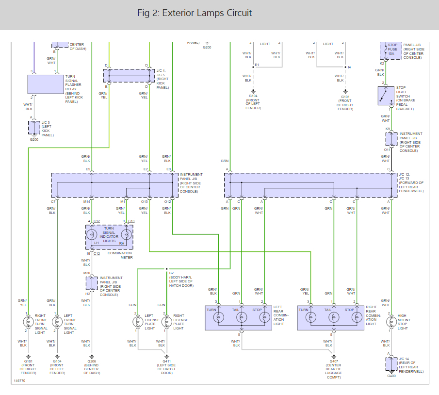

There is a tail light relay that needs to be checked because it sounds like it has failed. Here is a guide to help you test it with the location of the relay and wiring diagrams to help you see how the system works:
Check out the diagrams (below). Please run this test and get back to us.

Yep, this was the problem in my car cost me $23.00 for the relay all fixed!
