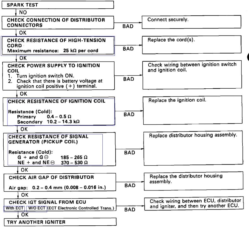

93 toyota camry 2.2L 4cyl. Us sedan.
one day I drive fine but my car turns its self off. I try to re start it but it just turns over. Some times it will turn on and some times it wouldn't. Now it wont stat at all. Since then i. Changed fuel pump (its getting gas) I also treated the gas. Then figured we went getting any spark. So replaced the distributor because I had a free new one. Got a new battery. Checked fuses. Changed spark plugs. Checked timing it was good. Why am I not getting spark?
i have not checked relays or the igniter. What else could make my car not start?

Try the igniter, I used to have a 94 tercel. When it is cold, it will start but when it is hot and the car is below 2000 rpm, engine hesitates and will stall. Then I tried to start it, engine turns but won't start at all plus there is no spark on the spark plugs. New igniter is expensive. If you have a friend with the same car, borrow his igniter (easy to remove) and check it out. If that is the problem, buy it at the self serve junk yard.

Good point-but I'll check the Ne/G signal from inside the distributor w/o it the computer won't give an Igt to the ignitor total results no spark and also no Igf spark confirmation.
Check the EFI relay,EFI fuse & ignition fuse
Heres a guide on using a meter, it will help you figure this out
Trouble tree for ignition system is attached below
