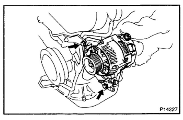

How do I remove the alternator? Im in progress of what I've done so far, I've yet to remove the bolts. What do I need to do next?
Thanks, Bob
Tuesday, March 23rd, 2010 AT 12:52 PM
21 Replies
KEN L
  • MASTER CERTIFIED MECHANIC
  • 55,322 POSTS
Start by disconnecting the battery. Here is a guide to help you see what you are in for when doing the job.
https://www.2carpros.com/articles/how-to-replace-an-alternator
you should test it when finished as well.
and
https://www.2carpros.com/diagrams/toyota/camry/2000

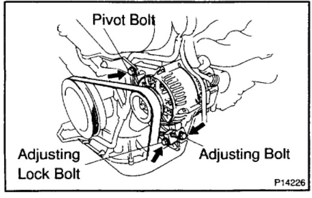

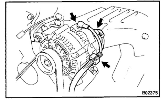

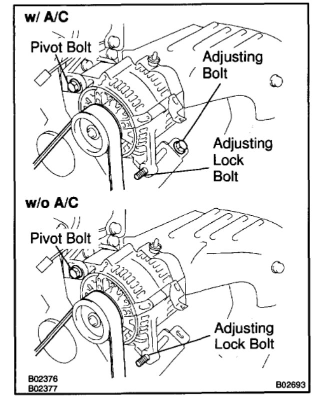

REMOVE GENERATOR
Loosen the adjusting lock bolt (w/ A/C), adjusting bolt and pivot bolt. Torque:
Pivot bolt: 52 Nm (530 kg.cm, 38 ft.lb)
Adjusting lock bolt (W/ A/C) or adjusting bolt (w/o A/C) 18 Nm (185 kg.cm, 13 ft.lb)
Remove the drive belt.
Remove the adjusting lock bolt (w/ A/C) or adjusting bolt (w/o A/C) and pivot bolt.
Remove the generator.
Here are some diagrams of how the job is done on your car (below) for both the 4 and 6 cylinder engines.

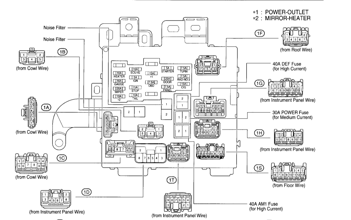

I have a 1999 Toyota camry and the fuse keeps blowing. It doesn't let me operate any windows and the odometer and everything in that dash does not operate. The strange thing is that it drains my battery completely dead. I also replaced the alternator, but I do not believe that it was effected by the electrical short. Any idea what the problem is and how to fix it. The fuse just keeps blowing when I change it. Mechanics are no help because I have found many have no clue about electrical issues.
Monday, November 20th, 2017 AT 2:32 PM (Merged)
KHLOW2008
  • 41,814 POSTS
Hi bobbycalvillo,
Thank you for the donation.
To understand what could possibly be wrong, I need to know what fuse is blowing.
How long has this been happening?
Was any repairs done prior to this happening?
Any impact damages when this startted?
Apart from those stated, any other electrical components not working?

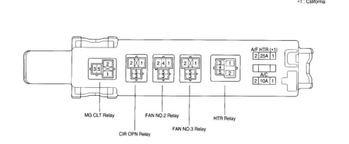

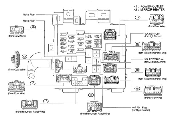

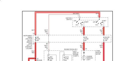

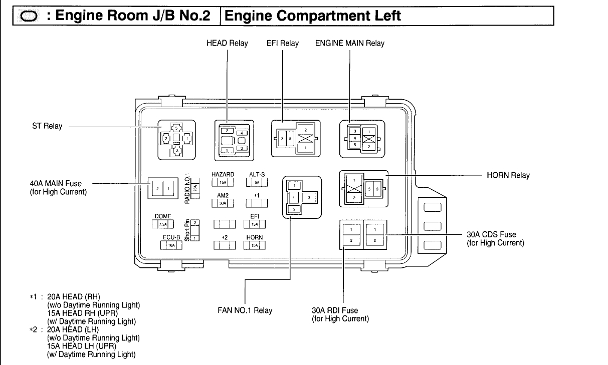

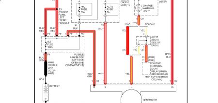

My car was working fine, but couple days ago it stopped charging the battery. I decided it was the alternator or the battery so I got them checked. They both checked good at the autoparts. I decided to buy a new alternator, ad installed it. It still doesnt charge the battery and the car looses power and eventually turns off. If it has a brand new alternator, and the battery is in new conditions also, what can be causing the car no to charge or power up the engine with the alternator? Please help me.
+2
  • 75,992 POSTS
Test all the fuses and fusible link see charging system below
https://www.2carpros.com/forum/automotive_pictures/12900_c1_24.jpg
https://www.2carpros.com/forum/automotive_pictures/12900_c2_22.jpg

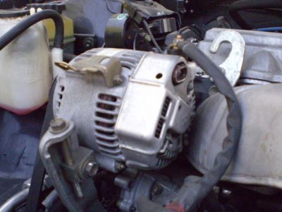

1999 Toyota Camry 4 cyl Two Wheel Drive Automatic 127000 miles

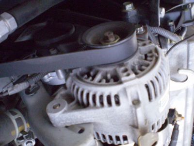

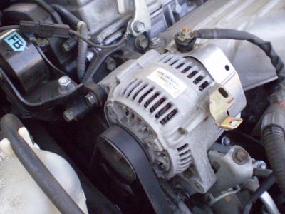

Need some advice on best way to loosen/remove belt connected to Alternator. My alternator has failed, does not charge my battery. I got a used alternator from salvage yard.
I am not sure method to increase slack on belt to slip it off, to replace alternator. Do not want to force/damage belt
Appreciate any advice..thanks!
https://www.2carpros.com/forum/automotive_pictures/366317_001_1.jpg
https://www.2carpros.com/forum/automotive_pictures/366317_002_1.jpg
https://www.2carpros.com/forum/automotive_pictures/366317_003_1.jpg
Monday, November 20th, 2017 AT 2:33 PM (Merged)
BILLYMAC
  • 2,204 POSTS
Hi the bolt in your pic that goes straight down and closest to the radiator is your tension bolt. Right beneath this bolt there is another bolt going horizontal. Loosen this bolt and turn the vertical bolt ccw. The belt will release install in reverse billymac
