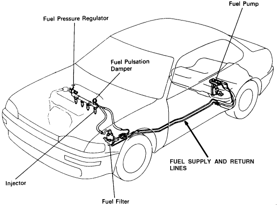

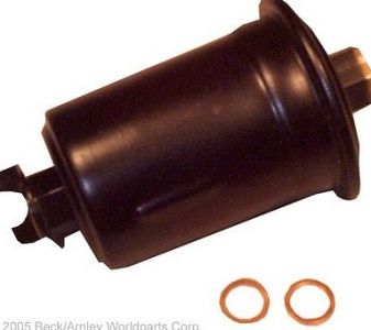

  • 75,992 POSTS
The fuel filter is mounted on the driver side of the engine compartment, below the charcoal canister.
