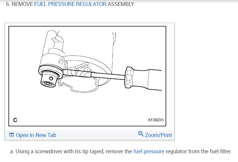

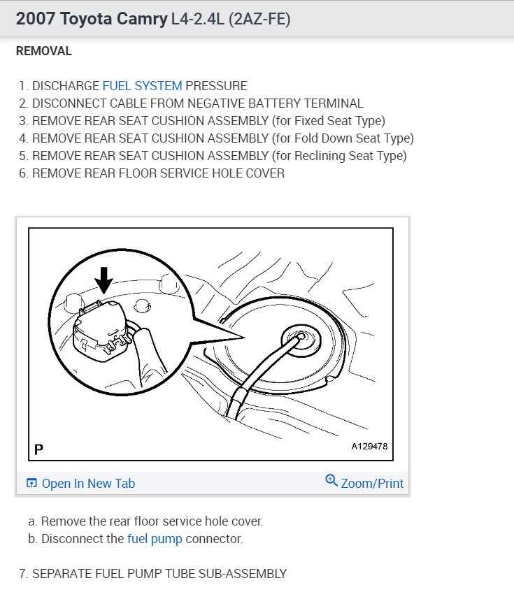

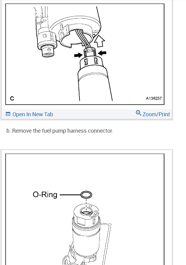

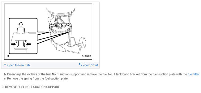

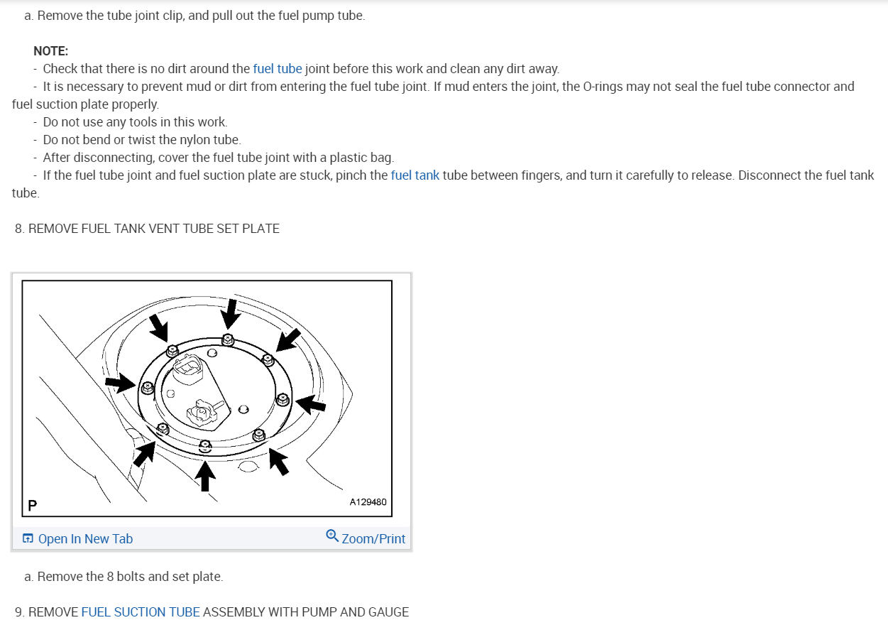

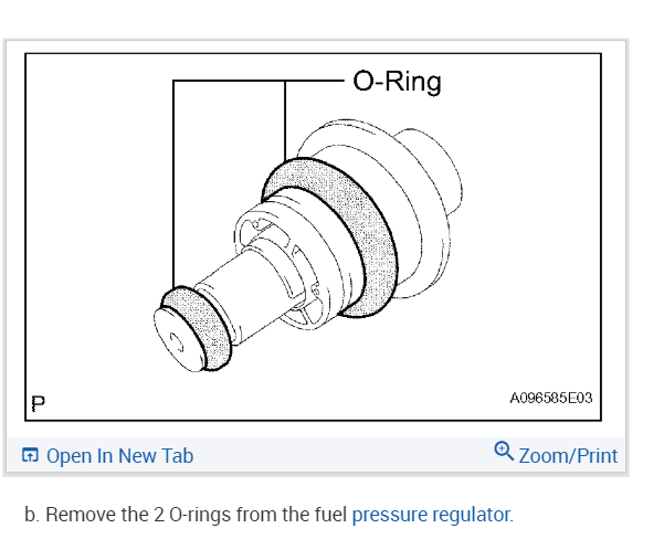

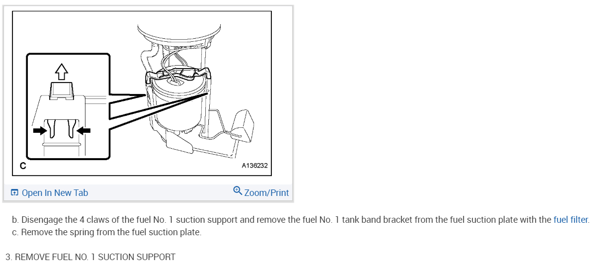

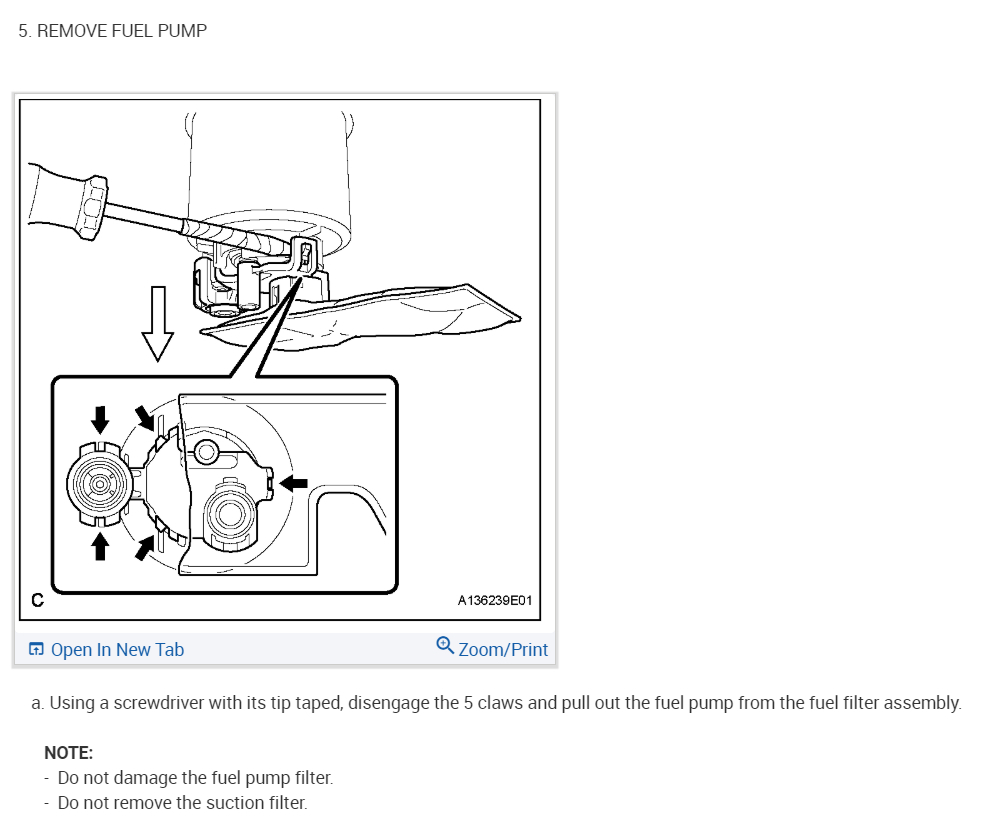

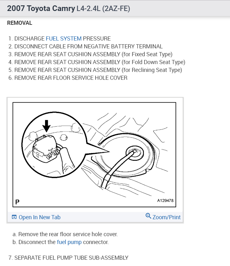

What is a reasonable charge to change fuel filter Labor + Part can I do it myself please show me.
Friday, May 1st, 2009 AT 10:05 AM
13 Replies
BMRFIXIT
  • 19,053 POSTS

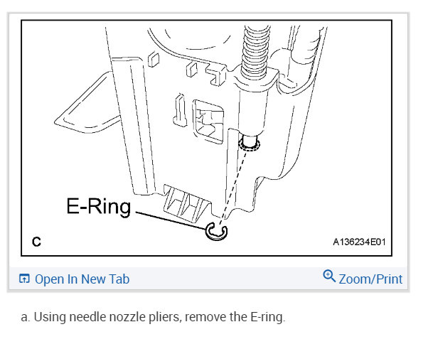

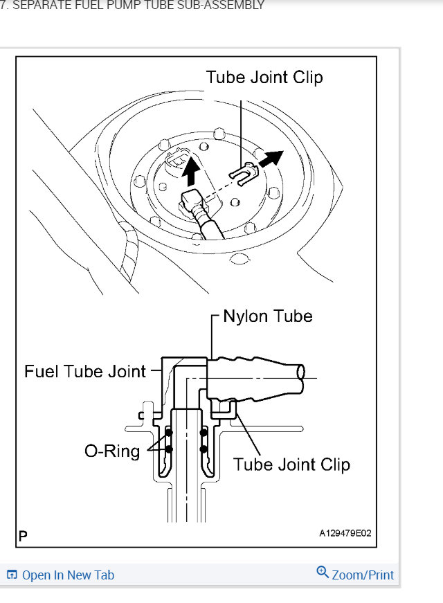

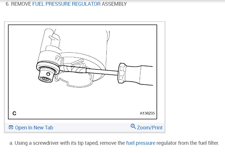

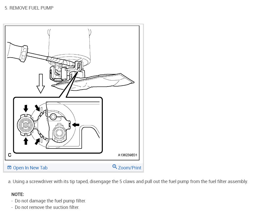

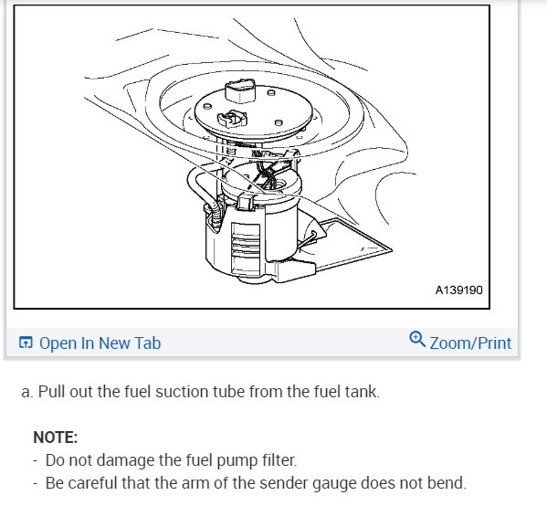

Fuel filter about $40 and an hour labor =$100 to $120 you can do it yourself the fuel filter is located in the tank with the fuel pump but there is a tap door that ames it easy. Here is a guide to walk you through the steps and the instructions for you car in the diagrams below.
https://www.2carpros.com/articles/how-to-change-a-fuel-filter

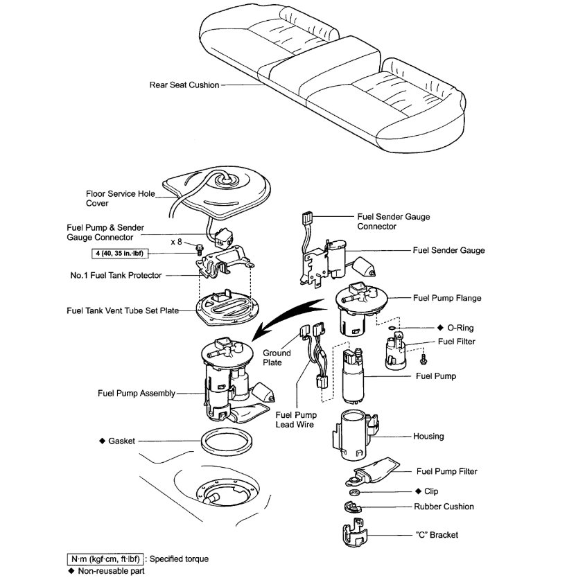

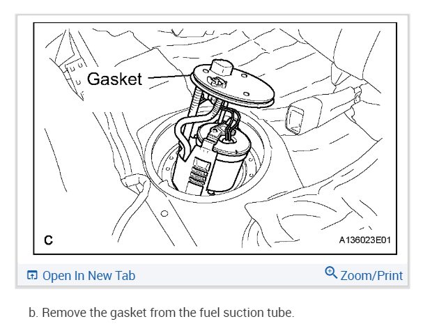

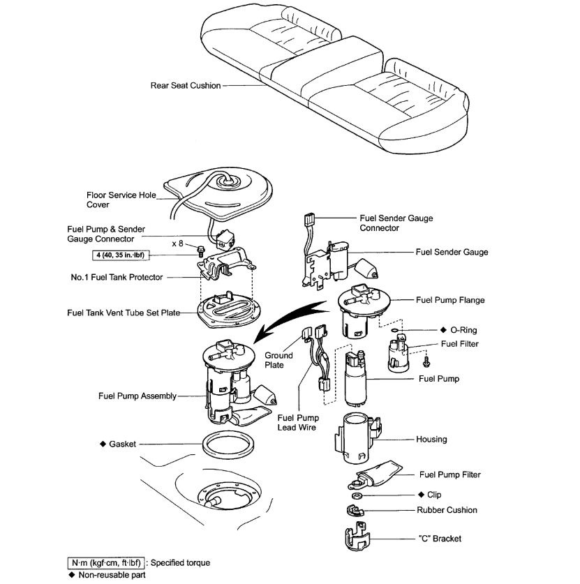

I have a 2000 Toyota Camry and need to change the fule filter but am unable to locate it. Can someone please tell me where it is located?
Thanks.
-1
Thursday, January 2nd, 2020 AT 8:48 PM (Merged)
2CARPRO JACK
  • 11,533 POSTS
The fuel filter is under the rear seat in the gas tank here is a diagram below to help you see.
