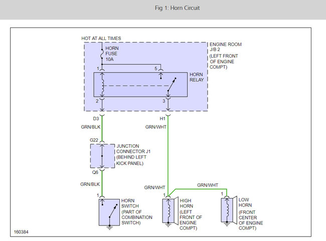

My car horn stopped working for no obvious reason, they work when I press the panic red button on remote, but otherwise from steering wheel they do not, I checked all the fuses and relay for horn, everything seems to be ok. I do not know what to do?

The most likely suspect is a broken clock spring. That's a wound-up ribbon cable in a plastic housing, under the steering wheel. As it continues to beak, eventually the cruise control will stop working and the Airbag warning light will turn on but to be sure lets use this guide and wiring diagrams below to confirm the failure.
And if its bad this guide will walk you through the clock spring replacement.
https://www.2carpros.com/articles/steering-wheel-clock-spring-removal
Check out the diagrams (Below). Please let us know what you find.

Thank you for this post I had a bad clock spring got a new one for $132.00 all fixed!
