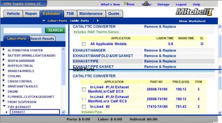

What is the cost of labor and parts for a 1996 Catalytic converter? What causes the Catalytic Converter to go out?
Tuesday, June 3rd, 2008 AT 3:51 PM
  • 75,992 POSTS
Labor will be about an 1hr-rates varies with location $70-$130.00 per hr. Parts cost-see below
https://www.2carpros.com/forum/automotive_pictures/12900_converter_2.jpg
