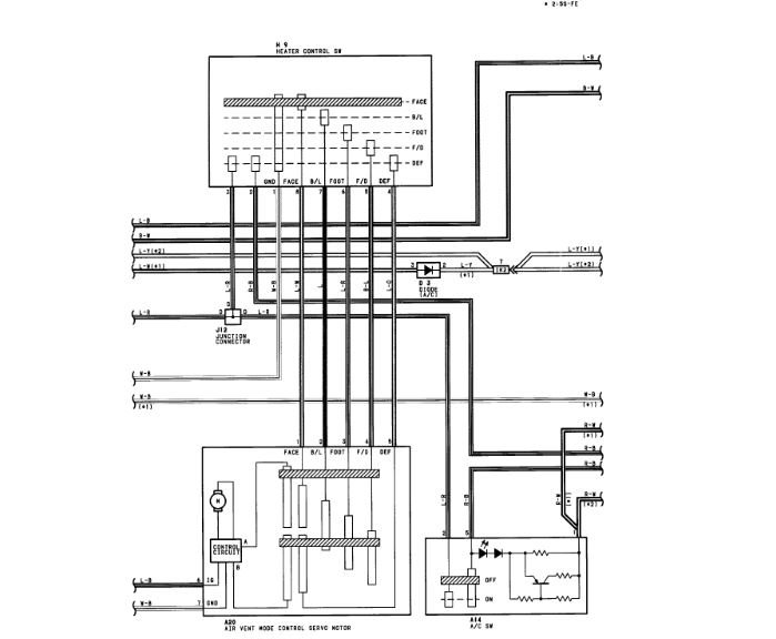

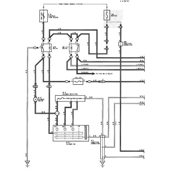

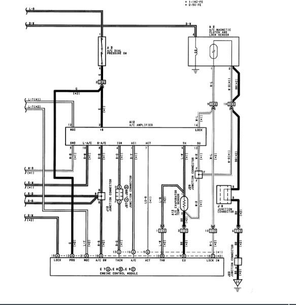

The A/C stopped working and we have it hooked up directly so we have a switch to turn on and off for the AC. But the AC stopped and now we do not know what is wrong with it. We do not know if it the compressor or the cable or the fuse box. Also, where is the fuse box inside the car?
Friday, November 27th, 2020 AT 8:44 AM (Merged)
  • 52,797 POSTS
Good evening.
Did you wire power directly to the compressor?
If you did, where did you get the power source?
Did you verify power to the compressor with your switch.
I attached a wire diagram for you to view. Check all your fuses with a test light for power on both sides with the key on.
Did you verify Freon in the system?
KERVYNJIM13
  • 5 POSTS
Yes, I bypassed relay for the power.
  • 52,797 POSTS
Okay, did you verify power at the relay and the compressor?
KERVYNJIM13
  • 5 POSTS
I think it is the A/C controller inside the car where the A/C button is not getting power.
KERVYNJIM13
  • 5 POSTS
Yes, I verified.
  • 52,797 POSTS
Okay.
The next step is to verify the clutch is engaged.
If it is, then we need to check the pressures. Do you have gauges to verify pressures?
