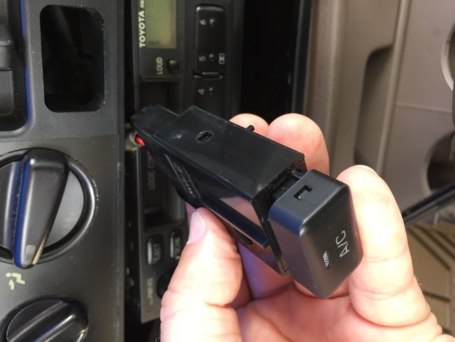

Correct, so my question is why is AC switch light not illuminated when depressed? Either the switch itself or amplifier.
Friday, November 27th, 2020 AT 8:48 AM (Merged)
WRENCHTECH
  • 20,761 POSTS
It is not going to be the amplifier if the AC switch does not light up because the switch tells the amplifier what to do. See if the switch has power coming in on the yellow/green wire.

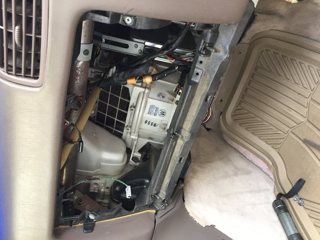

SZALKUSKT
  • 274 POSTS
Okay, I am going to look at the switch now after I access it via dash panels. Yeah, I was thinking same thing that the switch tells amplifier what to do.
SZALKUSKT
  • 274 POSTS
The yellow wire with green tracer. It has power when key is in “on” position.

SZALKUSKT
  • 274 POSTS
I have another switch from parts car.
SZALKUSKT
  • 274 POSTS

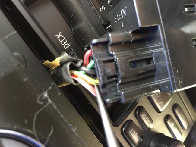

Installed another switch same thing no change. With test light switch has power to yellow/green tracer wire and switch controls power to red/black tracer wire. I can observe the switch controlling power out to red/black tracer wire.

Looking at your diagram I cannot figure out why the light is not coming on when switch is depressed. I know I have power coming in and power out when depressed.

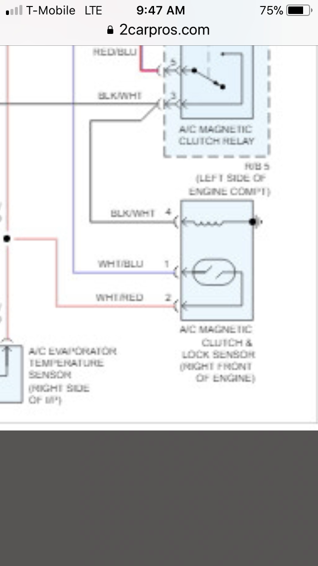

SZALKUSKT
  • 274 POSTS

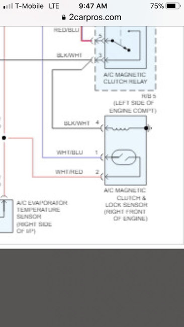

Based on the diagram and both AC switches not lighting up, and what you mentioned initially, I am scrutinizing this rpm sensor on the AC compressor.
SZALKUSKT
  • 274 POSTS
The magnetic clutch and lock sensor is shown open in the diagram. How can I check it to verify it is bad?
WRENCHTECH
  • 20,761 POSTS

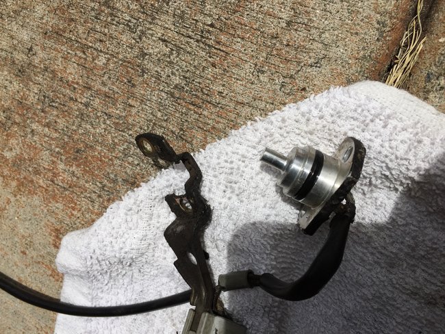

If the RPM sensor is bad, the AC switch will flash.
SZALKUSKT
  • 274 POSTS
The white/blue white/red wires are going to the sensor. This is what it looks like.

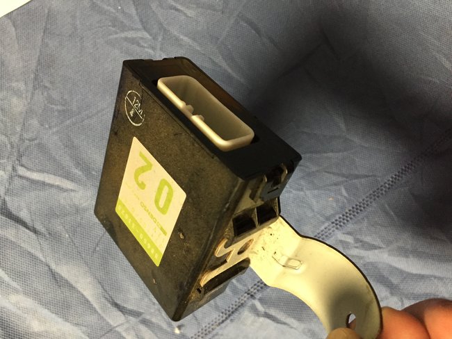

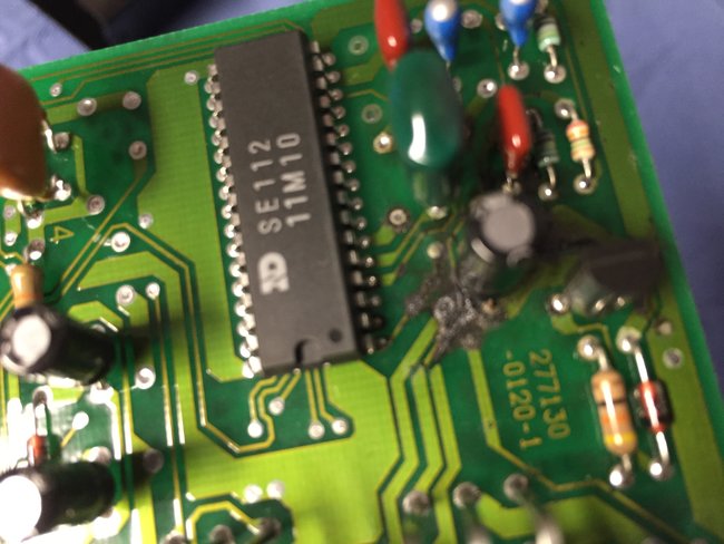

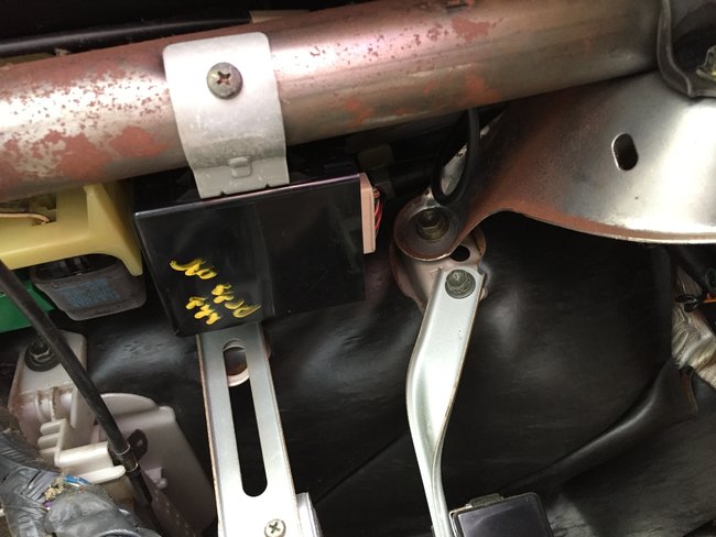

SZALKUSKT
  • 274 POSTS
I am pleased to report that I swapped out the amplifier with one from junkyard and It fixed my problem. Everything is working fine now. The glove box has to be removed and the amplifier is attached by a Philips screw and bracket to the tube that supports the dash. I am mentioning this so others will know. My AC light was not blinking but totally off. That is why I decided to change the amplifier before the rpm sensor on the compressor. Like you said, the blinking light is associated with the rpm sensor. I opened up the amplifier and I could see burning on the circuit board. Thanks for your help with this.
+1
SZALKUSKT
  • 274 POSTS
This is what the amplifier looks like.
+1
