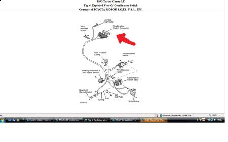

sorry park/side ... are they working because you jumped them .. or because you replaced the INT relay ??
On my wiring diagram ..I have a WHITE wire and a BLACK/WHITE wire going from ignition switch to the connector I mentioned in my last post .. is this the same on the vehicle ?? if different what colors do you have and how many wires from IGN switch to junction block
let me know
https://www.2carpros.com/forum/automotive_pictures/266999_AAA2_276.png

OK. It seems we have discrepency in the wire colors again. While I am checking the wiring diagrams. Could you go out and start the car. And waggle/jiggle/play around with by hand the connector (the one in the photo) see if this makes the car stop?
Also do the wires from the ignition go through this connector (on photo) before going to the fusebox?
On the ignition switch what color are the wires on # 4 pin and # 7 pin

I started car and wiggled, jiggled, and even jostled and couldn't make it cut off.I really can't see what pins are attached to what wires, there's like a rubber cover over them.

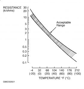

Ok If you have an OHMS meter you could check the IAT sensor is working correctly ..
Intake Air Temperature (IAT) Sensor
Intake air temperature sensor is mounted in either airflow meter or air filter housing. Intake air temperature sensor measures incoming intake air temperature and delivers an input signal to THA terminal of Engine Control Module (ECM) for controlling fuel injection system, fuel pressure control (if equipped) and heated oxygen sensor systems (if equipped).
Idle Speed Control System
Engine Control Module (ECM) is programmed with engine idle speed values. Idle air control system provides a stable idle speed when engine is cold and idle speed decreases due to electrical load. The Engine Control Module (ECM) uses various input signals to maintain proper idle speed by controlling Idle Air Control (IAC) valve located on air intake system.
INTAKE AIR TEMPERATURE (IAT) SENSOR
Ensure ignition is off. Disconnect electrical connector from intake air temperature sensor. Intake air temperature sensor is located in air intake, near air filter.
NOTE:Intake air temperature sensor may be also identified using appropriate illustration in the THEORY/OPERATION - 2.2L article.
Remove intake air temperature sensor. Place threaded end of intake air temperature sensor and thermometer in container of water. Attach ohmmeter between intake air temperature sensor electrical terminals.
Heat water and note that resistance is within specification in relation to temperature. See Fig. 3. Replace intake air temperature sensor if defective.
https://www.2carpros.com/forum/automotive_pictures/266999_camry3_1.jpg
let me know !
https://www.2carpros.com/forum/automotive_pictures/266999_AAA2_285.png
Wednesday, March 18th, 2009 AT 11:28 AM
MBENCO
  • 184 POSTS
I took the IAT sensor off and performed the test and the sensor read 19 olms @ 212 degrees. I think that it's ok.
