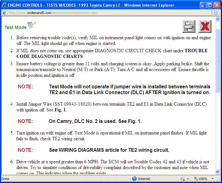

Hi there!
Would it make sense that the problem could be the MAP sensor?
I have the car at a friends house and I have taken it out the last 4 days and there was no problems, until today i brought the car to work and it stalled! My friend has a diagnostic machine and he did see something about MAP sensor but we don't know if that was an older problem!! Because they are somewhat expensive I wanted to be sure that we change the right parts!! Is it possible for me to use a used Map sensor?
Thanks for your time!!!
Mike

Hi Mike,
Yes, the MAP sensor can cause the problem described.

Hi vwmike72,
Did the engine stall while driving or when you slowed down or stopped?
Is the Check engine light showing?
What is the idling rpm when engine is at operating temp? With AC on?
Jun 18, 2020 at 10:00 AM (Merged)

Hi vwmike72,
The idling speed is normal but you seem to stall only at stops so you need to check the idling system. Is the idling erractic when the AC cuts in and out?
If yes and you had not cleaned the throttle body and IAC before, I would suggest cleaning it to get the idling speed stable. Use of carb cleaner is good enough.
Was resetting done for the ECM after installation of the MAP?
The ECM needs relearning to a certain extent so the stalling might have happened before it had fully relearnt itself. The problem might just go away after some driving.

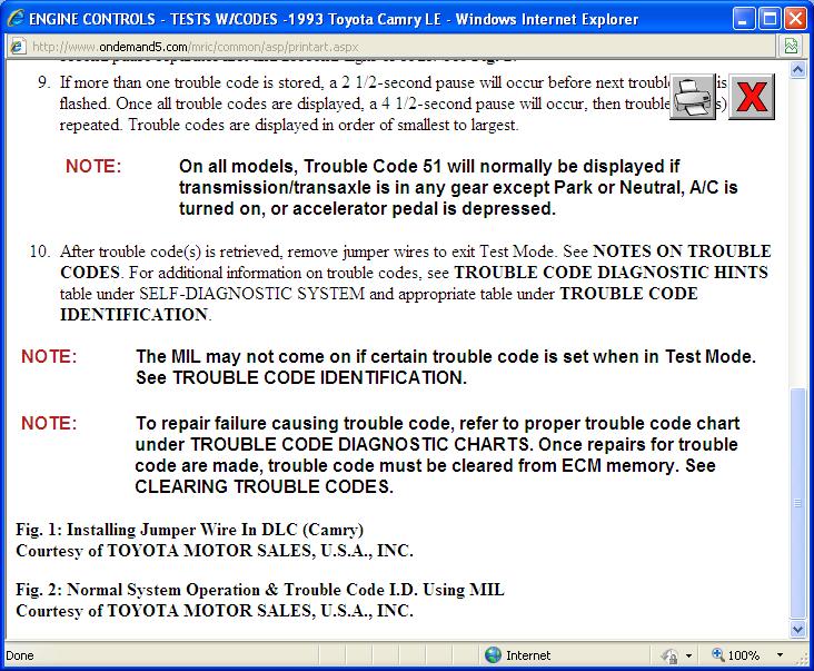

  • CAR REPAIR CONTRIBUTOR
  • 75,992 POSTS

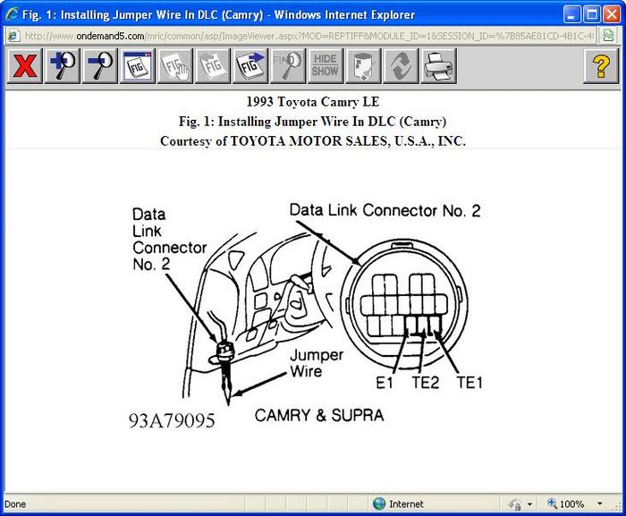

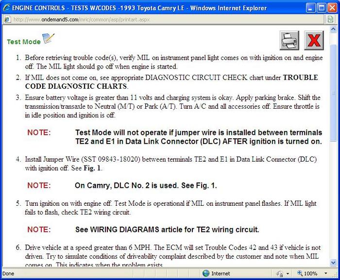

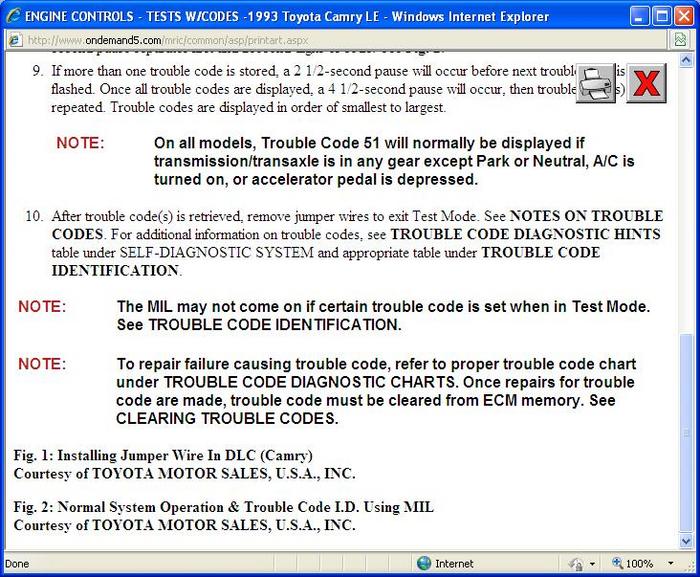

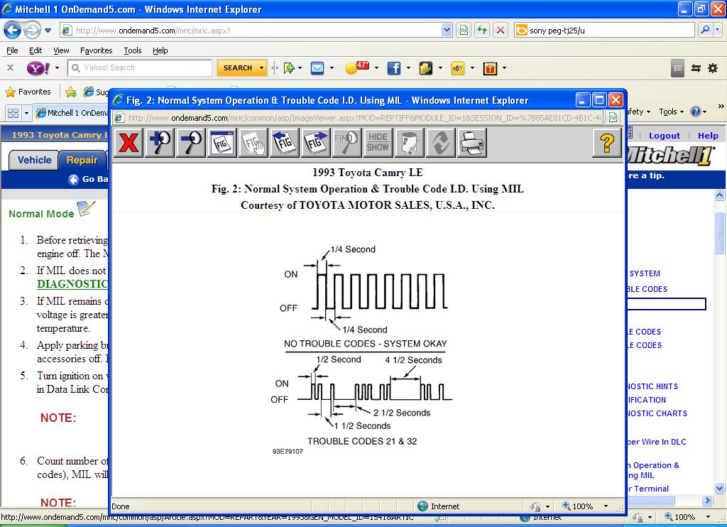

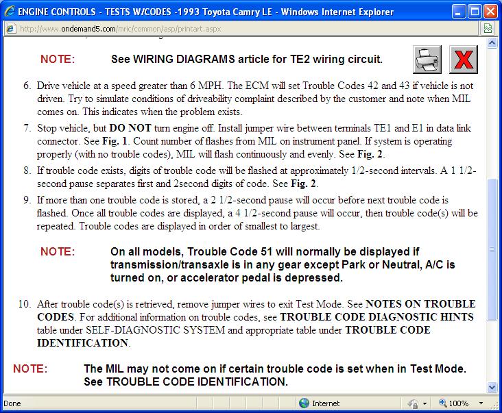

Next time it refuses to start don't wait for it to make up its mind-do below immediately to determine if its fuel or spark problem
Get a helper disconnect a sparkplug wire or 2 and ground it to the engine atleast 3/16 away from ground-have helper crank engine over-do you have a snapping blue spark? If so-you have a fuel related problem, Do you hear the fuel pump come On when you turn key on? If not check fuel pump fuse and fuel pump relay if okay-check the fuel pressure to rule out the fuel filter/fuel pump/pressure regulator and listen to the injector/s are they pulsing or hook up a noid light. No snapping blue spark continue to troubleshoot the ignition system-power input to the coil/coil packs,coil's resistances,cap and rotor,distributor pick-up coil, ignition control module, cam and crank sensors and computer Note: If it doesn't apply disregard it and keep testing
