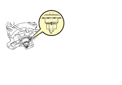

Had a distributor replaced it went bad, rotor slipped on shaft, wife drove it home running rough and very slow. Now my problem is I can't get it to crank. It has spark good comprssion all 4 cylinders at 180 psi, fuel catylitic converter is free from obstruction. Can't find any vacuum leak so any ideas would be appreciated

You changed the distributor
check firing order 1 3 4 2
place cyl. # 1 on TDC remove and check distributor
https://www.2carpros.com/forum/automotive_pictures/99387_camry_dist_1.jpg
