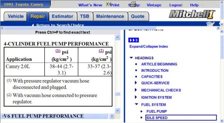

Ive the fuel pump from the tank and tested it for hours, and its running on 30 psi, do I need to replace the pump? Thanks

You're just lil bit shy-But what is the problem that you are about to replace it? Have you check the fuel filter
