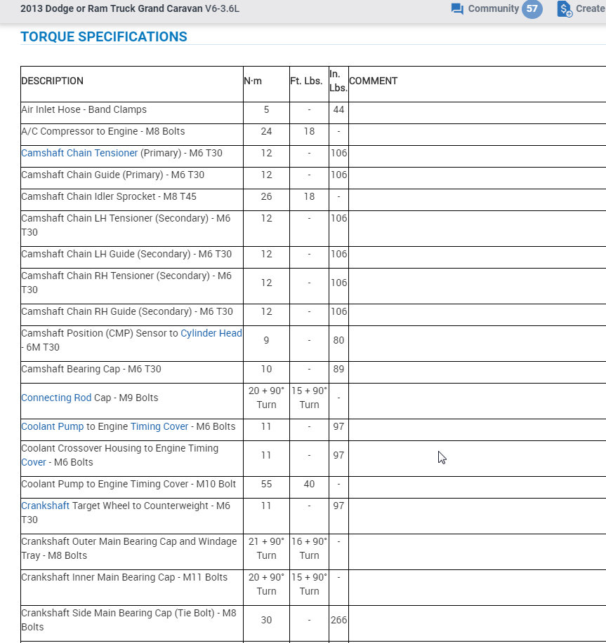

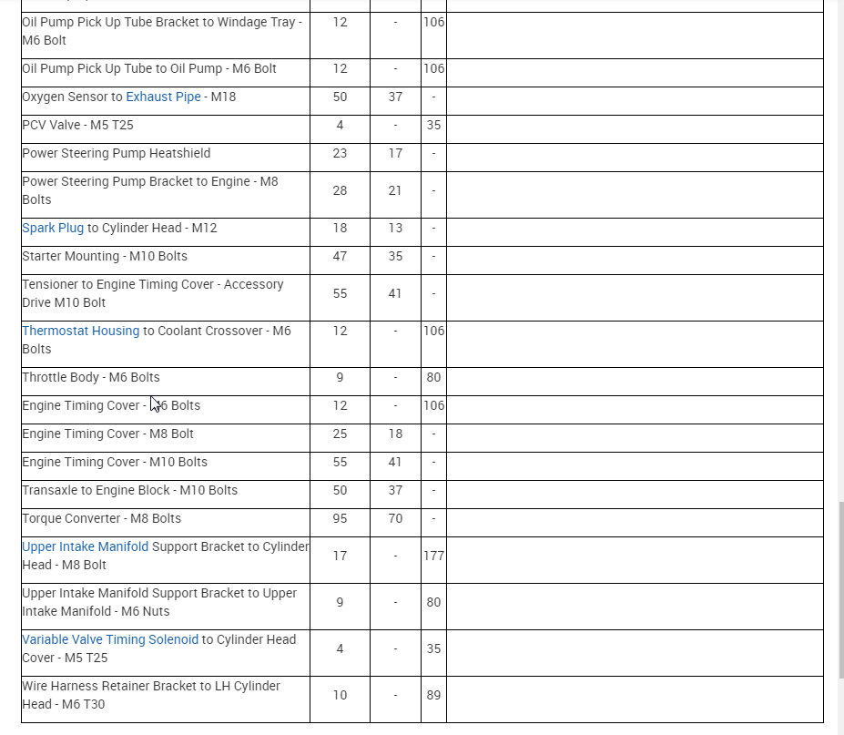

Torque specs for the camshaft bearing caps
PEDROK
MEMBER
2013 DODGE CARAVAN
155,000 MILES
Replaced rocker arm.
Monday, March 23rd, 2020 AT 8:58 AM
2 Replies
MECHANIC
52,796 POSTS
Good morning,

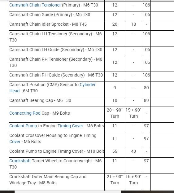

I attached all the camshaft torque specs for you below.
The spec is in inch pounds and nm.
89 inch pounds is the spec you need.
Image (Click to make bigger)

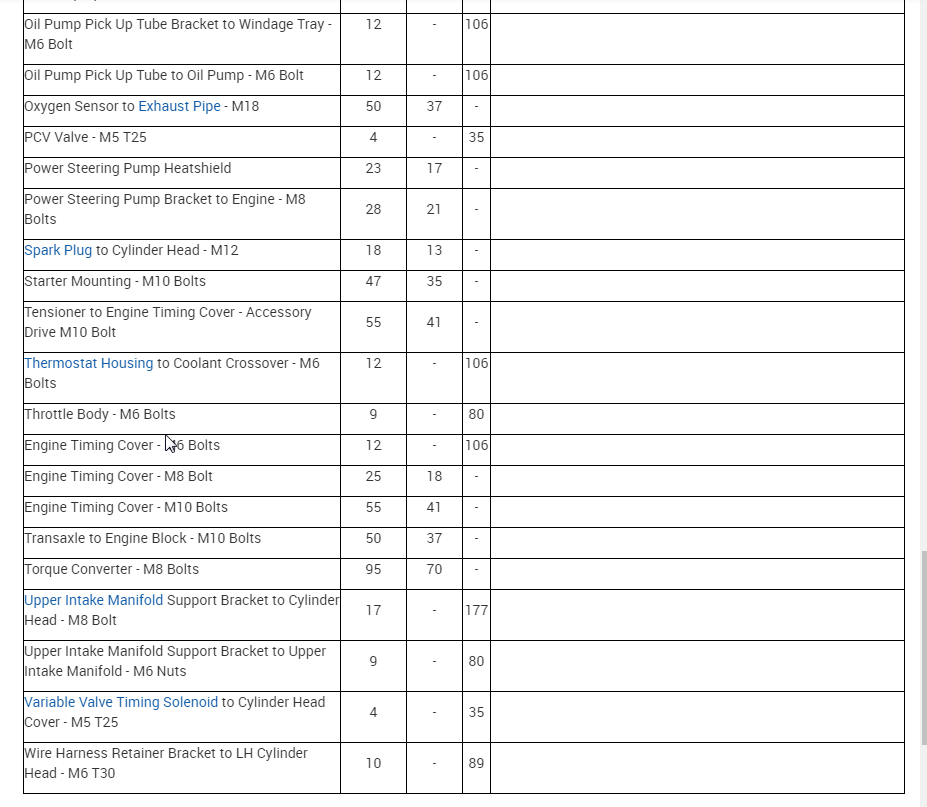

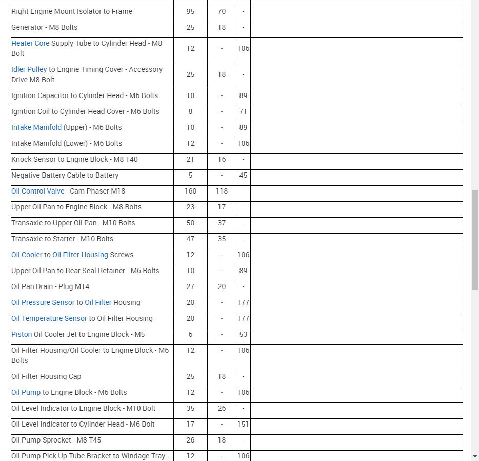

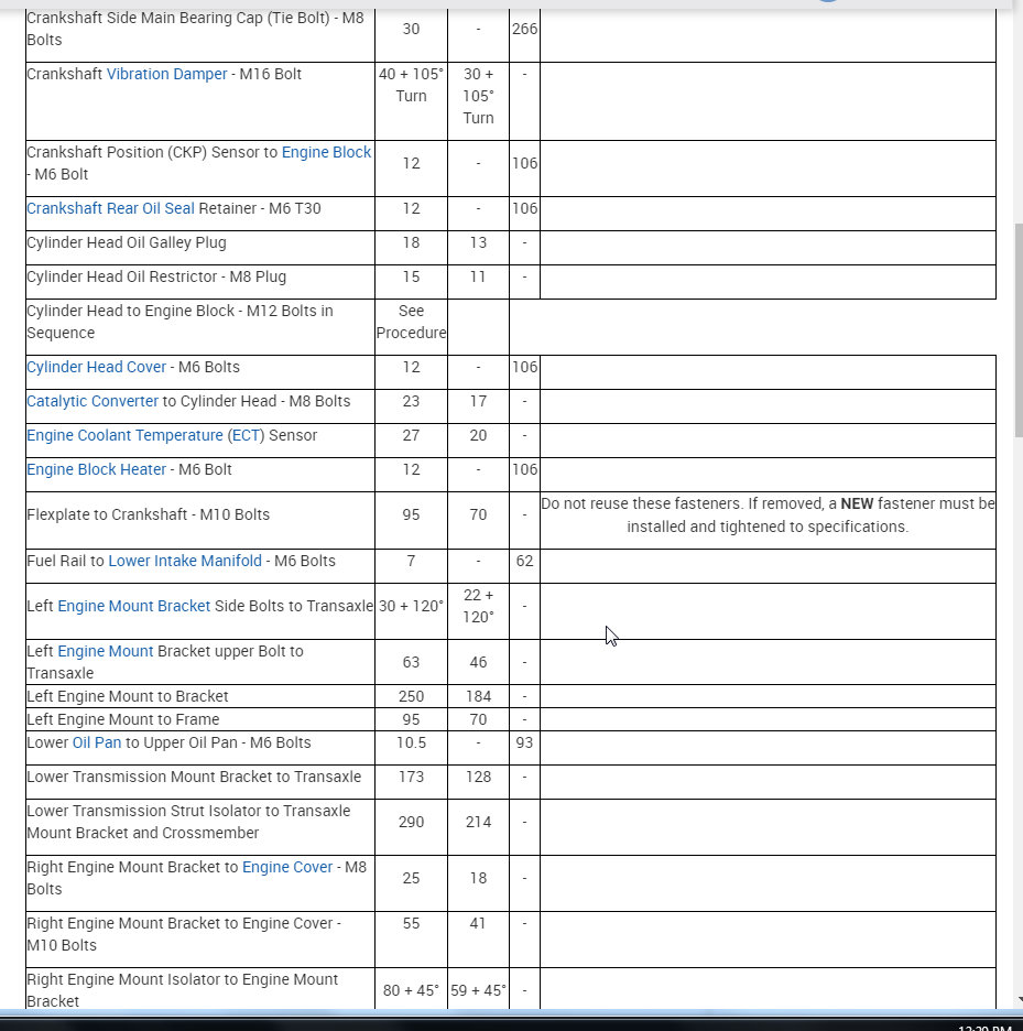

I attached all the engine specs but the Camshaft Bearing Caps are 10 Nm or 89 In Lbs.
Let me know if you need more of these. Thanks
