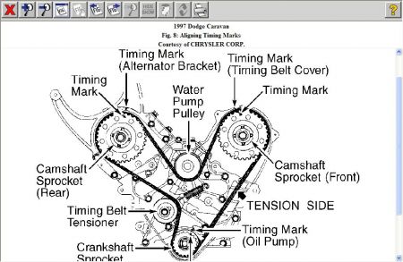

can someone please send me a picture of the timing marks on this minivan. Also how can I be sure that I have the marks right and not 180 degrees out if they are all lined up I have been working on this for 3 days now and am getting very upset please help thank you

Which liter engine do you have there's 3 V6cyl engines?

The engine size is a 3.0

Put the engine no.1 piston on its compression stroke and line the markings at the damper to TDC/0-you can verify this by removing the dizzy cap making sure the rotor is pointing to no.1 cap tower or remove the valve cover and check no.1 valves it should be fully closed.
Aligning timing sprockets-see below Good Luck
https://www.2carpros.com/forum/automotive_pictures/12900_timing_16.jpg
