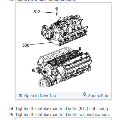

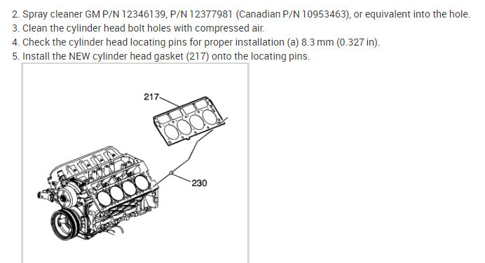

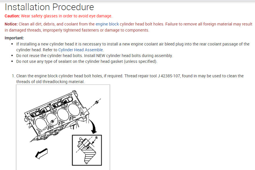

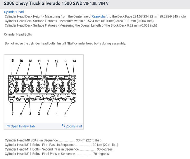

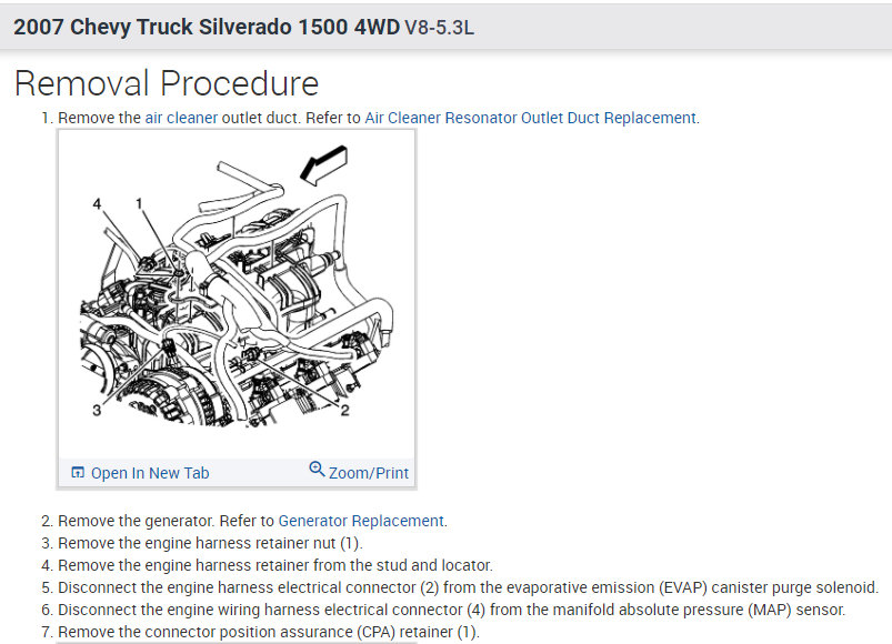

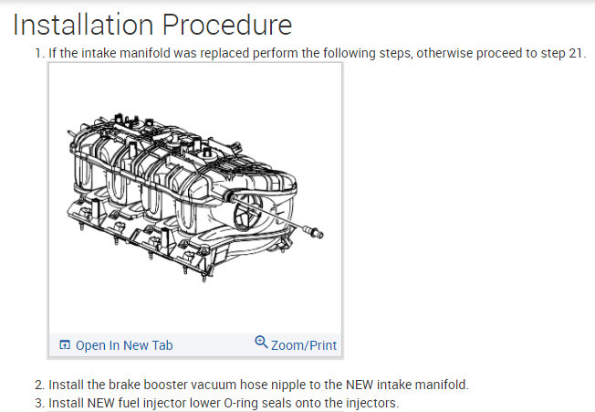

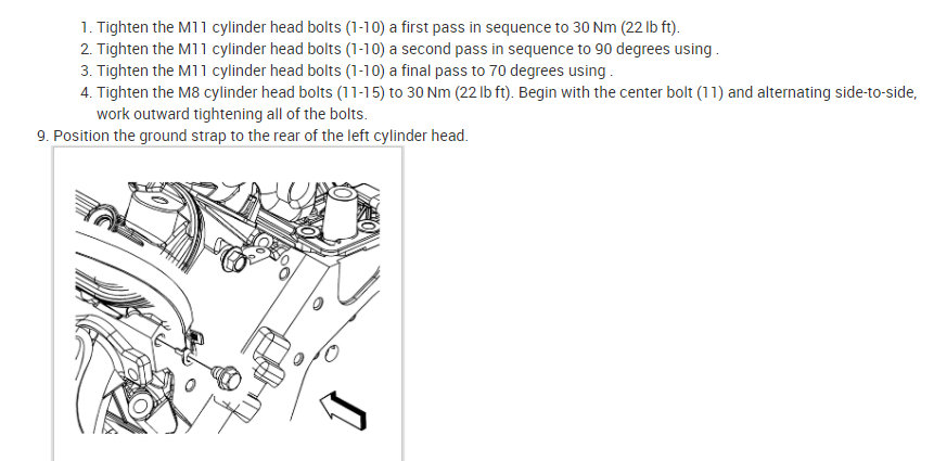

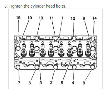

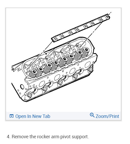

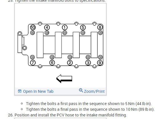

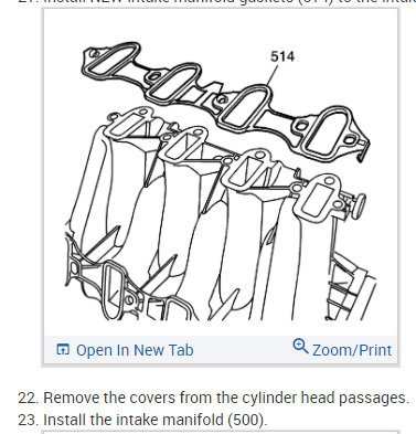

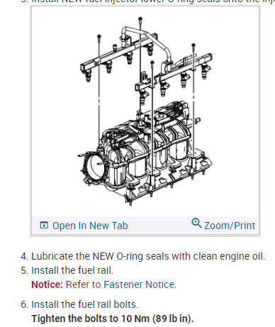

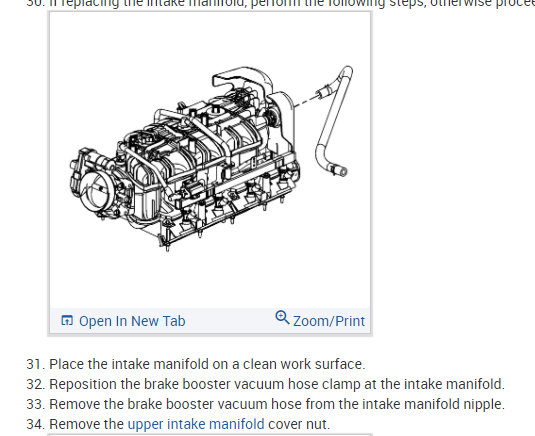

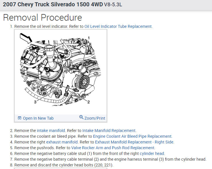

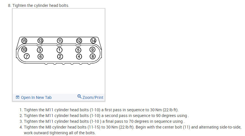

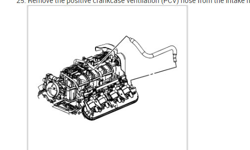

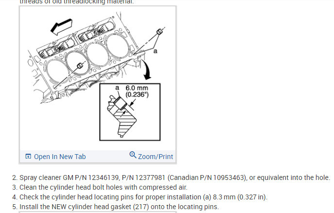

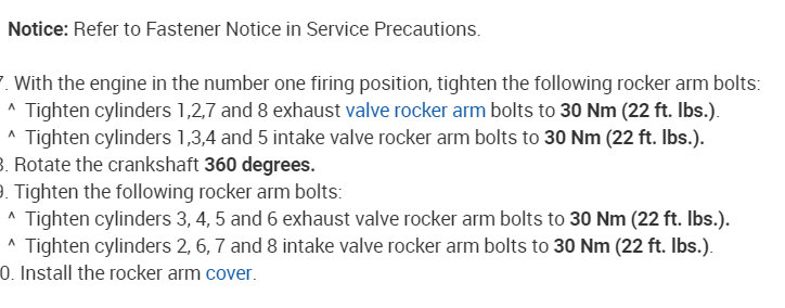

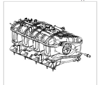

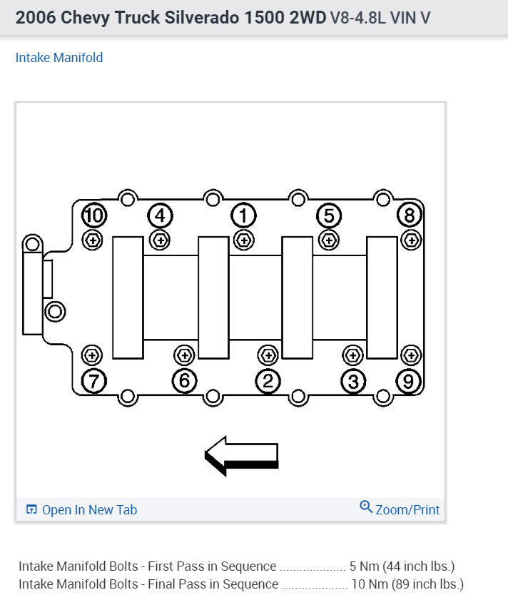

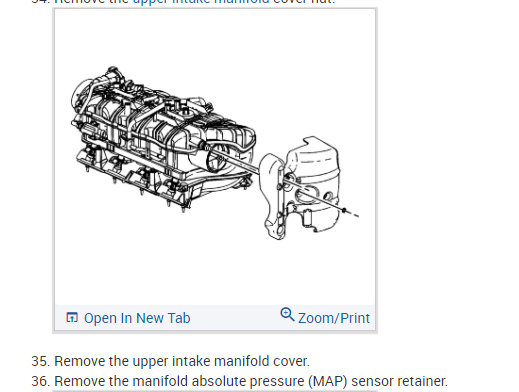

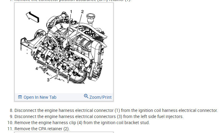

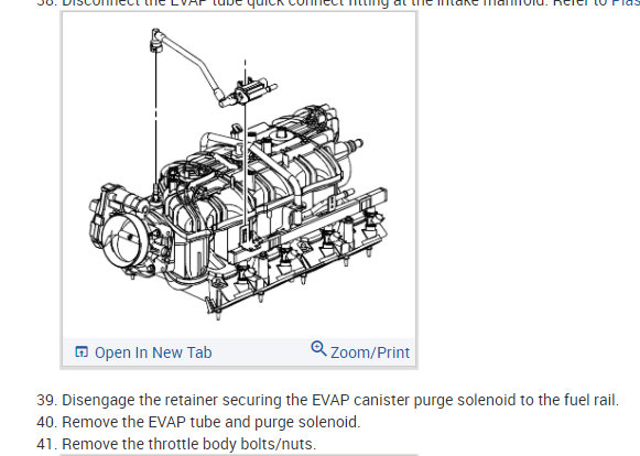

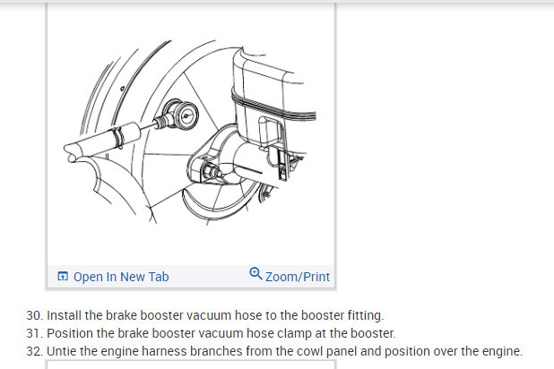

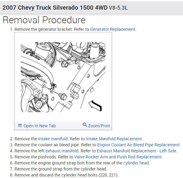

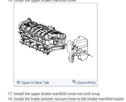

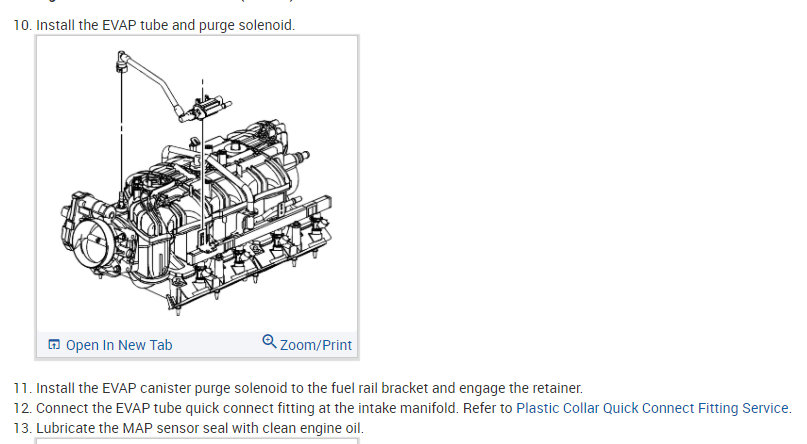

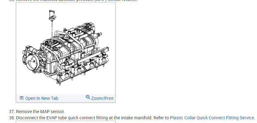

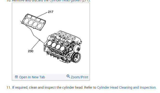

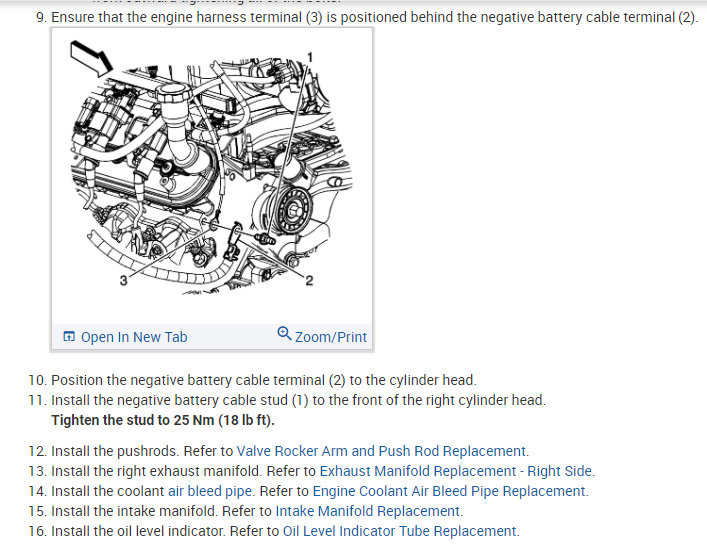

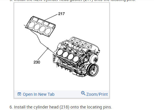

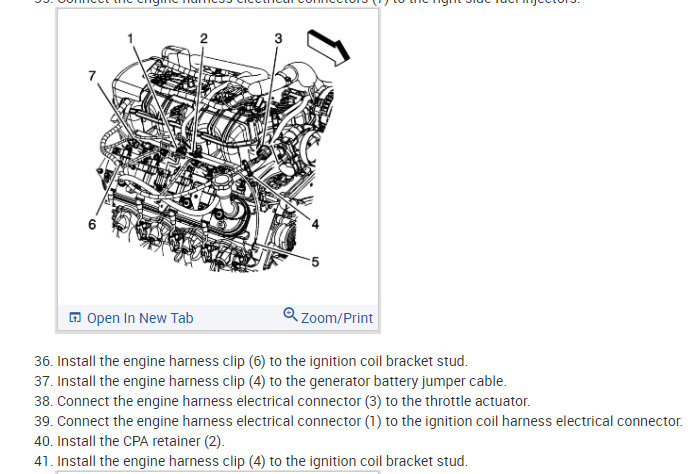

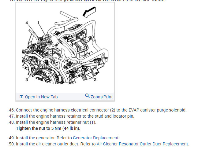

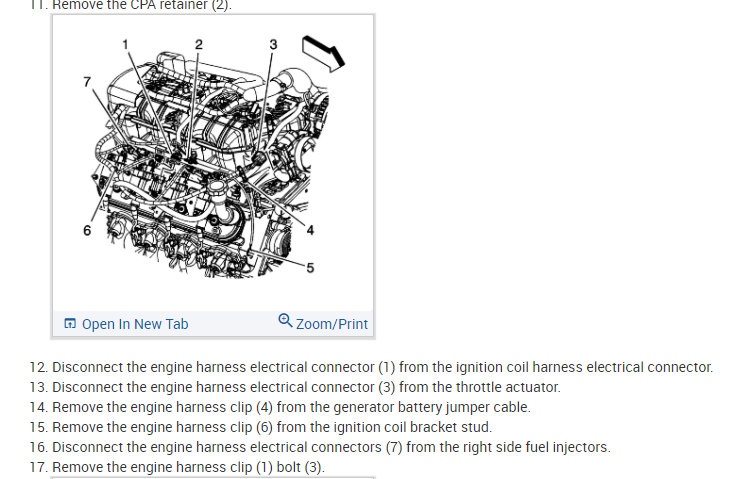

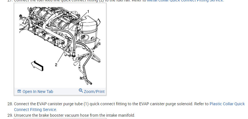

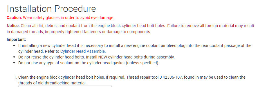

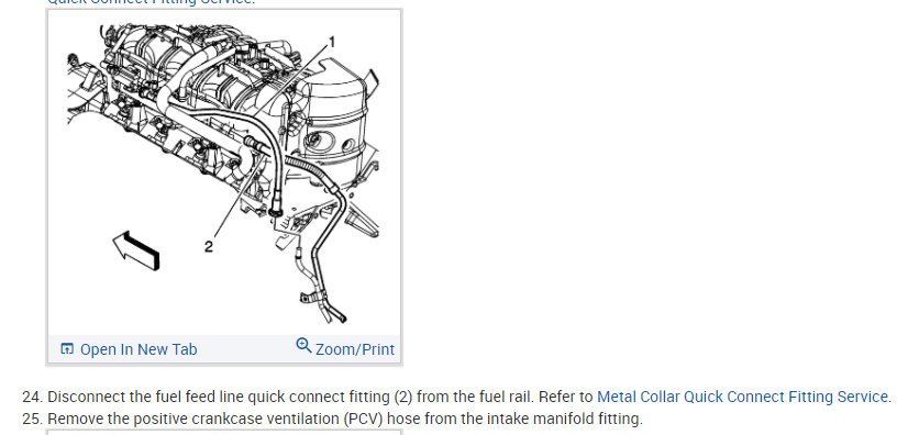

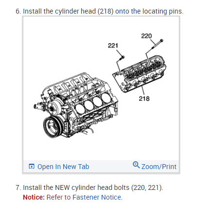

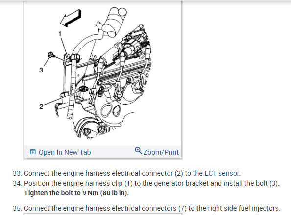

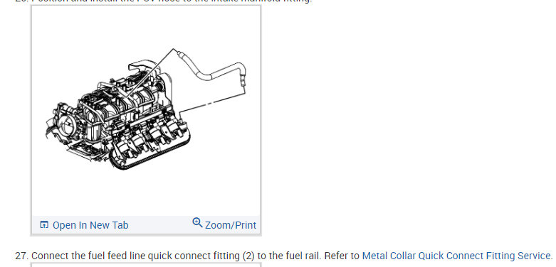

Replacing the head gaskets on my truck. I have found torque specs for the 5.3, but cannot seem to find any for the 4.8. Are they the same and if not what are they? I am needing:
head bolts
intake manifold
rocker install sequence
Do you
have the same problem?
Saturday, December 3rd, 2016 AT 5:29 AM
7 Replies
HMAC300
  • EXPERT

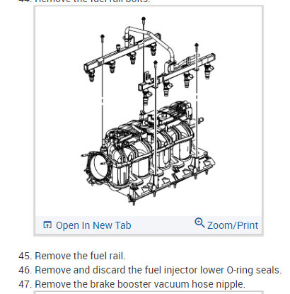

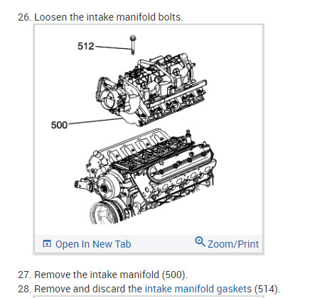

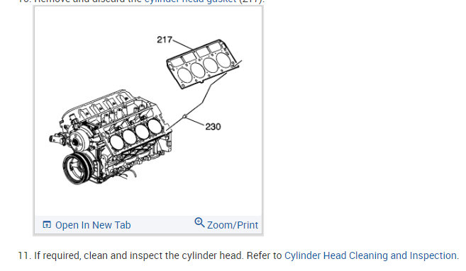

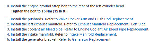

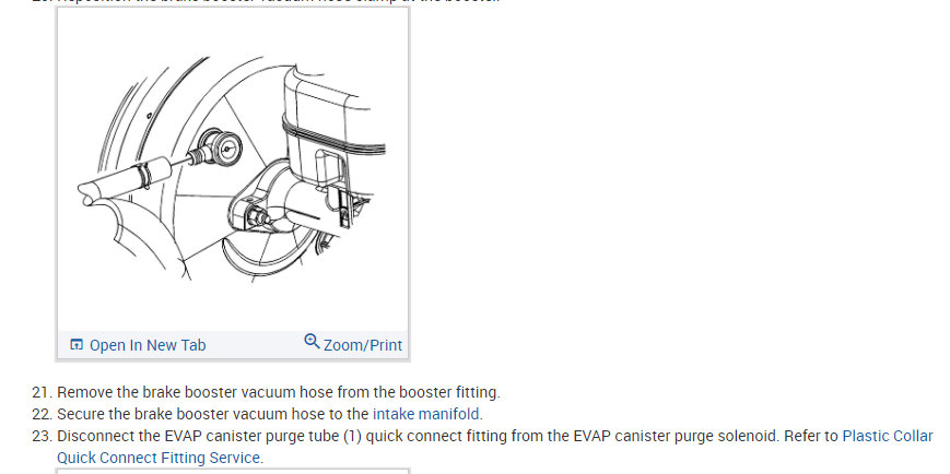

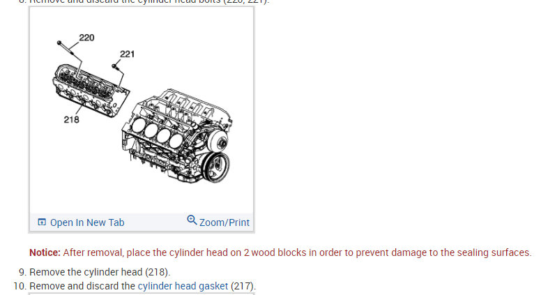

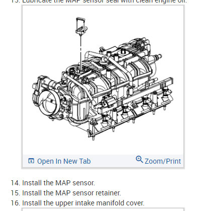

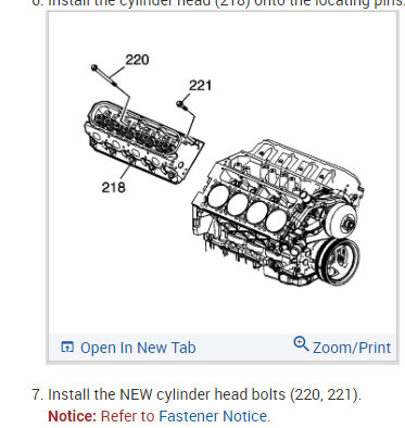

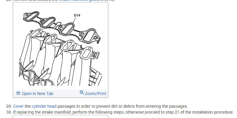

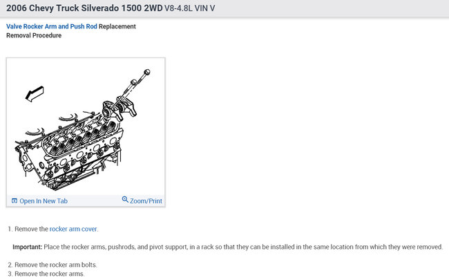

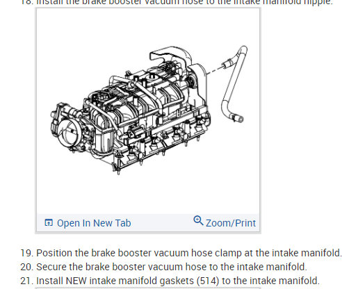

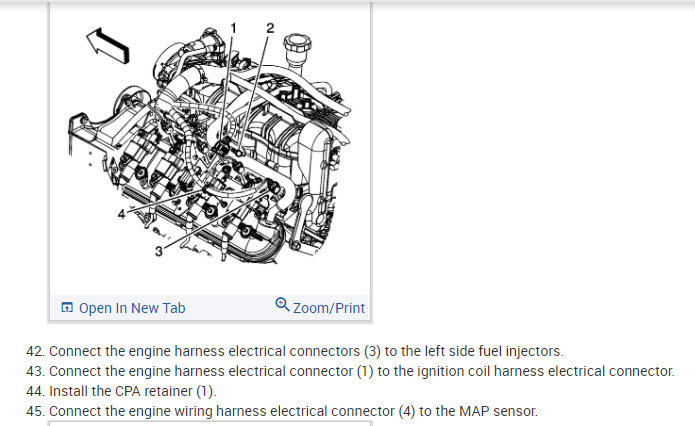

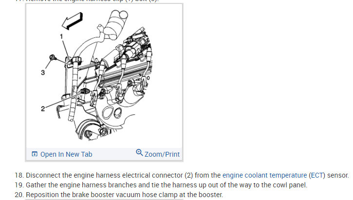

4.8 is same as a 5.3L. Here are diagrams below to show you the torque specs for the head, intake and rocker arms with a video to show you how to use a torque wrench correctly.
https://youtu.be/juOClONIWeY
Check out the diagrams (Below). Please let us know if you need anything else to get the problem fixed. Cheers
