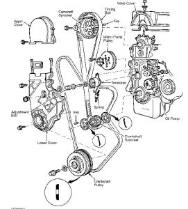

1. Disconnect the negative battery cable.
2. Turn the engine to align the timing marks and set cylinder No. 1 to TDC on the compression stroke. Once in this position, the engine must NOT be turned or disturbed.
3. Drain the engine coolant. Use a clean container and cap it when full. Wipe up spillage immediately.
4. Support the engine with a floor jack on the oil pan (use a cushion between the jack and pan). Tension the jack so that it is just supporting the engine but not lifting it.
Click image to see an enlarged viewFig. 7: Timing belt and components used on DOHC Prelude engines
Click image to see an enlarged viewFig. 8: Timing belt and components used on SOHC Prelude engines

14. Loosen, but do not remove, the adjusting bolt on the timing belt tensioner. Move the tensioner off the belt and retighten the bolt.
15. Use a piece of chalk or a marker to place an identifying arrow on the timing belt. The arrow can identify the direction of rotation or the outer edge of the belt. The belt must be reinstalled so it moves in the same direction. Carefully remove the belt from the pulleys without crimping it. Protect the belt from oil, coolant, etc. It's an even better idea to replace the belt at this point.
To install:
16. Double check the engine position; it must be at TDC for No. 1 cylinder. All of the following conditions must be met: The timing pointer is aligned with the white mark on the flywheel or flexplate, the UP mark on each camshaft pulley is at the top and the alignment marks on each cam pulley are aligned with the edges of the cylinder head.
On fuel injected engines, each of the camshafts may be held in the TDC position by inserting 5mm diameter punches into the alignment holes just behind each cam pulley.
17. If using the same timing belt, install it so that it rotates in the same direction as before. Remove the punches holding the cams if they were installed.
18. Loosen the tensioner adjusting bolt, and allow it to apply pressure to the belt.

can you get me instructions on how to change the timing belt
our car has 300 thousand killometers I understand when the timing belt goes the engin in history
thank you
Dale
Monday, January 11th, 2021 AT 5:28 PM (Merged)
SERVICE WRITER
  • 9,123 POSTS
Your going to want this
https://www.2carpros.com/forum/automotive_pictures/30961_1tb_1.jpg
