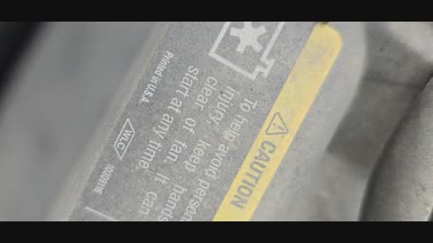

Have a ticking noise that comes and goes. Heard it really well on my way back from work this morning its a rapid ticking/tapping that slows and increases with vehicle speed. It'll do it upon start up and then go away after awhile other times like earlier it'll start after driving for awhile. If it's a lifter tick or exhaust leak how'd you go about finding out which it is. I'll try and get a video later today of it.

We need to determine if the noise is engine or driveline related, and when at speed put the vehicle in neutral to see if the noise changes with the engine or stays steady with the vehicle's speed. This will tell us which it is, yes, a video is much needed with noise problems. I can tell you this engine had problems with the cylinder deactivation system, not one of GM better designs. If the engine makes the noise at start up see if the noise is coming from the top or lower part of the engine, this can help confirm the camshaft/lifter failure.

It's definitely coming from the top sounds more from the top right/passenger side. I did put it in neutral at speed and noise changed with the engine rpm. If you still want a video I'll take one after work.

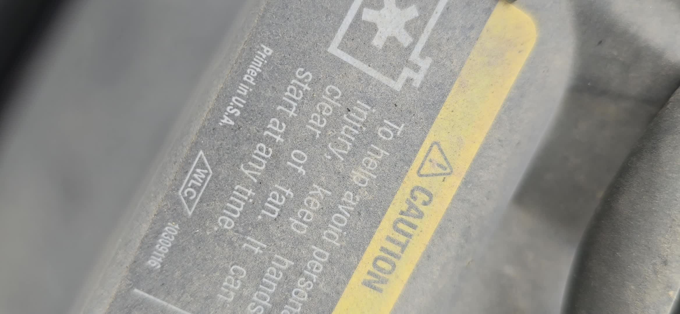

Here's the video it took a good 20 minutes or so of driving for it to start making the noise again.

Yep, that is a bummer, the camshaft and lifters will need be replaced, sorry, this is such a problem they make a OBD2 port dongle to stop the cylinder deactivation to stop this issue, thanks for the video though it helps. I would stop driving the car, you are putting metal throughout the engine.
